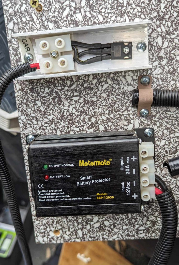

I am upgradiing from AGM to lithiiums. I have these currently installed but seeing as the lithium have battery management systems inbuilt I was wonderiing if these things are stilll required? Thoughts?

The top device is a diode, the paper tag appears to say car, possible to prevent voltage feedback. I would not use with new Lithium set up as long as suitable charging equipment is in place.
Looking at your photos I have no idea what the top one is but the battery protector lower in the photo is not connected anyway.
That is correct the LiFePo4 BMS should disconnect on low voltage to protect the battery.
Some BMSs do fail, so as a secondary measure you can always use it provided the voltage cut offs can be set at a higher voltage
than the BMS. It it appears they can.
https://www.master-instruments.com.au/products/63493/SBP-12060.html
