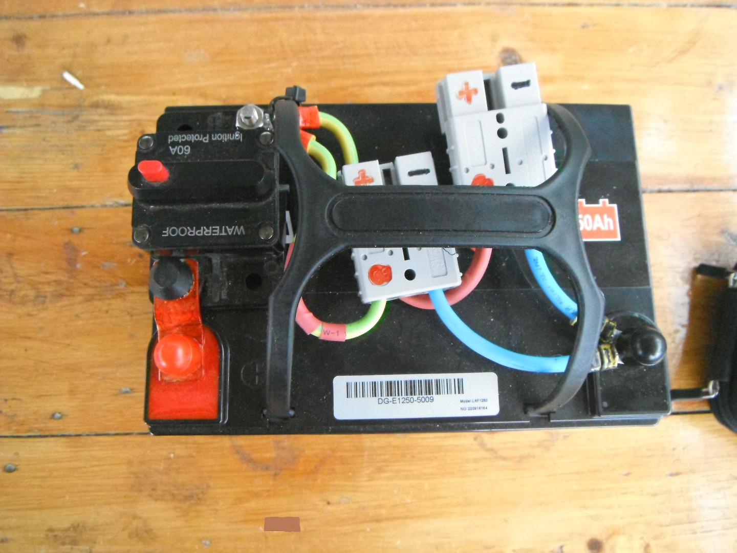

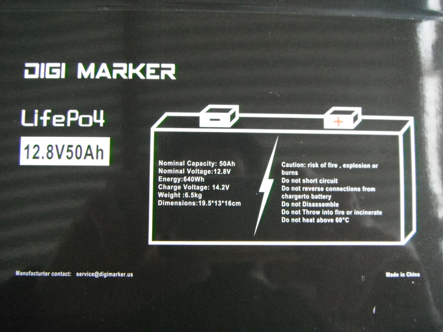

This is what i use on my kayak. 50Ah 12V battery 6.5Kg. It would only be good for the electric outboard.
-- Edited by DeBe on Thursday 23rd of November 2023 03:57:46 PM
