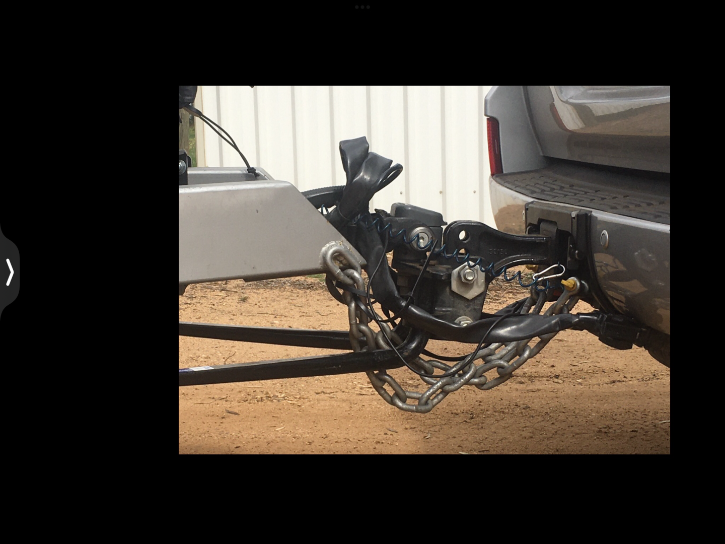

I have this problem and it often takes a couple of goes to get it right. In my case the slope is small (car wants to roll forwards), but the van is on almost level ground. After chocking the van it is difficult to position the vehicle with no load. What I found helps is to wind down the jockey wheel until it is just taking the drawbar weight. The shank will start to lift in the receiver but not to the point of lifting the car. Then wind another turn or so.
If the vehicle is positioned correctly the coupling will start to lift. Continue winding to disengage. If it does not disengage, there is a bit of pre-tension on the front of the coupling (vehicle pulling downhill) or the tongue (vehicle pushing back). Back in the car, jiggle a little forwards or backwards and listen for the clunk as the coupling lifts. Then wind it the rest of the way. An observer watching the coupling would help but I usually do mine without.
I have used ball hitches and DO35 and for me, the DO35 wins hands down. I've never had a problem hitching or unhitching with DO35 unlike with some ball hitches that I have experienced. With DO35 there are no adjustments needed and alignment is simple, easy and positive locking. Yes there are other types of hitches available, but I cannot comment on them because I have not used them. The DO35 I use came as standard with the off-road van I have and I am glad that that is the type of hitch fitted. If the OP was looking to improve his hitch, getting value for money is entirely his decision and seeking opinions from other hitch users is a good first step.
If you apply handbrake on the van and chock the wheels, then leave the chains attached to car. Leave the car in gear but don't apply the car handbrake, it leaves a little bit of movement when you raise the jockey wheel and the hitch usually comes free easier.
On flat ground, you can leave the car in neutral, as long as the van is secure the car won't go anywhere.
Well worth it and has given me options
Thanks again
Ronzo
A little trick that I learned from a fellow traveller works well for me. When I start turning the handle on the jockey wheel and see that the hitch is not disengaging I wind the jockey wheel back down and then get into the car, disengage the handbrake and place in neutral and then start the engine. The small vibration seems to take the pressure off the ball and voila, the hitch raises free at the next attempt.
Works every time and no need to bounce about on the tow bar trying to get the ****** to disengage.
Did you mean wind the jockey wheel back up? (so that the coupling is taking all the weight again).
However, Ronzo's question was about the difficulty of disconnecting on a slope. I find loading the coupling by the car either pushing or pulling is what needs to be avoided.
