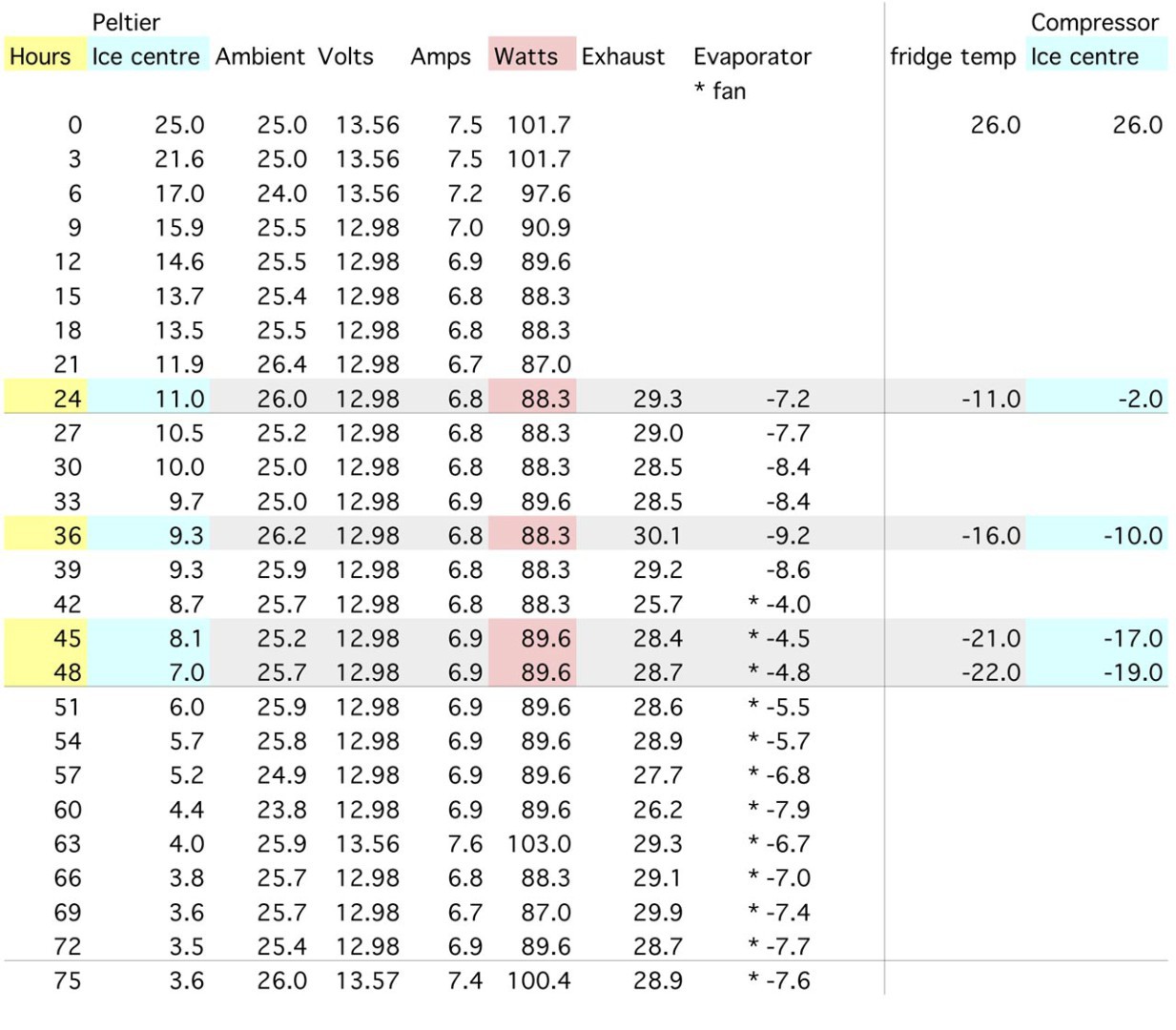

07:45 AM Nov 11, 2023
The thermostat may not be working if you can't set the temperature to within 2°C over a 24 hour cycle.
I don't have a 3 way fridge, but my feeling is that a 3 way has the performance of a peltier, about a 1/10 of a compressor fridge.
A compressor fridge at its coldest point of the evaporator plate on my baby 28L Waeco fridge gets down to -26°C.
But a compressor fridge is capable of 48°C below ambient temperature. So if 40°C it is still -8°C (probably your freezer is on average far lower, if you have reasonable thermal mass, from overnight refrigeration)
Again, if you have a DC-DC converter near the battery / fridge setup. The fridge will perform better. Great for those Pilbara situations.
(Chart is freezing 10.5 litres of water, Peltier vs compressor refrigeration)
