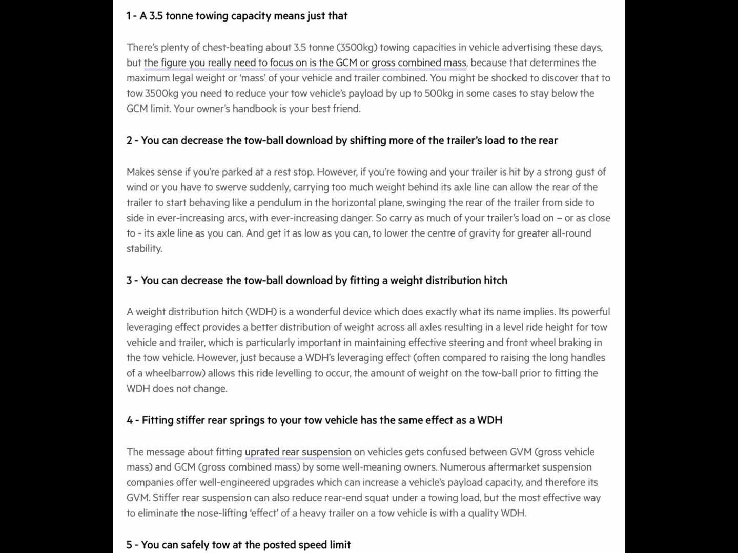

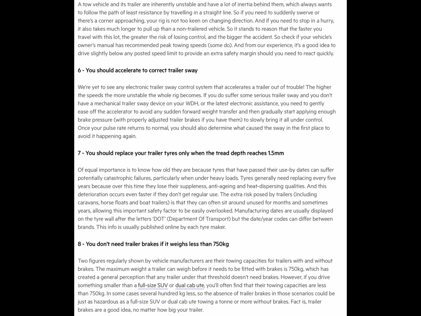

Interesting video Graham, and will be of some assistance to new members, or indeed, those members who simply are wanting to learn.
However, I feel that members of the "head in the sand" brigade will be lost, as always.
Airbags are a regularly misunderstood piece of equipment, and you can be sure that salesmen never will reveal the inadequacies to those among us who believe that an Airbag helps with weight distribution. It doesn't.
The last point, regarding inadequate tow vehicles, is particularly relevant here in Australia, where dreamers set out to tow 3500kg vans with their little 6000kg GCM twin-cabs Buzz Boxes, among other equally unsuitable vehicles.
Could I say that there is another, more informative, "8 towing myths", in print somewhere, some of which I posted a couple of years ago. However, I do not have it at hand.
Perhaps someone else can help?
Good post though.
P.S Didn't find what I was looking for, but " top towing myths" produced the points below.
Lots of good advice for those receptive to same, so the "head in the sand" brigade may like to move on?

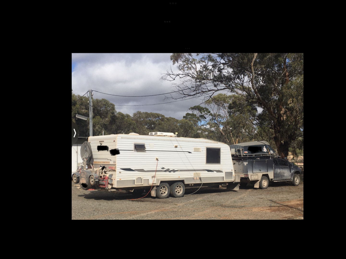

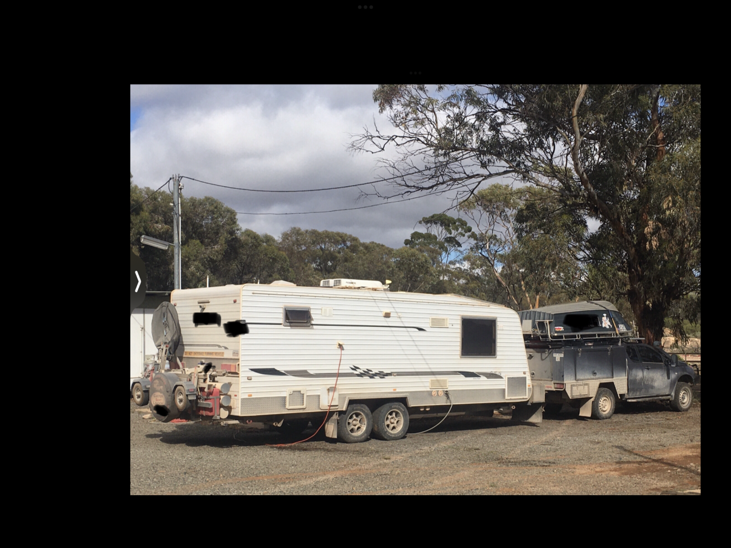

P.P.S Dreamer's wagon at bottom, no apparent understanding of weights?
Looks to me that chassis is bent, just behind cab?
