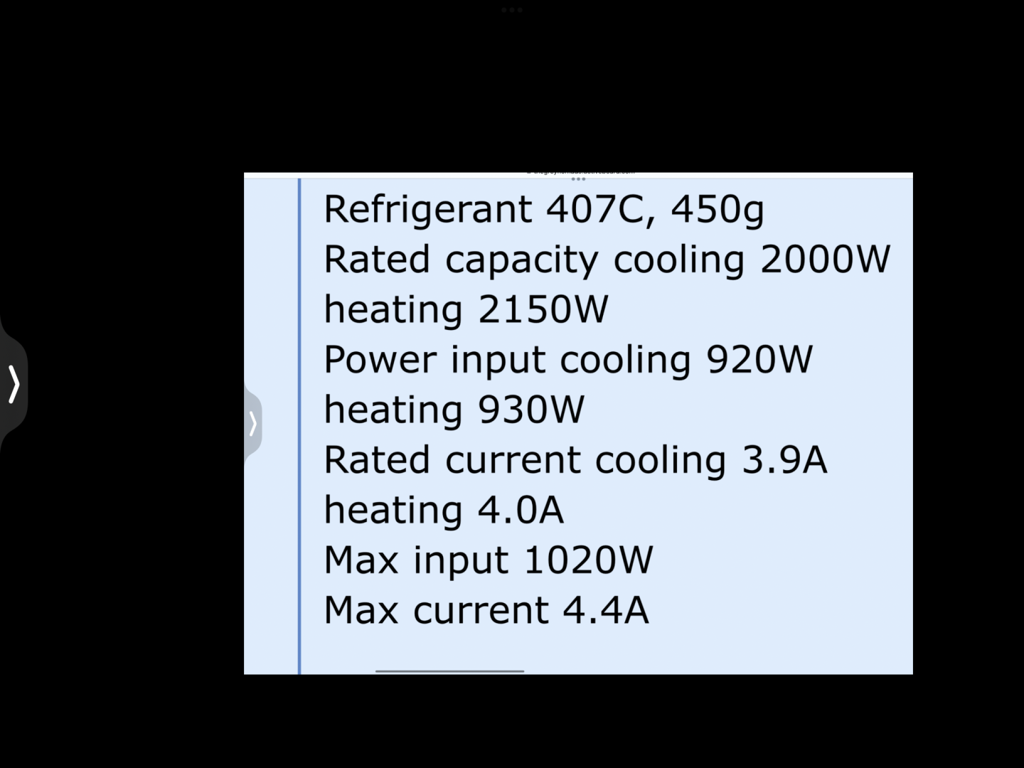

Refrigerant 407C, 450g Rated capacity cooling 2000W heating 2150W Power input cooling 920W heating 930W Rated current cooling 3.9A heating 4.0A Max input 1020W Max current 4.4A

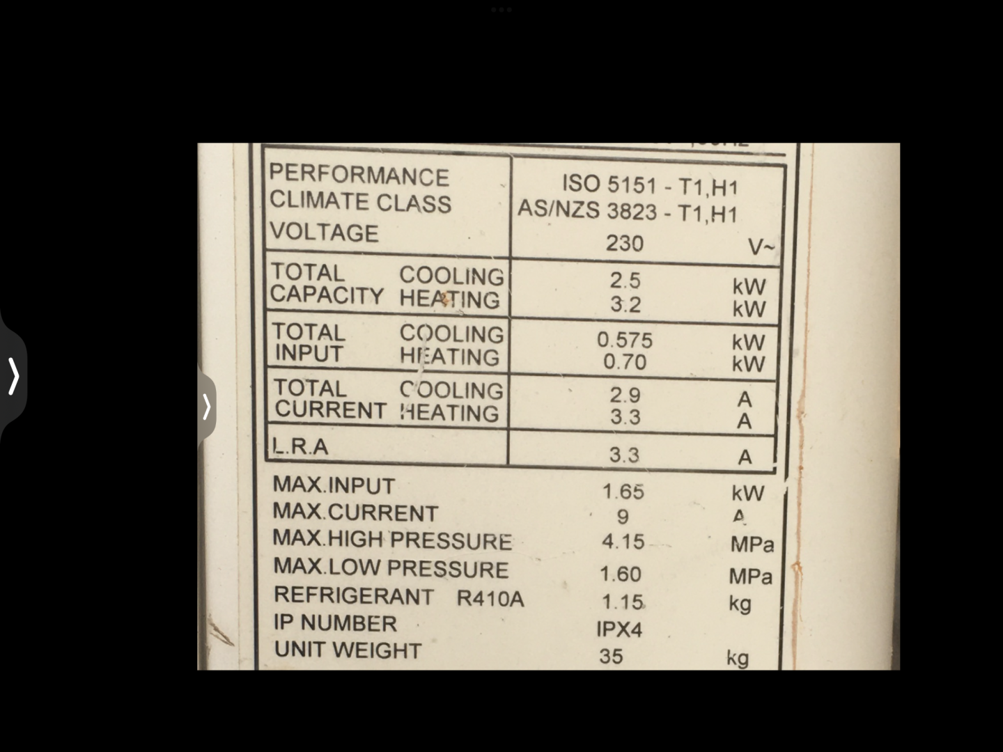

This is the 2.5kW Daikin I installed in 2014. Current models are more efficient (also a 5.0kW unit in 2010 I installed).

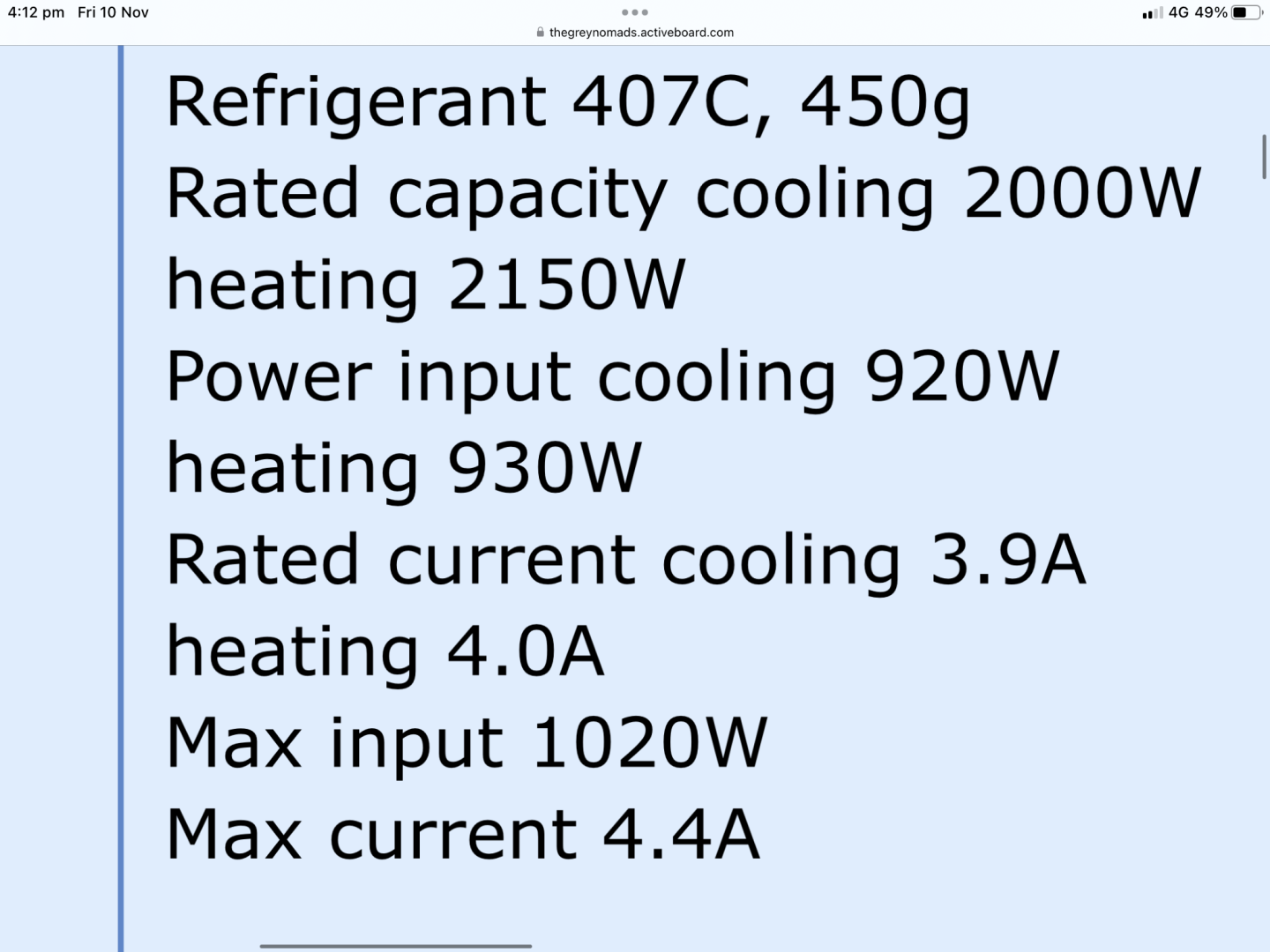

heating 2150W
heating 930W
heating 4.0A
Max input 1020W
Max current 4.4A
https://www.caravansplus.com.au/pdf/sparrow-mk4-manual.pdf
-- Edited by BarneyBDB on Friday 10th of November 2023 05:54:54 PM

Anyway, to make it easy to compare with MHI 2.5kw here are respective figures. Cheers
My neighbour put in a Mitsubishi AC in August. It's not as efficient as the 2.5kW model.
The thing that impressed my neighbour & me was just how quiet the thing is. Both inside & outside units.
