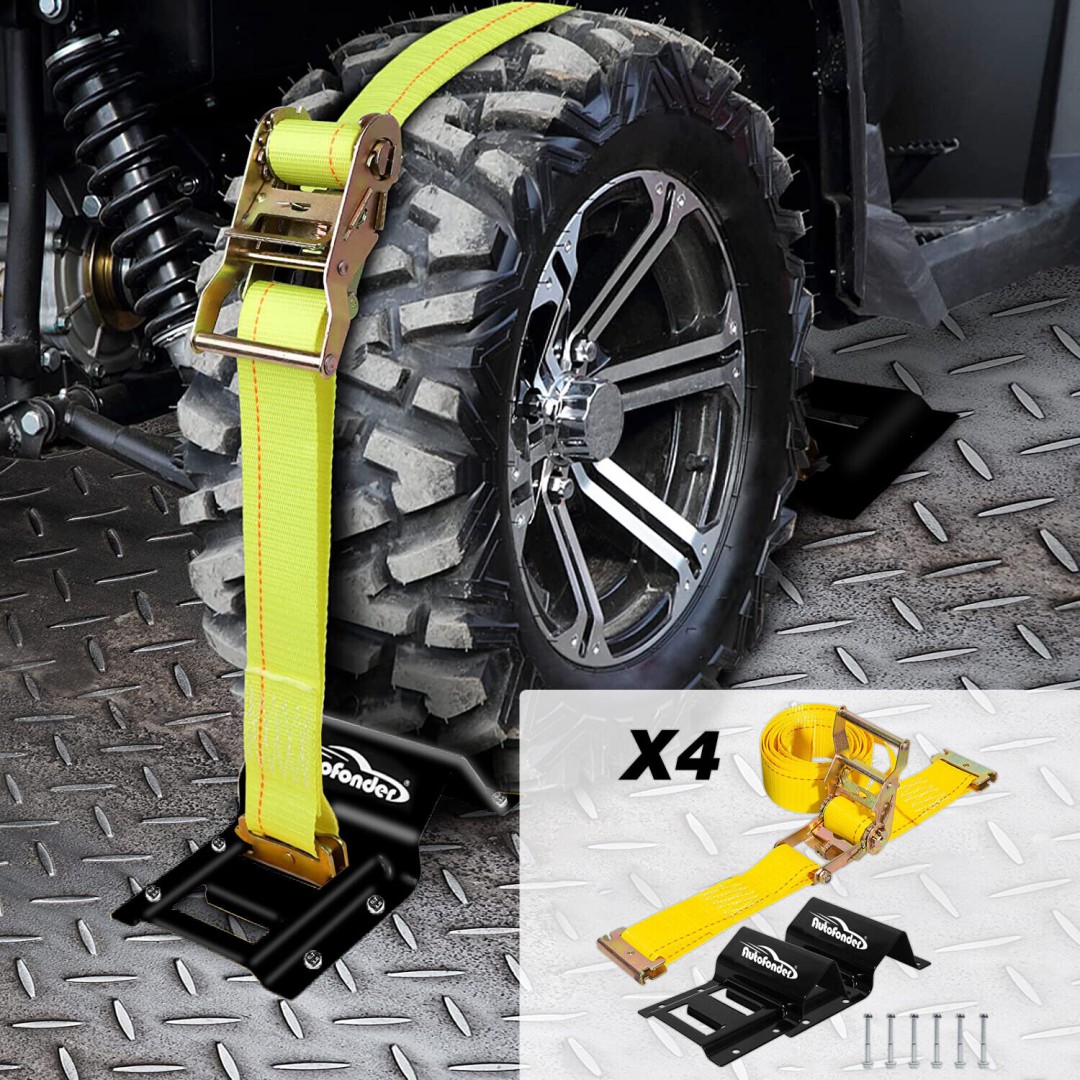

In my case I purchased 8x 200mm coach bolts and welded them to make them 350mm long. Using the battery drill into the ground and I use heavy duty trailer straps around the chassis. Pictured is a method to tie down the wheels which I imagine would be preferable as the van body would rock in the wind.

I am not so sure that strong chain and turnbuckles is a good idea. If the wind is shaking the van you want some elasticity in the restraints to reduce jerking at the attachment and tiedown points. If there is no stretch the sudden jerks will be more likely to break things and pull out the ground attachments.
In boats, nylon is regarded as the best choice for the anchor line because its stretch capabilities reduce the jerking.
I can imagine the weakest point would be the attachment on the van. For the wheel tiedowns, pegs at different angles would help. But with the wheels secured, the suspension will allow movement of the body. Back to the first point.
