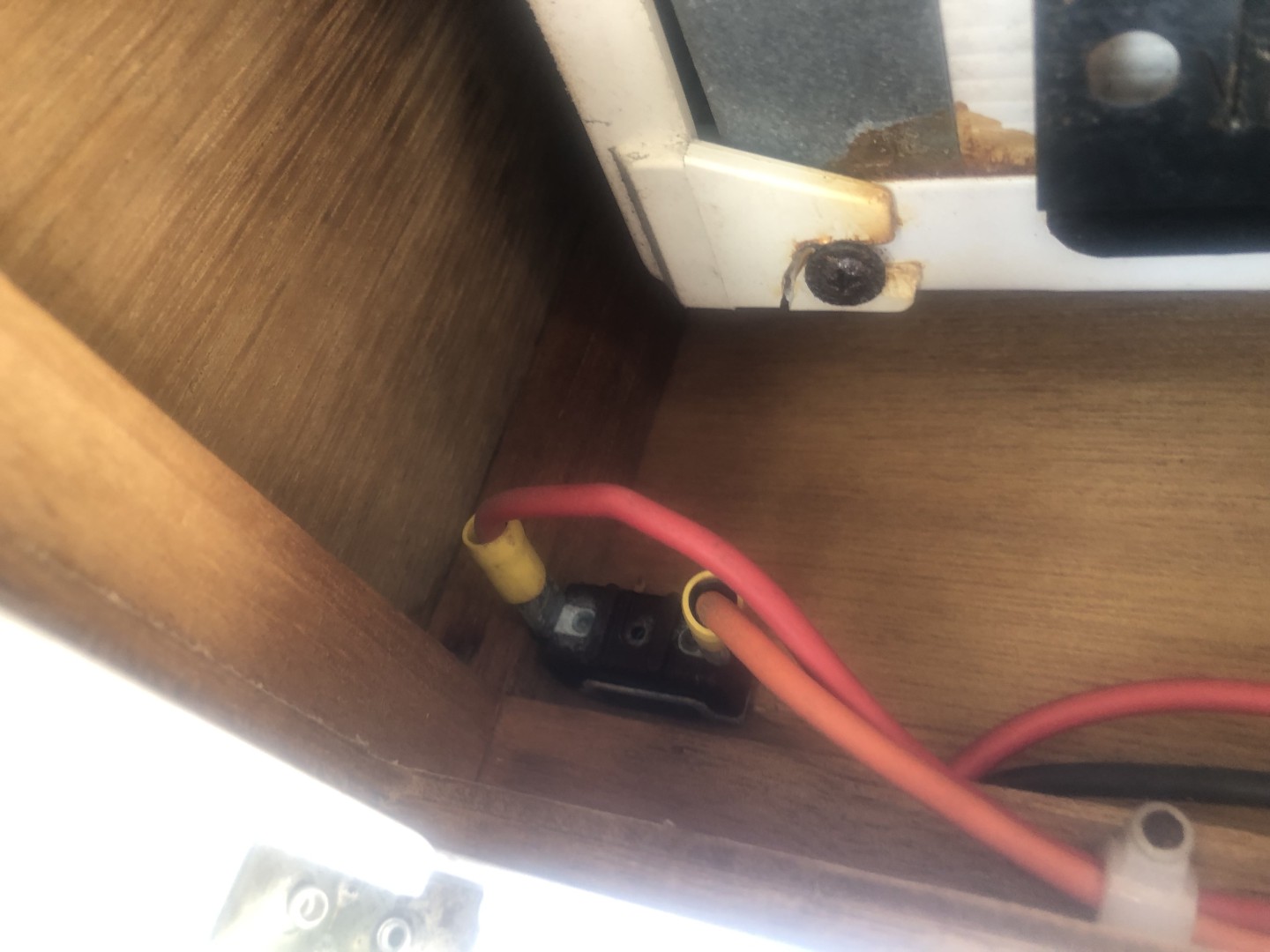

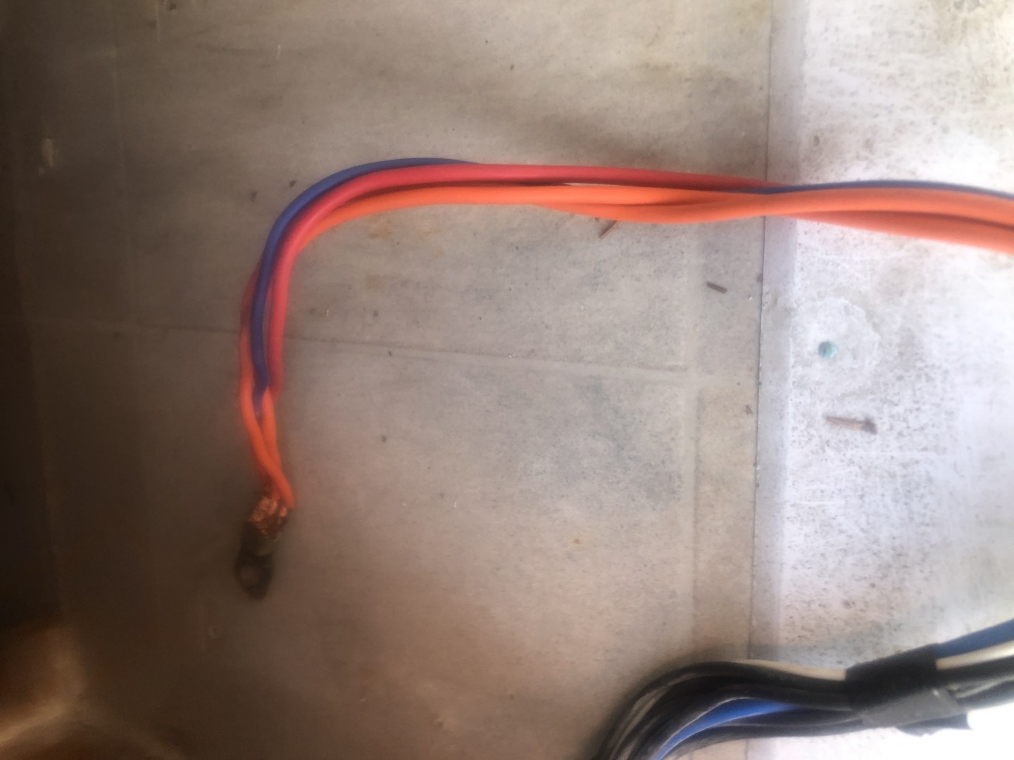

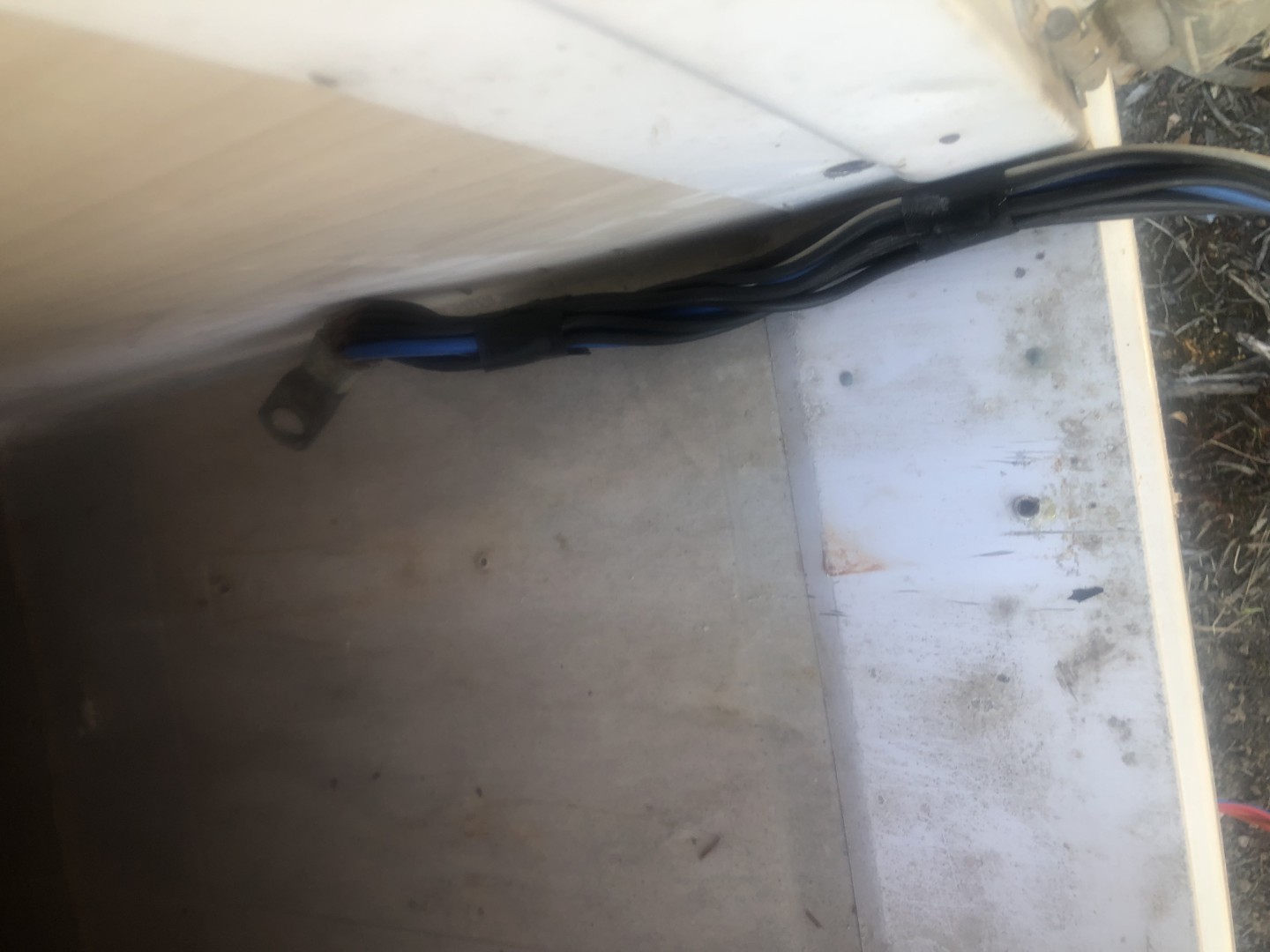

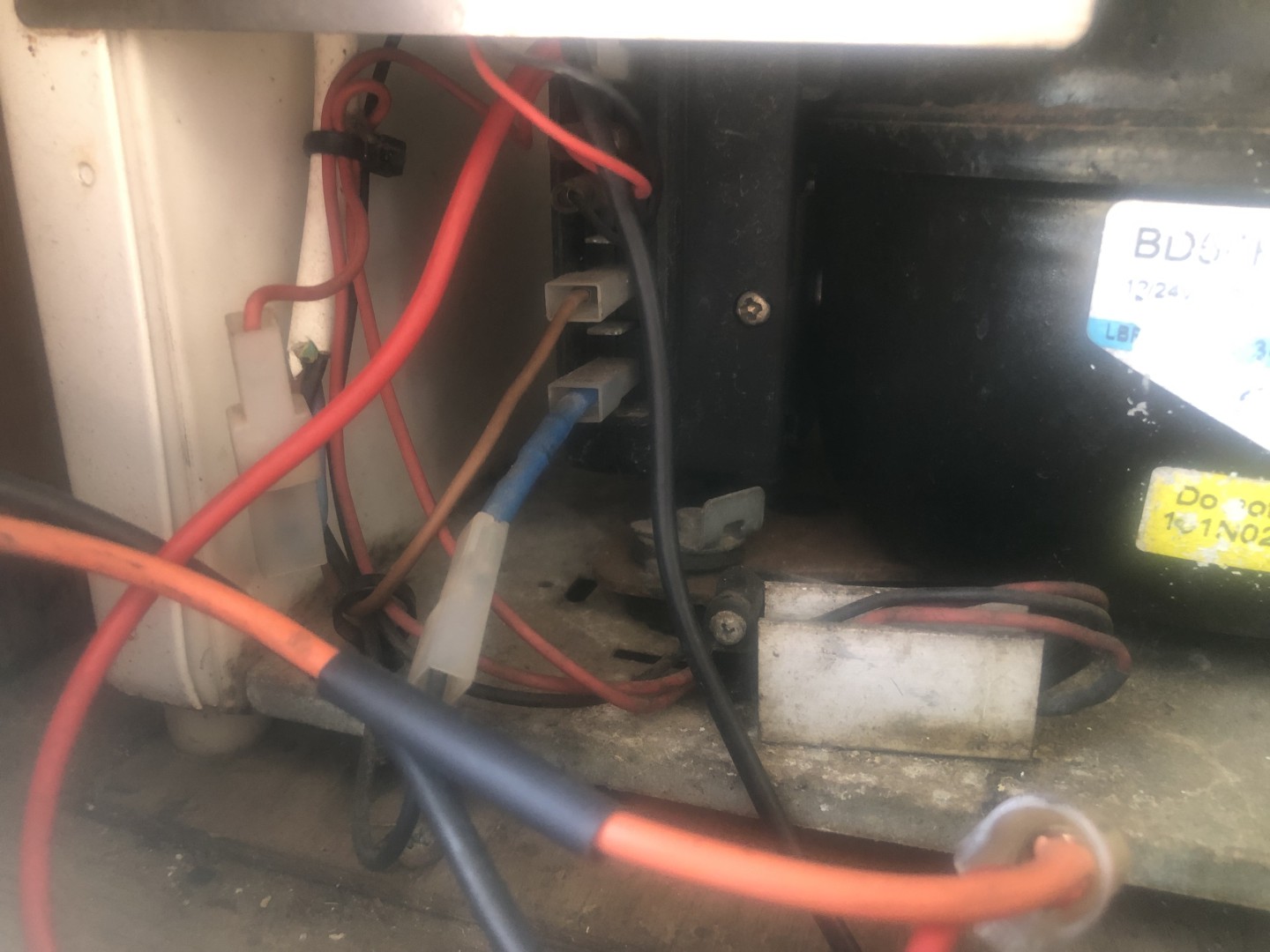

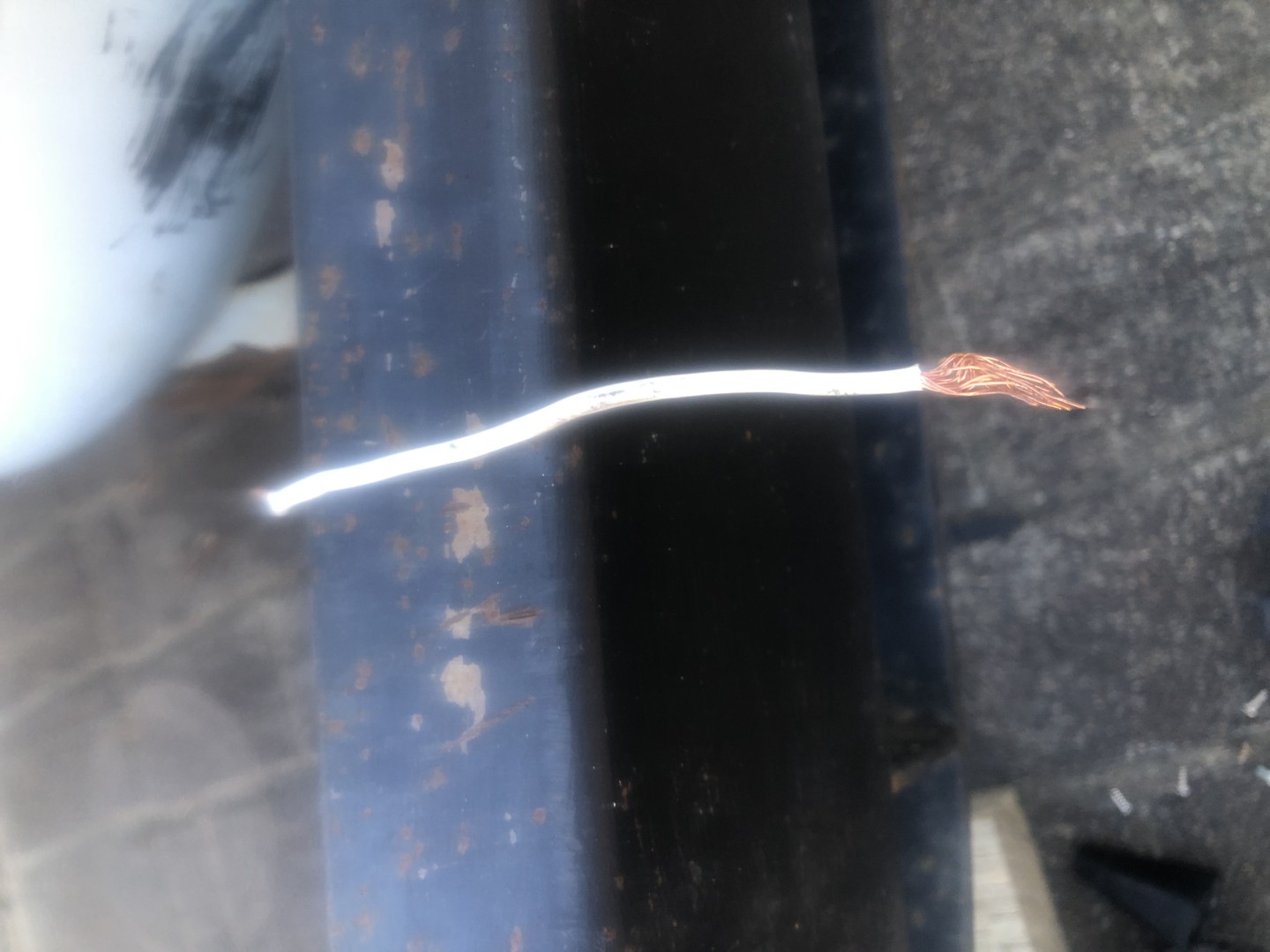

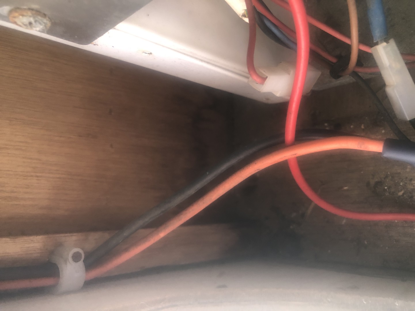

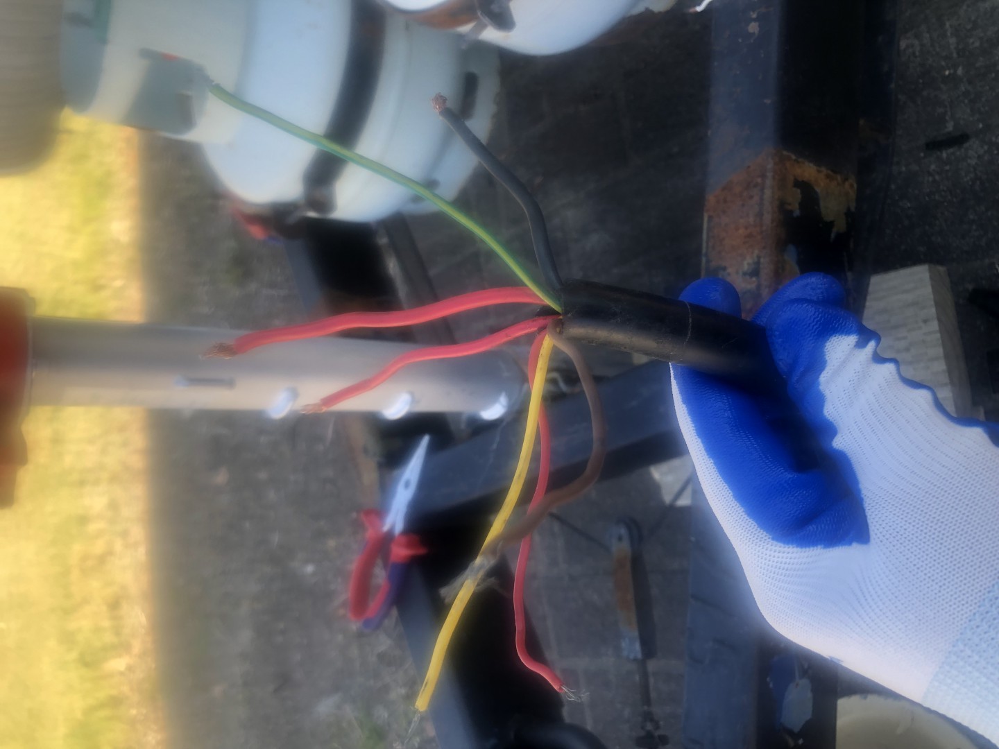

I am trying to work out what wiring I have or dont have in my van. I looked at the 12 pin plug and discovered it didnt have the same co wiring as per the colour code. Also, there was no earth wire in the loom except for a white wire that went from earth 3 to earth 10.
Also the 2 additional red wires were joined together and joined to battery supply 8. Not sure why this is the case but it looks like the higher guage red is the same as the what is at the back of the fridge. Also, wondering why the wiring loom has been split to connect to the house battery. I have also attached a few photos of back of my fridge.
As per my previous post, any advice would greatly be welcomed and appreciate.

It was common years ago for no earth wire back to the tow, the earth being made by the tow ball and the various points within the van being earthed to the chassis.... not ideal but usually ok for a few years.
