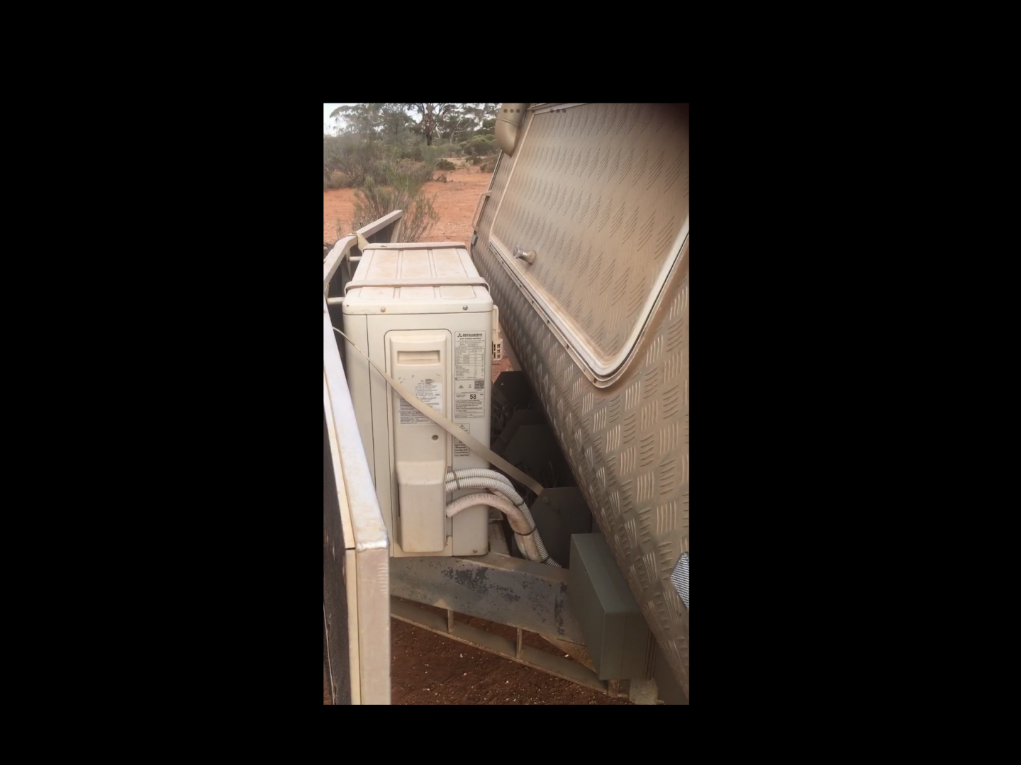

You beat me to it Jonathan. My 2.5kw Mitsubishi sits on the drawbar, with the outlet on the wall inside, so no weight on roof.
When it's 45 degrees all day you'll be glad that you did it properly. Was $700 at Good Guys. Cheers

Reverse cycle A/C weigh around 35kg. Bit heavy for a poptop roof.
Hi Tony, Had you actually read my post you'd have seen that the AC unit is on the drawbar, while the outlet unit is on a wall inside.
NO weight on roof, and believe me, when it's 45 degrees you'll be so glad that you have it! Still 34 degrees out here in the bush, but I've conditioned myself, and have not turned it on today. For a miserable $700 it's a no-brainer. Cheers

Inside unit is 9.5kg.
Outside unit is 35kg.
In comparison a wheel for my Land Rover Freelander is 30kg.

Re: poptop, I was actually responding to post 2 from Deverall. Anyway, looking at your drawbar, thats a nice solid ladder brace there.

Yeah, when I raised the van so that I now have 700mm clearance I added that brace and couple of other bits and pieces.
Also fitted EFS XTR heavy duty shocks since I run 3150kg GTM and had busted a set of springs on the Sutor Development road.
Springs now have 2 extra leaves. Since I tend to push-along on dirt I figured that I'd do it properly.
Replaced original 15" van wheels with same wheels as I have on the car (16") so I now run new tyres on the car and swap the part-worn tyres to the van. Because the drive axle wears tyres more quickly than the steer I put the steer tyres on rear axle of van to minimise the effects of the van pivoting on the front axle, which I run at lower pressure than the rear axle. (Non- loadsharing suspension).
Lots of other stuff, but maybe another time. Cheers
