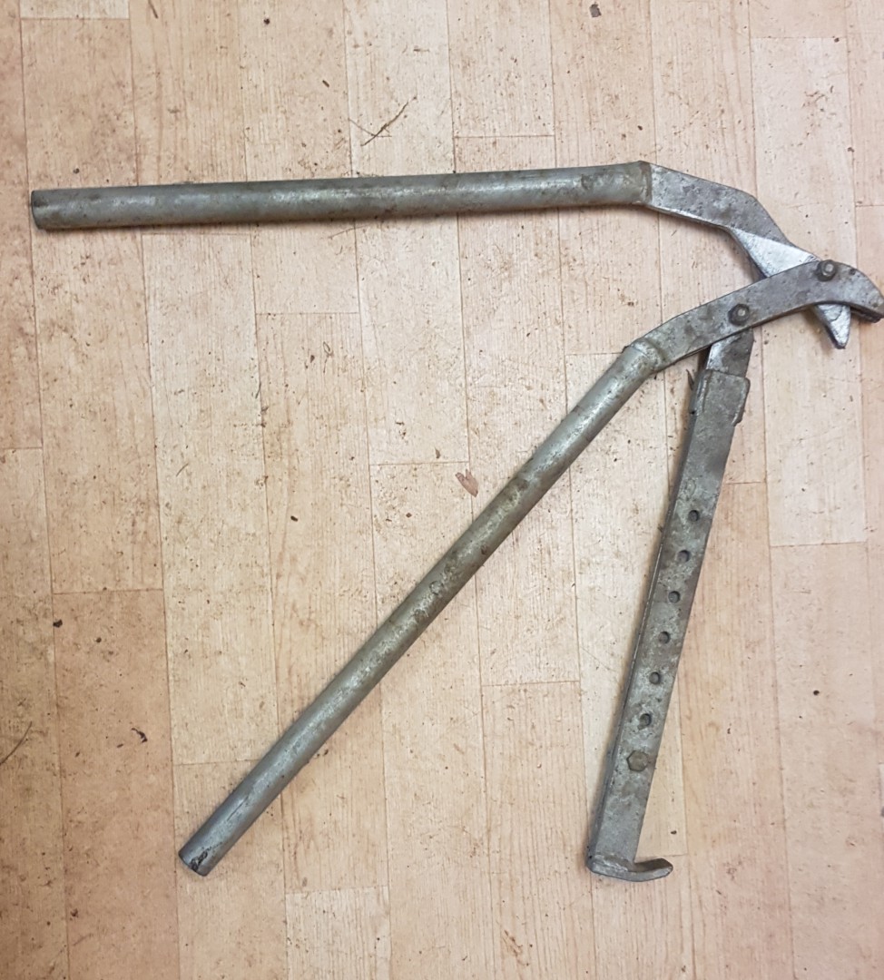

Can anybody help identify this piece of equipment that is on display in a WA small town museum?
The old chap who volunteers at the museum says that he's been trying for years to identify it.
The handles are about 18 (450mm) long and one appears to be adjustable in length, but there is a strange hook on the end of the part that is removable.
I have a tool (a bit more modern) but similar, a "simple" Bead Breaker for removing a tyre from a rim. The tool pictured is similar but even more simple than mine. Drive the beaks between the tyre and rim and then open the handles out and hold the handles open, the third arm is used to locate one handle on the wheel via a small hook, which then lets the operator apply pressure on the other handle to break the bead.. Earlier tyres were much easier to remove - no bead retaining hump. That's my guess anyway.

I am only guessing, but how about a tool to cut the tail of fencing wire or similar. The long handles and short jaws would give a lot of leverage, but the wire would tend to slip out of the jaws. So, to prevent that pull the tail of the wire through the hook and that will stop the slipping.
Fantastic explanation Kerry, and the Old Boy (he's 86) will be rapt! In fact I'll return to that little town and show him your detailed response. Thanks again. Cheers
Thanks Stephen, for your suggestion which I will present to the Old Boy when I go back there. Cheers

I think it is an early model WDH probably off a Cobb and Co coach.

Now that I see KJB's photo I believe that is the winner. It also shows the jaws are not designed for cutting which I thought they were from yours.

I have one that I made at HI mines Paraburdoo as a Trade Assistant, and it most definitely is a bead breaker.
