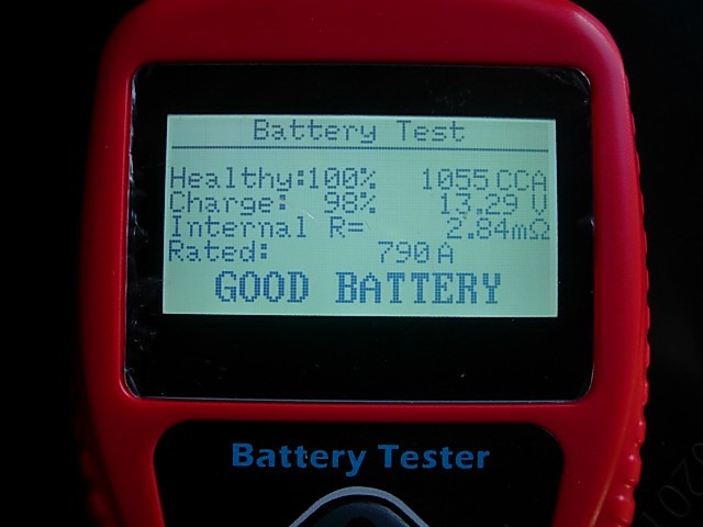

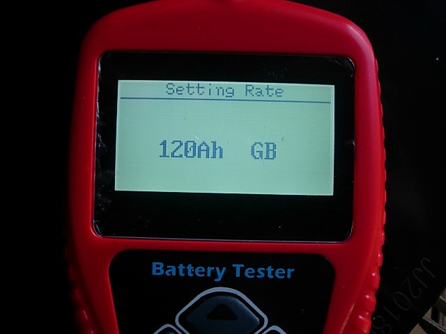

I use one of these battery testers. I test the AGM battery when new & fully charged & note the readings. Then over time i check how its going, mainly the internal resistance seems to increase with age.
Ian195 that's a good reply, I may work on that. I did also give Battery world a call, they said they could test it, it takes two days, and would cost about $30. I do like the fact you quoted voltages, I wondered what the cut-off voltage would be, to calculate the AH rating. I will work on that.

I have one of these.
https://www.aliexpress.com/item/1005005080837439.html?pdp_npi=2%40dis%21AUD%21AU%2427.12%21AU%2420.61%21%21%21%21%21%402103011516910615497725452e52be%2112000031568123967%21btf&_t=pvid:a72708e3-da6e-4191-b1e4-960d0481f8a1&afTraceInfo=1005005080837439__pc__pcBridgePPC__xxxxxx__1691061550&spm=a2g0o.ppclist.product.mainProduct
