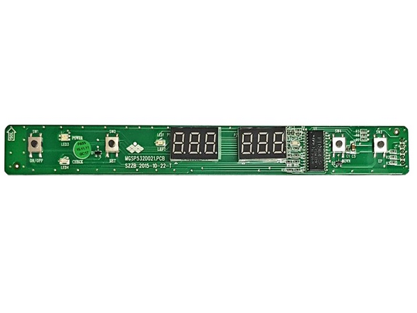

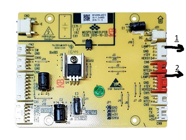

I will make a start. To get into the top PCB you aparently have to remove the Membrane to get acess. The main PCB picture i have marked where aparently the 2 lamps are fed power. Pictures are from Allvolts power solutions & they sell the parts in the pictures. Would be interesting to see whats on the other side of the Main PCB. Sugest you start following the apropriate wiring. Or take it to a dealer/repairer.

thank you for this,
Am definitely capable of a wire trace and repair myself - was just a 'hail mary' hoping someone would say, oh i did this last week, access x.
your pictures give me a perfect starting point.
Thank you.
Hi Brains Trust,
For anyone interested i have solved the problem -
Found a broken wire pulled out of a plug in the switch loom, have bypassed the plug and all is working properly.
Thank you Debe for showing me which loom to trace!
