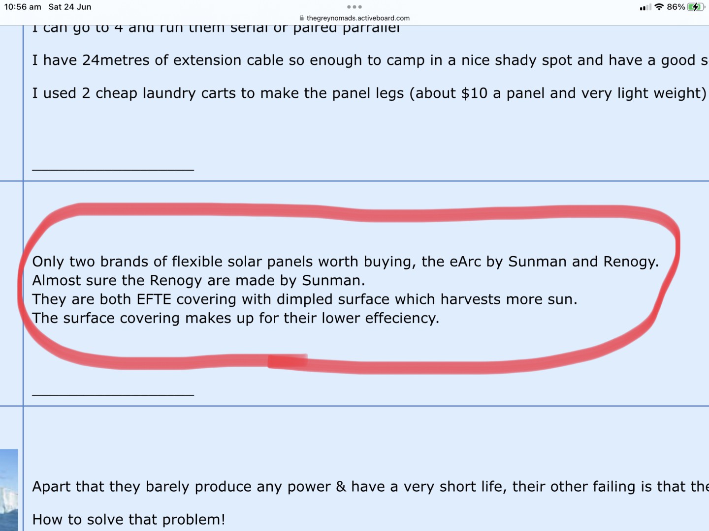

If the OP looks at reviews of this panel he will likely see that many people have been disappointed with its performance.
Solar blankets are useless, IMO, when compared with panels.
On my car I have several Kings products, and most have performed beyond expectations.
Any problems have seen the product replaced without question, but when it comes to electronics (?) it is unrealistic to expect El Cheapo products to perform at the same level as Good Stuff. Cheers

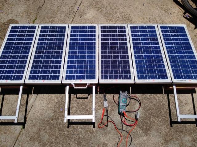

When i want some portable solar I have used a couple of solid panels wired together with a decent cable to a controller near the battery. I have used several 70-80 watt panels in the past, which are easily handled and stored. Cheaper too ! Recently I set up a pair of second hand 50W panels in series for 24V to be used for charging a mobility scooter, with a PWM controller. If the panels have separate plugs they can be easily assembled and moved and stored etc.
If you use one big panel it is heavy to handle, ackward to move around and difficult to store anywhere.

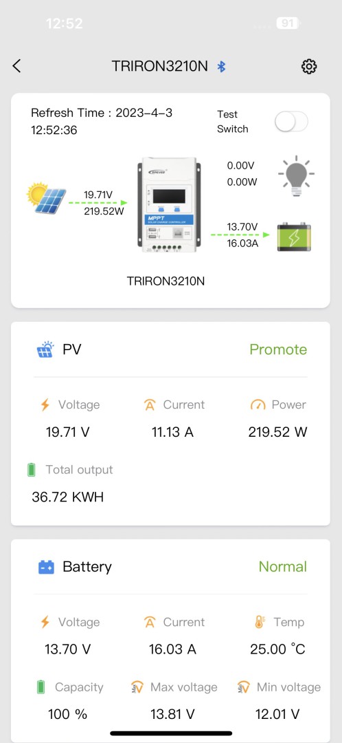

aastek, like you i was recently contemplating a solar blanket to supplement my roof solar. After reading of the failures of both the low and high end solar blankets I gave the idea away. My son has an Ecoflow 160W and whilst a nice blanket and very good quality I just do not see that it is good value. Battery World have the Ecoflow 9.5 kg 220W on special for $599 and so do a few other places. Paying more money may get you better quality panels that will last longer but does not mean you will get the full output stated.
I?m more than happy with the output of my 11kg 200W Exotronic suitcase style panel although the catches could have been better. If ppl think they are too heavy then it is easy to seperate them as two panels with their own connectors. The other alternative is as Jaahn suggested buying seperate panels but I liked the fact that the Exotronic panels have Trina cells.
This is the best output I achieved in probably ideal conditions.
Just remember, that even if there is a clear blue sky there are many atmospheric conditions that the naked eye cant see that will affect the output.
Good luck in what ever way you go.
Tim
-- Edited by TimTim on Sunday 25th of June 2023 09:52:16 PM
I?m more than happy with the output of my 11kg 200W Exotronic suitcase style panel ...
Input = 19.71V x 11.13A = 219.37W
Output = 16.03V x 13.70A = 219.61W
That's better than 100% efficiency.

"I'm more than happy with the output", is the technical terminology for what is actually going into the batteries.
I think 'happy' has the same meaning as actual figures!
A bit like my 120 watt set up with typically 9 amps going into the batteries with a midday setup in bulk charge & up to 11.2 amps with water cooling the panels. With that I'm "happy"

I would expect that the efficiency of the regulator would be 90 - 95%, or am I being too conservative? It seems to me that something is not right, but what? Even if the meter were wildly inaccurate, I would still expect it to be proportionately so. In other words, if all the voltage and current readings are in error by 10%, then the actual input power would differ from the real input power by 21%, and the actual output power would differ from the real output power by 21%.
06:38 AM Jun 27, 2023
I haven't seen one figure whether good or bad for what is going into the batteries with kings panels. I take it people couldn't be stuffed measuring anything these days. Which is surprising with all the cheap tools available.
I could say I am happy with the fuel economy of my car. But the comment is less useful than a dog's landmine!
Do people stilll actually measure anything these days? Even with a cheap meter there would be some tangible statement.
"I am happy with ..." Please bury it like cat! It's a waste of everyone's time.

A friend of mine had several Kings products used on her MH and in my opinion none of them were of good quality and underperformed. Eventually all were replaced by other better items. So I agree with the others who said they are good marketers !

You can always buy 2 panels, add some hinges & latches to hake your own setup, even to suit the space you have available.
I only had a small space so used six small panel.
That is being a bit unfair and pedantic ! Close enough is OK in this situation.
The problem IMHO is the silly accuracy that these metering devices pretend to have and then use in the read out. They are not precision meters and should not pretend to be so !
But keeps the punters happy for sure !! I would venture to say that the all the figures shown are not accurate to 4 significant figures and probably less than 3 if the system was analysed. But do not let the facts get in the way of good story.
Jaahn
-- Edited by Jaahn on Monday 26th of June 2023 04:09:26 PM
