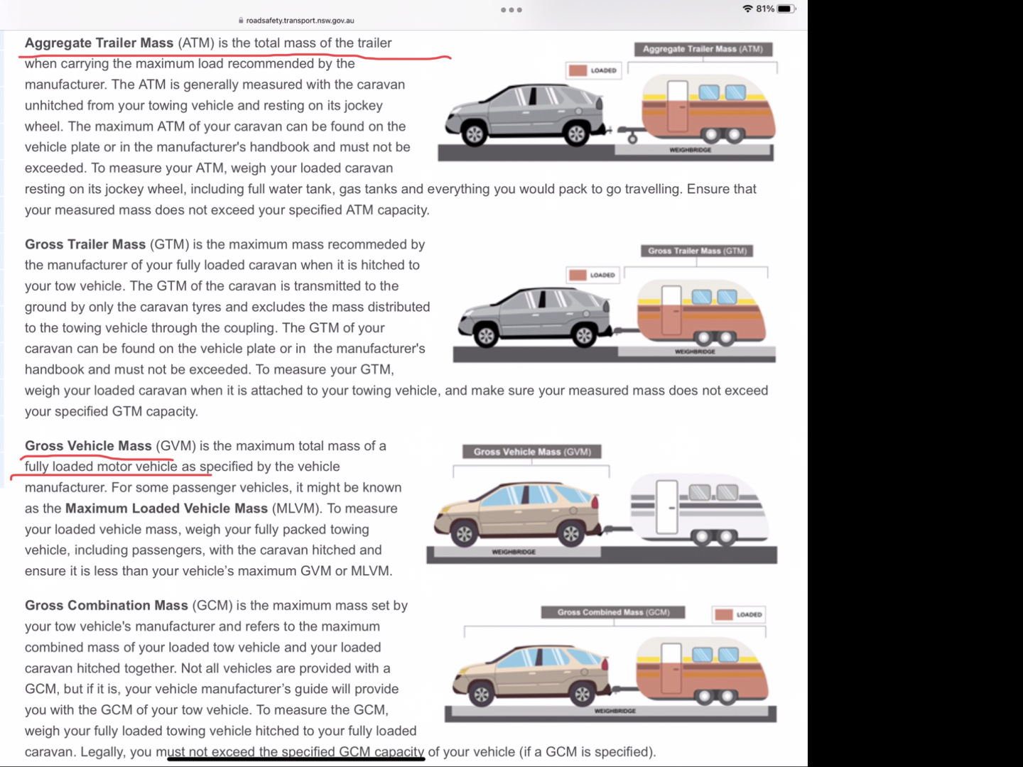

Hi Ric. Briefly, ATM applies to towed vehicles, while GVM is used for motorised vehicles. Sometimes the term "GVM" is misused in the caravan industry.Details tomorrow, if I get time. Cheers

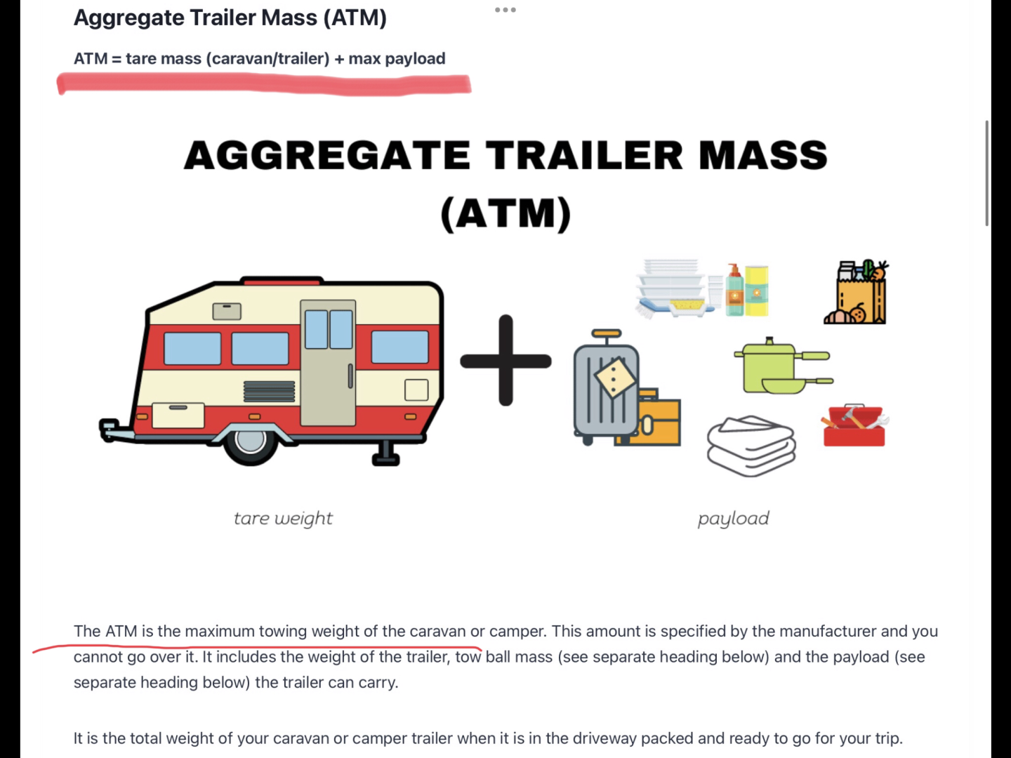

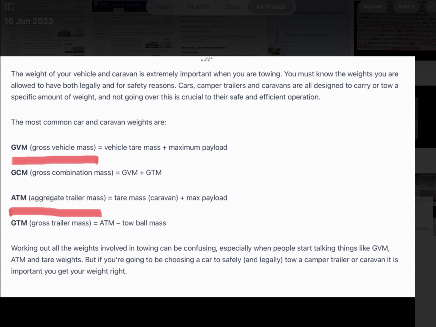

As posted earlier, some caravan manufacturers use the term GVM in reference to their vans, but GVM applies to motorised vehicles in this situation, and ATM is the term used in reference to towed vehicles. (Caravans) Cheers.
P.S As can be seen, the first photo is from NSW Govt website.
