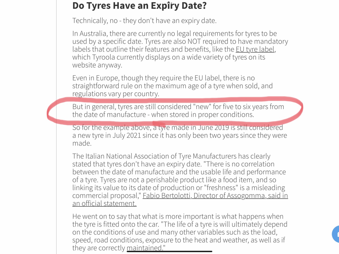

Since tyres are relatively inexpensive, and we are talking safety here, Id replace them without further ado. However, you are likely to get dozens of opinions and reports of personal experience. Could I suggest that you Google "Life of unused new tyres" and read reports. There are pages of them, but I have screen-shot a couple of pieces of "advice" for your perusal.
Good luck with answers to your question, but for the sake of spending a couple of miserable dollars you could be saving your van, yourself and others from damage. Cheers

I don't totally agree with the article that yobarr posted.

As far as I know there is no gazetted law on Tyres but having changed tyres on a boat trailer with infrequent use at 10 years it is a good idea to keep an eye on those that aren't used as much over a longer period of time.
So if your using said Van frequently keep doing so until you or your tyre bloke tells you it's time.
Yobarrs article is just someone else's opinion (which if you read it contradicts itself) just use your common sense.
