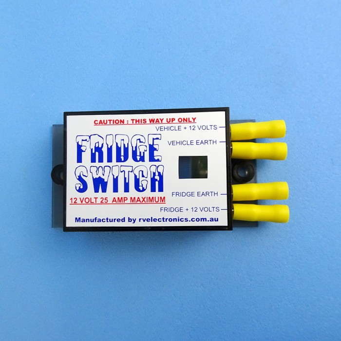

As 3-way fridges pull about 16A at 12v, and then there's charging your battery as well, you could easily be up to 30-40A on the one cable so I'd recommend 16mm2 wiring between car battery and caravan.
And as 7-pin and even the larger contacts on a 12-pin can't handle that wire size or current flow you should use a 50A Anderson plug as others have suggested.
Otherwise, running the fridge off your van battery is a reasonable alternative but I'd still suggest 10mm2 wiring between battery and fridge as volt drop is the most common cause of 3-way fridges under-performing on 12v.
Then add either a 'fridge switch' or ignition triggered relay to disconnect the fridge when there's no charge source available, otherwise it's a great way to run your batteries flat while you stop for a long lunch!

PS, Ill also look into the switch attachment.
