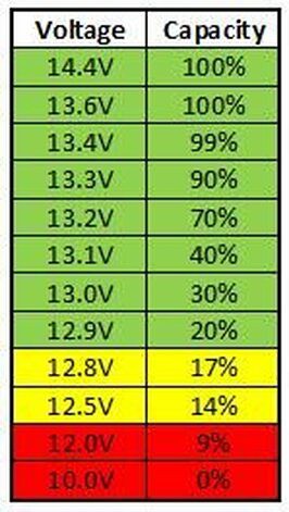

Just remember it is difficult to determine the state of charge as the charge and discharge curves are very flat until they reach what we call the knee where the voltage climbs and falls very quickly. At rest a fully charged battery will sit at 13.4V to 13.6V.

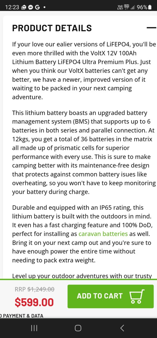

I am looking at using this battery as a replacement for my old AGM setup.
I would be reluctant to install a Lithium battery that is not recommended for parallel or serial connection.
Quote:
"IMPORTANT: While our LiFePO4 batteries are top-notch & can be wired with other batteries of its kind, it is not advisable to connect any LiFePO4 batteries in parallel or series. This poses several risks and should only be done in emergency situations. If you must wire batteries together, make sure you are familiar with the correct procedure or seek help from a professional if needed."
"Suggestions From the Outbax Team
Batteries connected in series should have the same amp-hour rating while batteries in parallel bank should have the same voltage rating.
As much as possible, only connect batteries in series or parallel during emergency situations.
It's better to go for batteries with higher voltage when running high-power electrical appliances instead of wiring two battery packs together."
Graz said
12:24 PM Jun 2, 2023
Their specs say up to 6 of these in series or parallel
