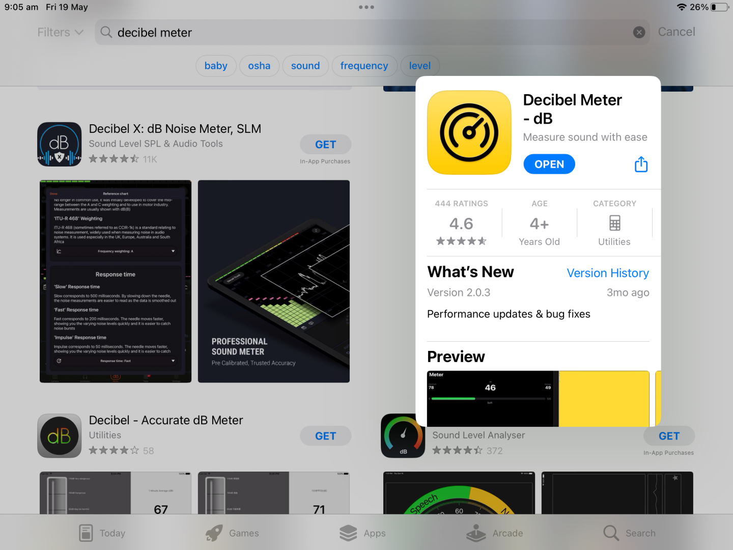

I have a relatively new van with an Ibis 4 and the noise was relatively high when laying on the bed about 2 metres from it.
Download a noise measuring app on your phone and measure the dB level.
I used Decibel Meter.
I have run mine on cooling and found that running the fan on eco mode substantially reduced the noise. Cant make any comment yet in heating.
