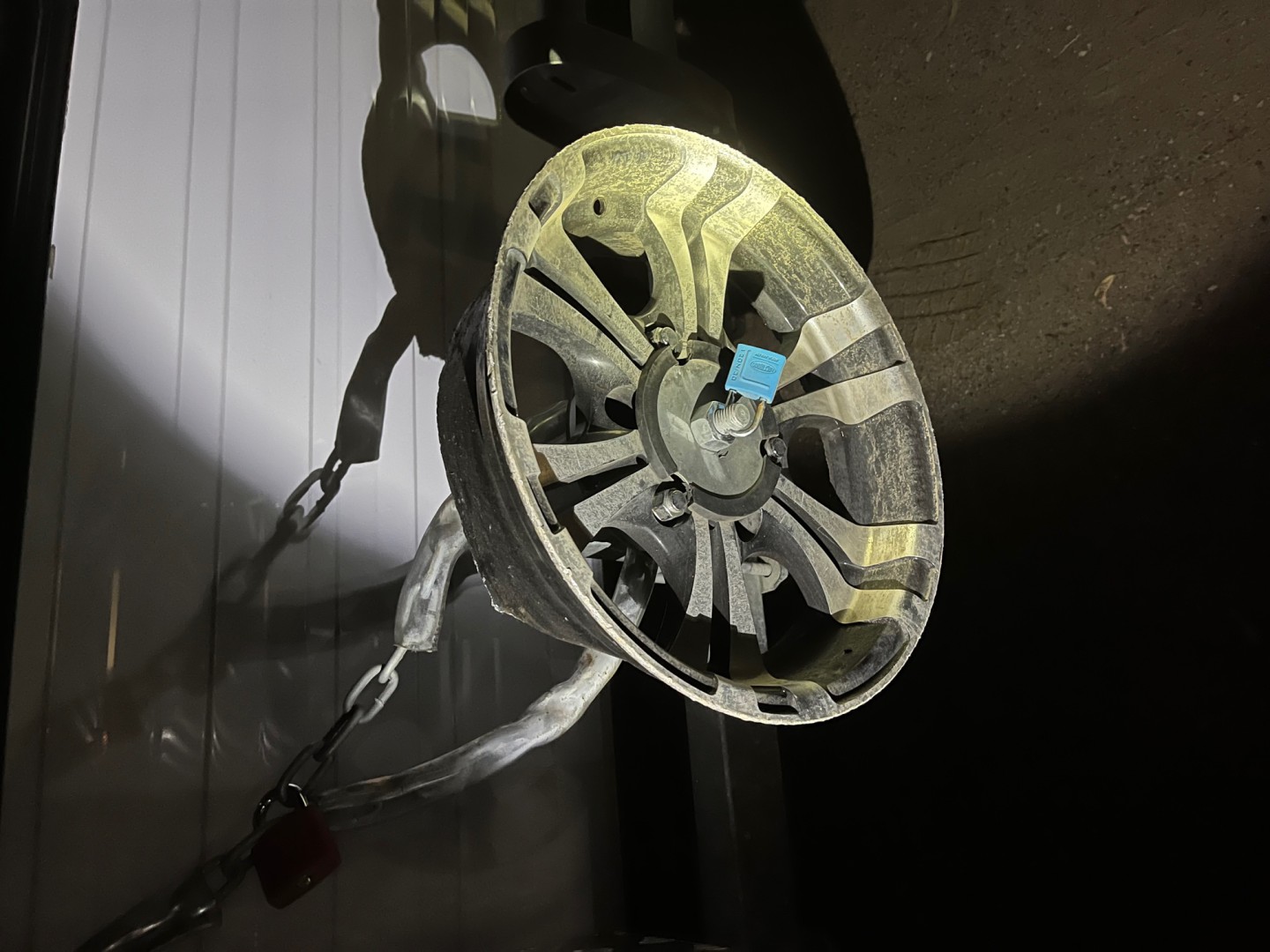

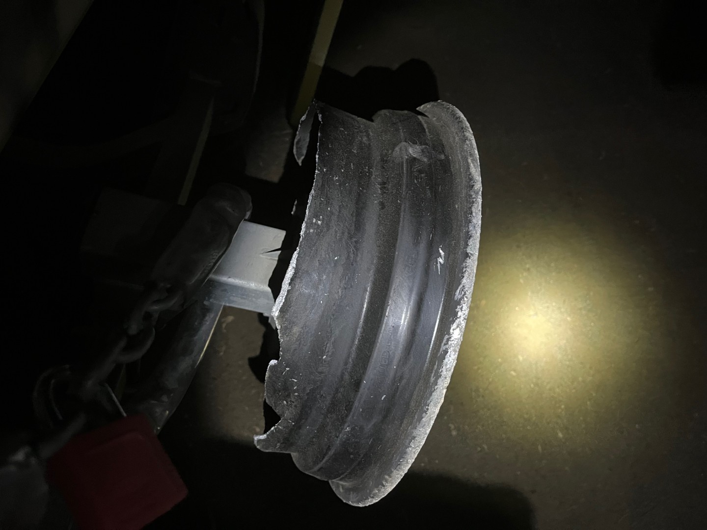

Hello this is my first post here and unfortunately after today I need some advice/help.
30km from Broken Hill my tandem caravan wheel ran off the steep edge of the bitumen and all hell broke loose.
I had glanced in the mirror at a truck that was closing fast from behind when it happened.
He then flashed his lights at me multiple times as he saw bits and pieces of tyre and mag wheel flying everywhere.
He stopped also and kindly helped me change the wheel and wanted nothing in return, even the cash I tried to offer him !
There are still good samaritans out there not just us grey nomads !
Any idea/recommendation where in Broken Hill I will get a mag wheel and tyre 205/70/R15C and 8PR 106/104R MAX pressure 65PSI Max load dual axle 900kg ?
Thanking anyone in advance for any advice, safe travels to all - btw heading for Cairns, somewhere warmer :)
-- Edited by RustyJeep on Friday 19th of May 2023 12:14:04 AM
-- Edited by RustyJeep on Friday 19th of May 2023 12:14:51 AM

Hi Possum3, thanks for the reply I will head off there shortly. I still don't really understand the mechanism of the failure.
The car tyres remained on the bitumen and I was surprised at the loud bang and am not sure if that was what caused the caravan to lurch to the left.
I accept the truck drivers summary that he believes the caravan wheels just ran off the bitumen shoulder.
I was running 47PSI calculated from tyre rating and approximate load of caravan and onboard weight.
All pressures were checked about 150km before the incident at 51PSI.
Can I run 1 steel rim with 3 alloys, would the steel rim have been less likely have had the incident or would it just hold together better compared to my alloy remnants?

Alloy rims are prone to failure, caravans tend to have a rougher ride and bounce more - Steel Sunrasia are less inclined to disintegrate.
You can run a mixture of steel and alloy - put the steel on the nearside, front (roughest part of road usually). It would be prudent to match the tyre specifications - note; caravan wheels differ from ordinary car wheels.

What about the spare yes we currently have the spare fitted. I have been advised that an offset difference exceeding 10mm is not advisable. I wont go anywhere without having a suitable spare available hence the wait.
I do agree that steel rims in future are the go, if another rim suffers a similar fate they will all be replaced in one hit. The tyre place had an identical rim to mine fractured the same as mine & said he has doubts about the rims integrity. Its not old age the van has only travelled about 6000k (bitumen) from new.

I still don't really understand the mechanism of the failure. The car tyres remained on the bitumen and I was surprised at the loud bang and am not sure if that was what caused the caravan to lurch to the left.
Did you have TPMS

I would suggest the most likely situation is you had a leak & not noticed it, then it became critical & the tyre blew out. That is what happened to us due to a screw. Even though we were also physically checking tyres every morning.
