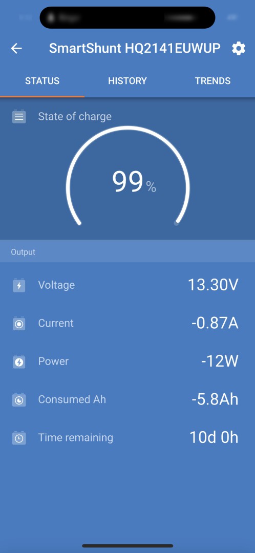

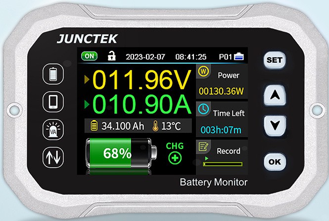

I have tested a few battery monitors over the last 15 or so years.
Votronic, BM-1, Victron, BEP, Juntek, Junctek and a few other cheapies.
Currently I have both a Victron 500A SmartShunt and a Junctek KH140F.
I have absolutely no hesitation in recommending the Junctek over them all despite being a Victron fan.
Available via Ebay, AliExpress etc.
Mine purchased from this store: https://www.aliexpress.com/item/1005005293126063.html

Out of interest i did a little searching and you might like this comment.
For seeing watts in and out, and relative remaining capacity, it's just an outstanding value.
I don't use any of the switching capability, and not sure if I would want to rely on it for highly sensitive high value systems, but for the RV it's just dandy.
BTW, it's pronounced 'joontek', not junk-tech. But I get it.
