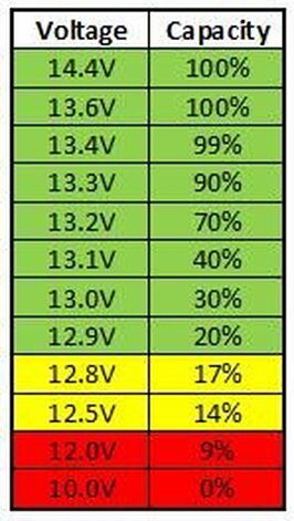

Just remember that with LiFePO4 it is difficult to determine the state of charge using voltage because the charge and discharge curves are so flat until they come to what we call the knee where the voltage climbs or falls very quickly. You could add a shunt to your system hich will tell you exactly where you are at but in the meantime the attached table will give you an approximate when the battery is at rest. Just something to consider in the future.
Thanks very much for that table TimTim. In my total ignorance I used to think that as it was a 12 volt battery and the gauge was showing 12 or slightly above, that all was well in the world of batteries.
I guess if I can keep it in the low 13s all will be well in the power situation.

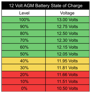

TimTim said
01:34 PM May 23, 2023
Hi DMaxer,
Just to clarify are you talking about an AGM or or LiFePO4 because I was thinking that you were talking about LiFePO4 and then when I read back it seems like you are talking about AGM.
If it is AGM then ignore the the previous table I posted and use this one.

It is an AGM TimTim. It is presently sitting on about 13.4 so all is well in battery town.
Thanks for the chart.
