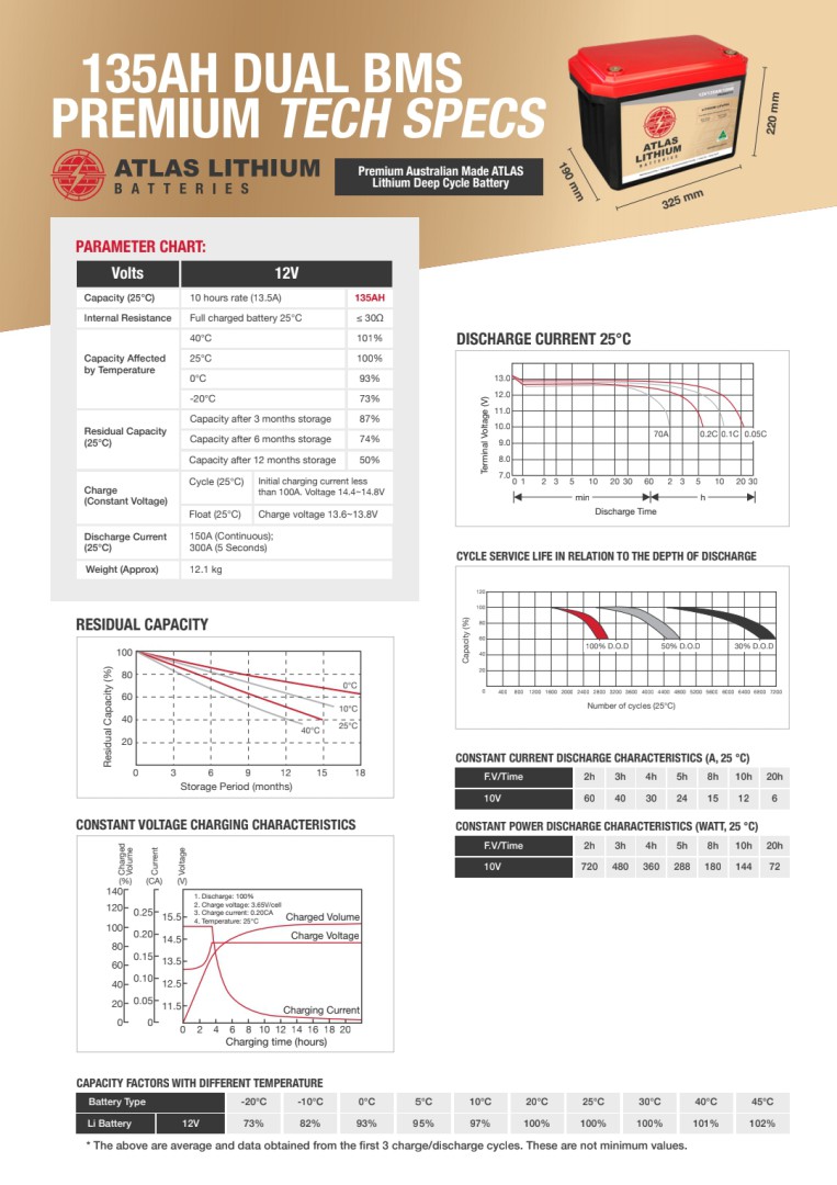

Your money your choice, 12.1 kg for a 135 Ah lithium battery is extremely light, with that weight a quality lithium would be around 90 Ah.

Kebbin there is very little lithium in a LiFePO4 battery and much of the weight depends on the electrolyte. These batteries are getting lighter and lighter and with just a small BMS the weight is easily achieved. I haven't looked to see if they have prismatic cells in them but you can easily take a look at the cell weights.

Here is the Specs Sheet attachment
