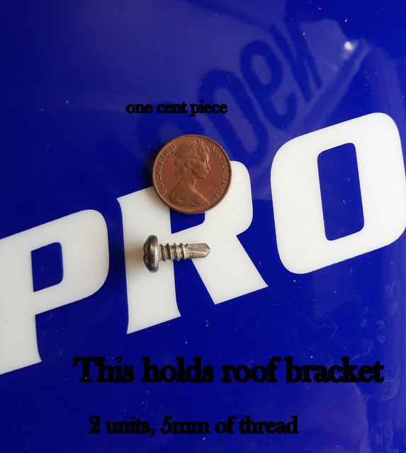

This is all that holds the roof J bracket on, 2 screws that barely make it through the actual roof extrusion. But they use two per bracket, so that works
The end screws hold it on until the sealant under the J Mould cures.

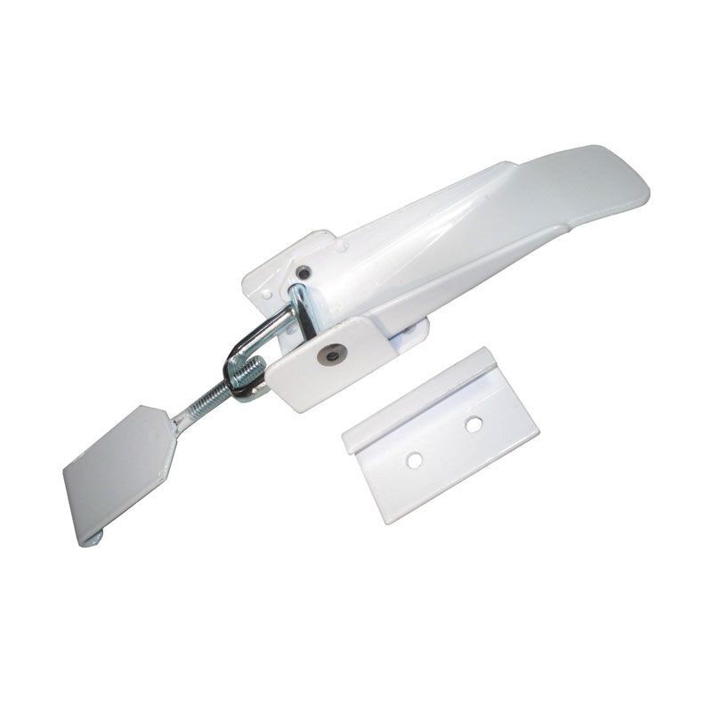

One of adjustment threads had gone rusty as well as a bit on the "j " so needed to remove for maintenance. Have added a stainless metal thread as a safety belt.

Ken, the original screws are stainless, maybe 304 as they have a bit of magnetic attraction. There is no sign of corrosion on steel powder coated bracket, or on end of screw. But an interesting link. thanks
My rust on one thread due to poor coating of same, the other three are all still as good as new. But the whole thing looks pretty poor design/assembly when examined closely. Rivets , thread, weld? between thread and j bit, weld? on shiny D shape.
But no obvious stress anywhere, so what keep the roof down ?, mostly inside locking /lifting bars I think.
