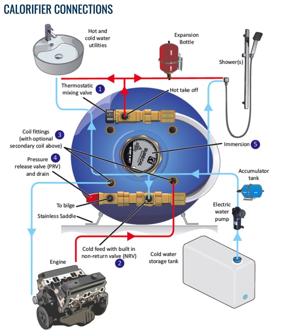

Have you looked at Marine Calorifiers? We have one in our car, the second vehicle we have had one in & love it. It is basically a heat exchanger inside an insulated tank. Water is heated by waste heat from your vehicle's motor. Costs nothing to run, always have hot water when you arrive somewhere, never have to think about it, water stays hot for up to 3 days. Has an adjustable tempering valve so you can select temperature at the turn of a knob. This automatically adds cold water as it is dispensed at the temperature you choose. Tanks are from around 10 litres upwards. Ours is a 22 litre. Most also have a 240v heating element so if you are on a powered site/have lots of solar or a generator you can just plug it in instead of driving. If we are staying in one place for more than 3 days we either boil a billy or go for a drive. 20 minutes drive heats water enough for a shower. Longer drives heats your water up to engine coolant temps. With the cold water being added automatically water it makes the 90 degree water go much further. We have ours inside the canopy on our ute.
Another alternative is a diesel water heater. Some people use their calorifier in conjunction with a diesel water heater, so if out bush & not wishing to drive the diesel heater can pump heated glycol through a second coil inside the tank to heat the water.
