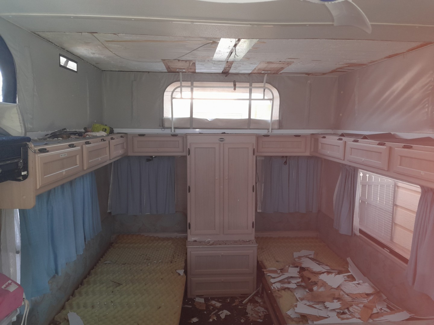

I have a Jayco Freedom 2002 Pop Top that has developed a leak in the roof at the very back.

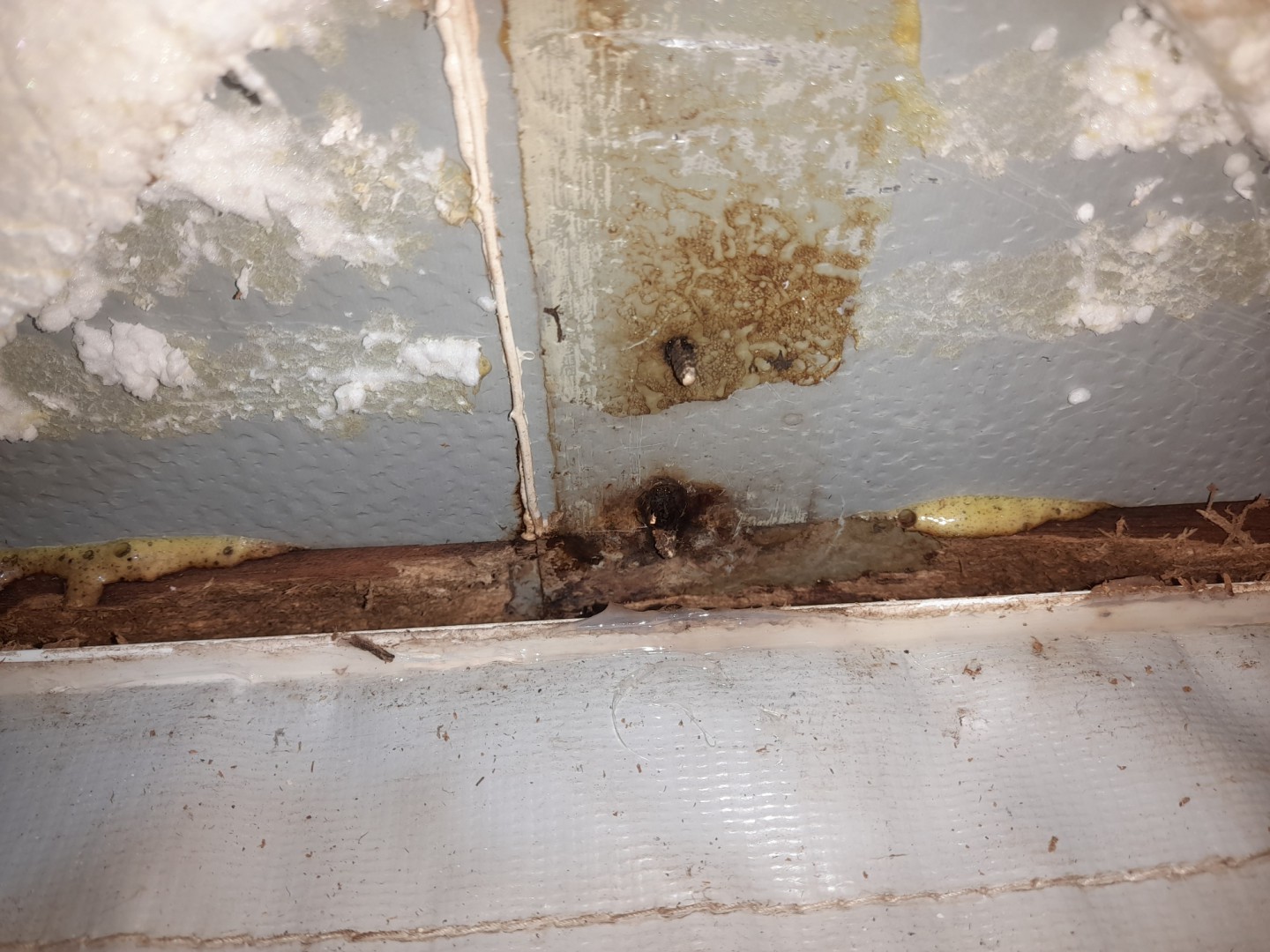

I have located the leak, after removing the Ceiling Panel, and it is a rusted screw that appears to be under the J Mould (I think that's what its called) on the roof.
Unfortunately, the timber has rotted away and will need replacing.
Wondering if anyone out there has been through this repair and might be able to provide some assistance with advice.

It would be prudent to remove roof - patching rarely works - much of the other timber in roof is probably affected.
If I were doing it I would remove roof innards - remake a pop-top frame on the bench/floor leaving old one on until ready to fit fibre glass to new one.
Ensure you repair hole/s in roof shell with resin and glass fibre mat - not silicon.
Easy job for handyman or boat builder.

Another viewpoint ( Not as strong as the above suggestions, but a lot less effort)
I would clean up the rust, rust convert, paint.
Hopefully you can remove the interior roof panel side to side so you can see the full length of decayed timber beam
Make up a beam of similar size/length, screw in Gal angle brackets at each end of the new beam so that the other side of the angle bracket can be screwed to the side beams of the pop-top.
Remove 25mm of old silicon in the middle of the roof where the new beam will fit
A 2 person job. T-Rex ( see below or similar) the new beam onto the old (dry) beam and the top of the new beam to the roof
Screw the angle bracket at the ends of the new beam to the side beams of the pop-top.
Prop up the new bean until the T-Rex dries
On the Roof use the Rubber product below or similar with Tape wider than the J mould to more than cover the J mould plus at least 25mm.
I suggest overpainting the Black Waterproof covering with 2 coats of suitable white paint.
