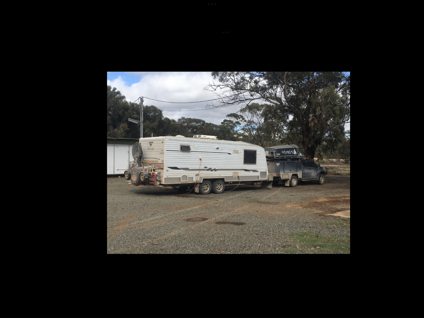

P.S Not an LC200, but typical of the setups I see at free camps etc in my travels. Despite his reassurances that he was "All legal mate. No worries mate" it is obvious to the trained eye that this vehicle is overloaded, unsafe and uninsured. Ignorant? Stupid? Arrogant? All 3?

An accident waiting to happen? A lot of LC200 owners are unaware of the relatively low payload.
Those who think they are go for the obligatory GVM upgrade. However I still do not think do not know how to
calculate the payload.
Not hard if you spend the time and effort to find this information.
Also they are probably not given the full gamma by the people doing the upgrade as they probably
would realise it is a lot of money for very small gain. $$$ don't want to miss out here.

Driver and front passenger in their 60's rear passenger 30 - 40's.
Travelling from Coolangatta to Melbourne. Both of us were leaving the same day. He left around 8:00am,
we left around 10:30am. About 300 odd km down the road there he is stopped on the side of the road.
We stopped to check if he needed assistance. He had everything 'under control'.
Why was he stopped? Both, not one but both bolts that secure the head to the hitch had sheared off.
At this point I jumped back in our Landcruiser and decided to put as much distance as possible before all
hell potentially broke loose.
Yobarr, ignorance, stupidity or just plain arrogance? Maybe all of the above.
