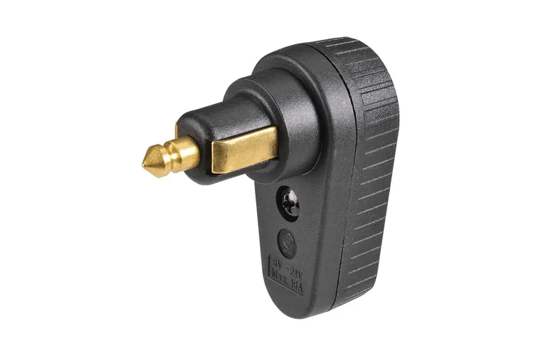

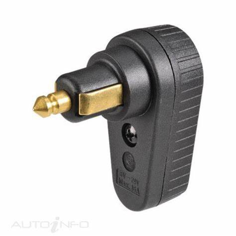

My ARB fridge recently went " on the blink ", started intermittant on/ off, then off. I could get a power reading at the fridge end, but no working on 12v, fine on 240v.
Went to an expert, almost some sort of relo, and he found that there was " no continuity reading ", pull oem plug back apart and some signs of it getting pretty hot, and that positive power hold down screw was almost bottomed out, shorter screw and it worked.
But in interests of reliability we fitted a heavy duty Narva right angle version with seperate inline blade fuse. ( oem had older style ceramic barrell type).

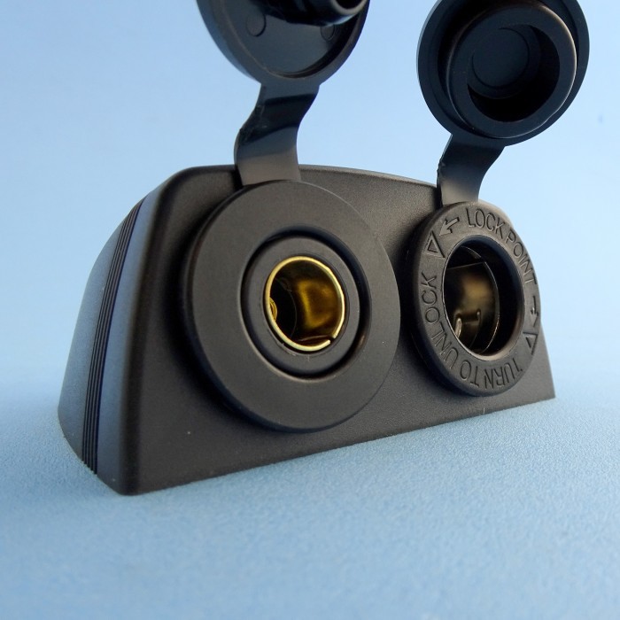

Also, I have a dedicated double outlet socket, for merrit and cigarette style, so a major mission to change to Anderson, due to drawer and cage setup. (Someone with 6ft ourangatang arms could do it)

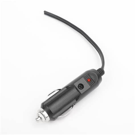

Ah ha! The old 12V automotive cigar lighter connector.
Each and every one of them should be removed, taken outside, placed on a solid concrete block and then beaten severely with a 1kg to 2kg lump hammer.

I think you'll find the one pictured is actually a Merit plug, albeit a 90deg one. It goes by many other names such as Hella plug, BMW/Triumph motorcycle plug, Powerlet plug, and by it's official designation of ISO 4165.
It's far superior to the ubiquitous cigar lighter type because it was originally designed as a DC plug, by the Germans in WWII for their military vehicles, and not a modification of something never intended for that purpose!
Specifically, while the cigar plug is always trying to jettison itself from the socket due to the spring loaded central positive pin pushing it out, the positive pin on the Merit is fixed and indented, and is gripped firmly by a clasp inside the socket, like an audio jack plug. Another advantage is that the Merit plugs and sockets are about half the size of the cigar ones (comparative scale on the photos below is misleading), particularly useful when you are bulkhead mounting a 12v socket and the space behind where you're mounting it is an issue.
First thing I did when I bought my new camper was to replace all the cigar sockets with merit sockets!

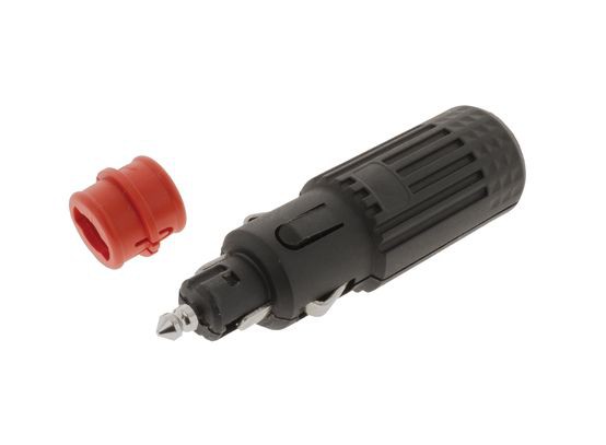

Incidentally you can also get combi Merit/Cigar plugs that have a removeable red adapter which converts them from one to the other - but beware, it's one of those cases where by trying to do two things it does neither well. My advice is to stick to straight Merit plugs if you want a good connection.
Merit plug...
90deg Merit plug
Cigar plug...
Combi Merit/Cigar plug...
Comparison of the sockets - Merit on left and Cigar on right...

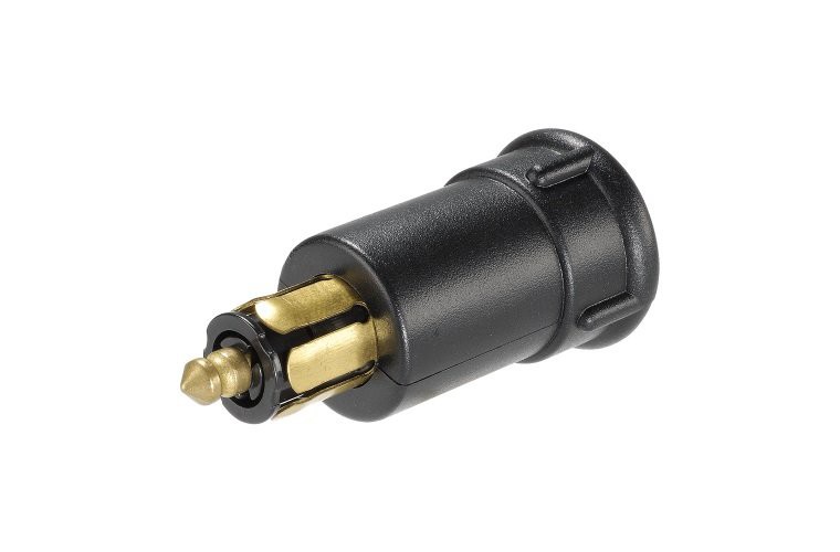

Hi Mike, apart from the Merit plug another one worth looking at is the Engel posi-fit. Rated to 15A @ 12VDC and incorporates a screw-in collar to secure the plug in the socket - very useful for appliances that need to stay plugged in and running while bouncing around in the caravan/camper while underway, like a fridge.
