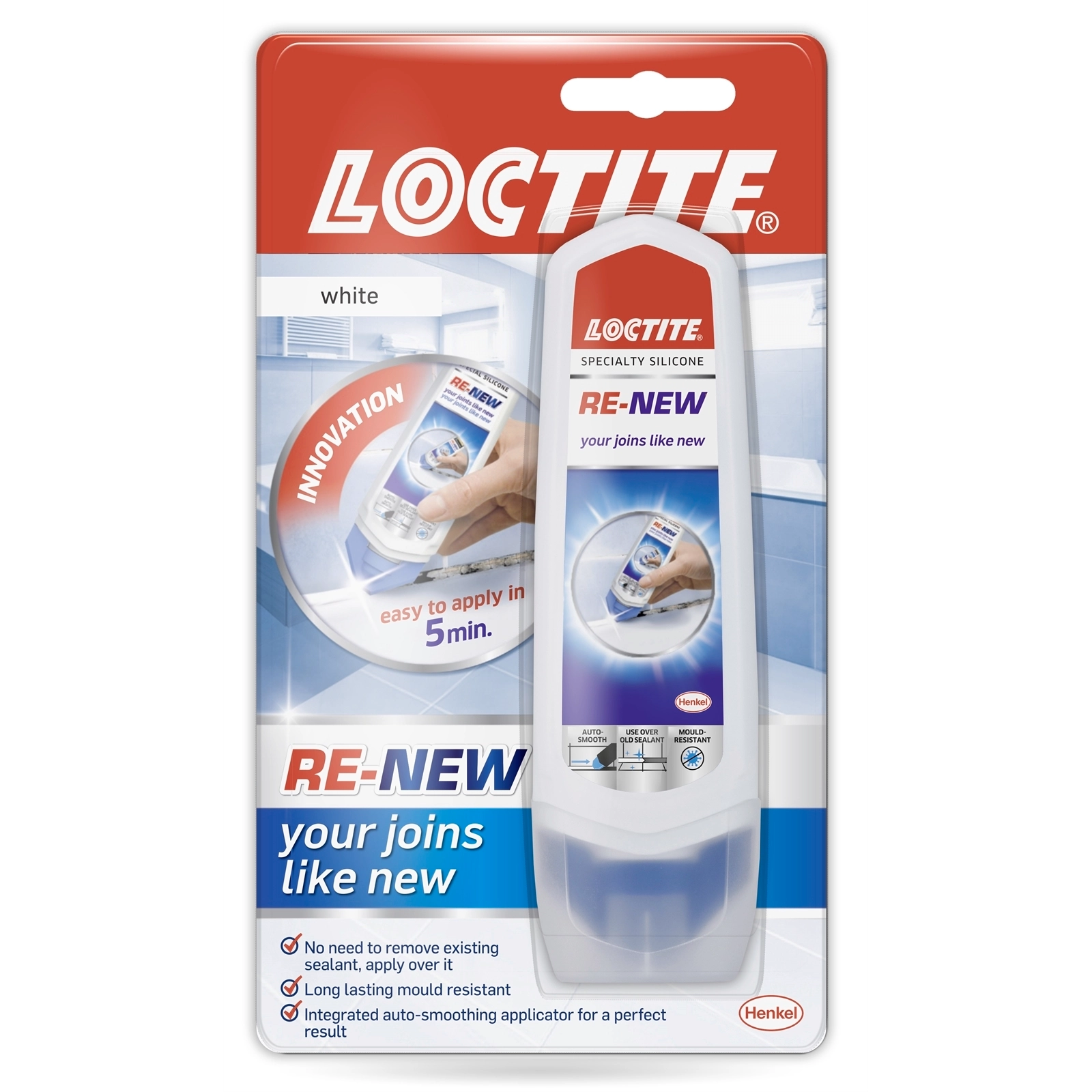

I used this stuff in my bathroom, applies over existing sealant, got it from the big green shed.
Strangely mould will grow quite happily inside silicone sealant. Unless you purchase a silicone like Bathroom and Kitchen or Wet Area Sealer that contains a mould growth inhibitor.
You may find this very difficult to eradicate. Don't forget that many of the liquids others have suggested may react with components of your van. Physical removal and replacement although time consuming maybe the best alternative.
The best sealant to use where silicone has already been used, is another silicone, as many other sealants will not adhere correctly to the substrate if silicone is still present, even a very thin film..
