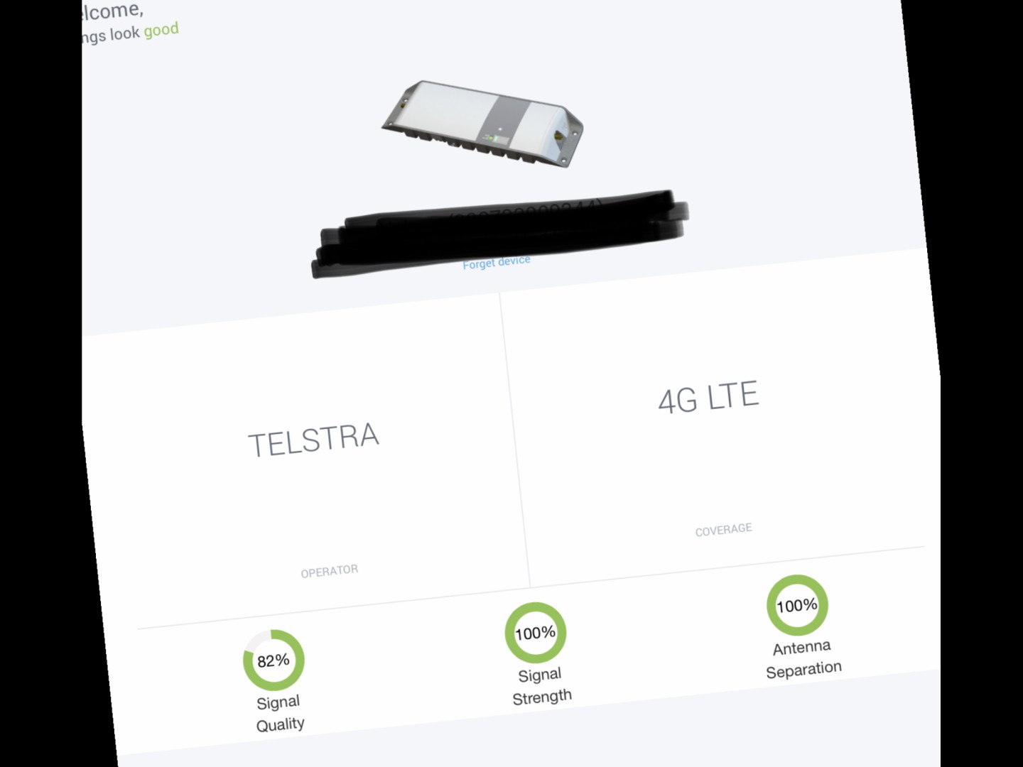

12:44 PM Apr 3, 2023
Just did a screen shot of the Wave app. Pretty good for just a amateur install and the supplied 3" antenna of roof only. I hope to improve that once antenna is up higher or even at a later date fitting a car like antenna to the pole. It's just a case after a days drive to just up the pole and join two cables. I stay in one spot for lengthy times to enjoy the areas around. There is no hurry.

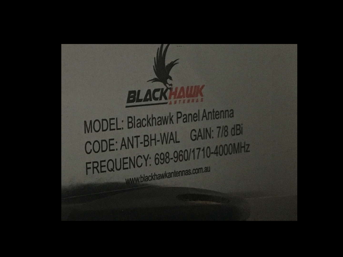

yobarr said
07:52 AM Apr 4, 2023
Spin wrote:
I am interested to hear more about the repeater you mention. That would be the best of both worlds.
Here is picture for you. Unit is about 160mm square, has a pivot to point it where you want, and simply is screwed to a wall anywhere in van. Good luck. Cheers

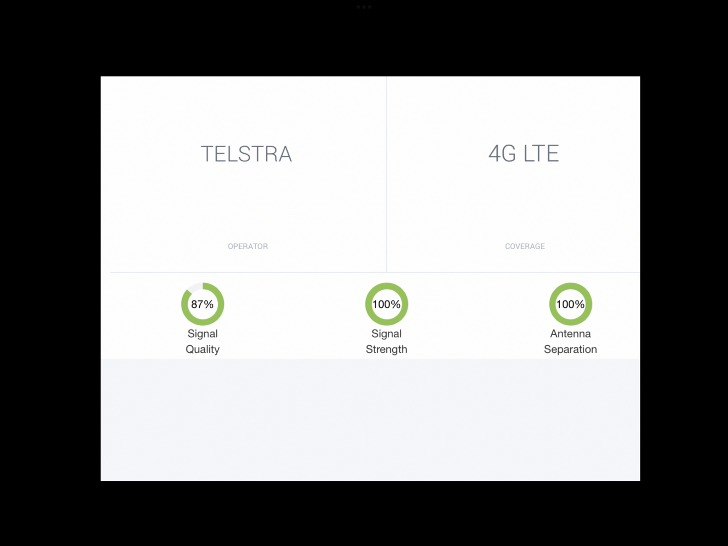

Spin said
05:56 PM Apr 5, 2023
The Cel-Fi turned up this afternoon. I opened the packaging and it got the better of me. For now the antennas are installed on the bulbar and inside the canopy.
I will get some testing done on the weekend but for now below is the wave app. Normally I have 2 bars on the Samsung S9
Good results there. You no doubt know that signal quality is a lot more important than is signal strength. Cheers
-- Edited by Dougwe on Monday 3rd of April 2023 12:47:05 PM
Absolutely pouring rain here in the bush, with heavy low cloud cover, but still got this reading just now. Cheers
-- Edited by yobarr on Monday 3rd of April 2023 02:49:54 PM

You could consider mounting the aerial to a single bar rack across the roof of your car. A 1200mm aerial up there should give you close on 3 metres above ground, with clear 360 degree spread. Cheers
-- Edited by yobarr on Tuesday 4th of April 2023 07:52:53 AM
Today's figures, just now. Still in bush, still raining heavily, still heavy cloud cover. Cheers
