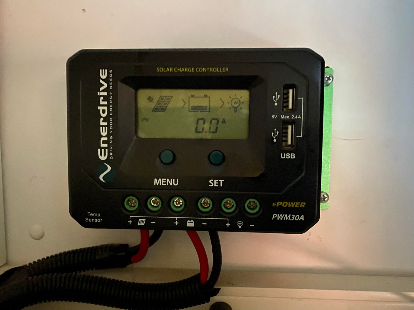

Triggy said
10:27 PM Mar 28, 2023
looks like no power coming on your gage.just battery voltage showing and no amps flowing. You have a problem with your generator or your battery charger not charging to the batteries what sort of generator do you have is it inbuilt in the van or external on the ground .Where is it plugged into in the van ,direct into a charger or the power inlet of the van. The problem is from the generator via charger to the batteries .the generator puts out 240 volts ac into the charger then the charger converts it to approx 14v dc to charge the battery so your meter should be showing how many Amps flowing in on your gauge.(A= Amps) the picture of the battery on your gauge should be charging voltage if all was well .check all connections from the generator to the batteries To test, Try plugging a 240v small appliance directly into the generator see if this works or not will tell if the generator is working or not . Is the charger turned on or has it blown fuse . The generator can also go off on overload if too much 240v current draw Turn off all 240v appliances eg hot water microwave .etc and restart the generator .Its trial and error to find cause. Your batteries won't be the cause of no charge as shown on your gauge .
