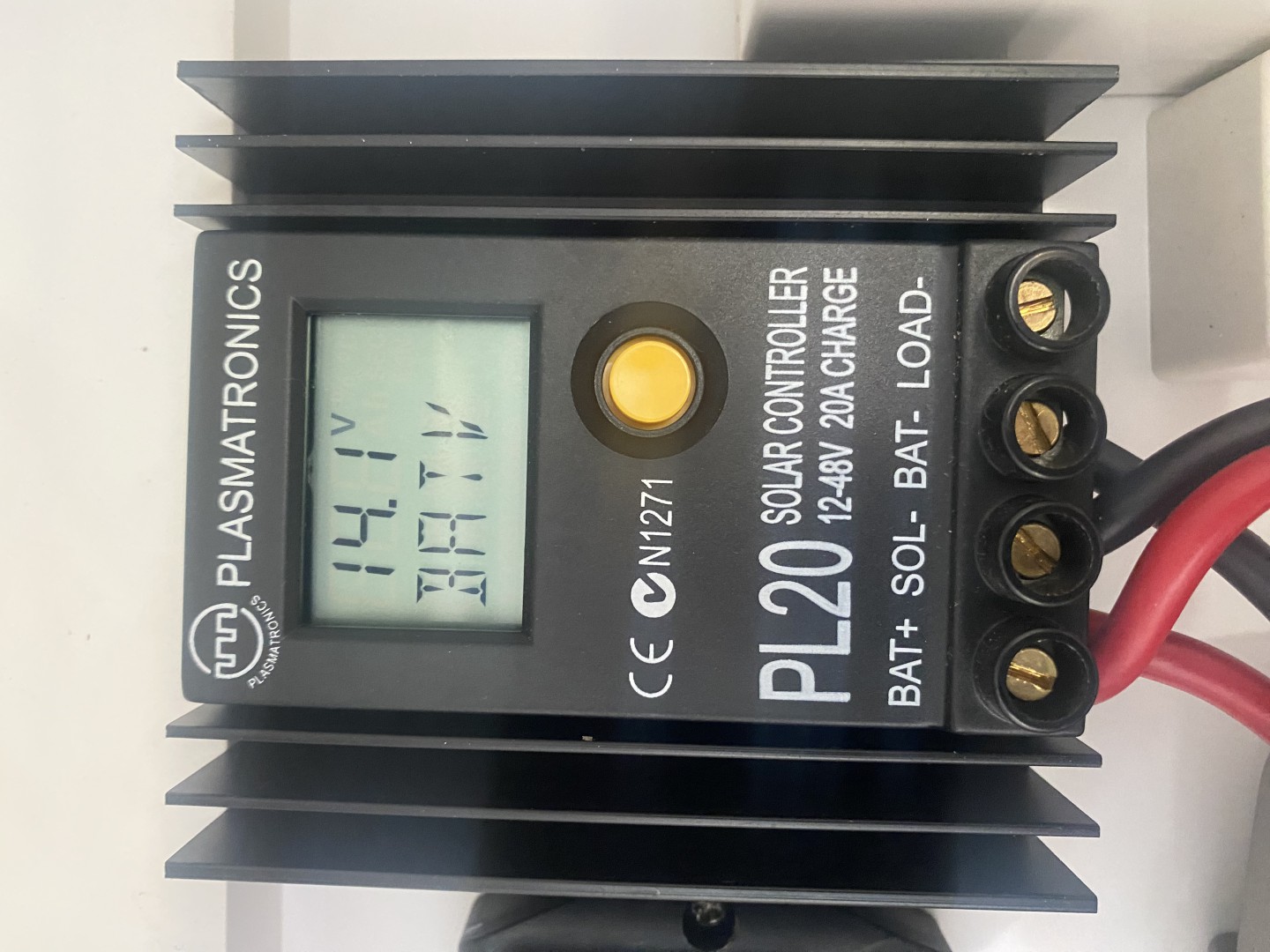

I have a 165 litre compressor fridge, and the specifications state 12 volt consumption 80/24 hours approximately.
Does this mean that when in use it should use around 80 amp per 24 hours?
I have 3 x 120 amp AGM batteries, not sure of age as they were with the van (our first caravan) when purchased about 12 months ago.
When the sun is shining I note on the controller that the batteries appear to be in float at 13.8.
I have been running the fridge for the last few days (no other power being used in the van) and the battery level during the day has remained at 13.8. Each afternoon around 5 or 5:30pm as the sun is disappearing I have checked again and battery level is around 12.8.
The following morning, before the sun gets onto the solar panels I again check battery level and it is down to 12 or 12.1.
This on my limited knowledge appears to be excessive use. What are your thoughts.
I do understand that I may have crook batteries and I will be checking this today.
cheers

It is certainly possible that your batteries have age/use related loss of capacity.
However before reaching that conclusion there are a couple of pieces of information required about the charging side of things rather than the storage side.
1. How much solar do you have & have you been getting plenty of sun.
If the answer is 'not a lot' then your 13.8v may not signify that your batteries are in float mode. It depends upon whether your charger is saying it is in float, or whether you are assuming this from the voltage reading. If the charger is saying they are in float then I would concur with Mike Harding that your batteries are getting to the end of their life & have lost a significant amount of their capacity.
If however you are going on the voltage alone, then it is possible that your charging is not keeping up with consumption. In order to know (by voltage) whether the batteries are in float at 13.8v , you need to know whether they have already been up to 14.4v to 14.6v in bulk charging mode, BEFORE dropping down to 13.8v. If that has occurred then the 13.8v is 'in float'. If it hasn't then it means your batteries are undercharged & charging is not keeping up with your fridge demands.
It is a big 'hungry' fridge & 80Ah per day would need approximately 400w of roof mounted solar +5 hours of good sun daily to keep up. If less solar or less sun you could be seeing the 13.8v voltage dropping overnight to 12.0v or 12.1v (Note: If your solar is freestanding & you are 'obsessional' about moving it multiple times during the day to follow the sun AND you have panels stood up at an angle rather than laying flat, you might get away with 300w).
If the batteries were at their full capacity (360Ah when new) & only the fridge running, you should see the batteries at around 12.5v minimum early in the morning a bit before first light. This is the best time to check - if you get up for an early morning wee, make it routine to check battery voltage - noting whether the fridge is running at the time or not. If you do this regularly your familiarity with the the 'norm' will quickly tell you when something isn't right).
So at 12.0v or 12.1v it is clear that your batteries have not reached full capacity the previous day - either because a) they are old & knackered & no longer have sufficient capacity or b)because they were not fully charged the day before.
Indicators of a) are - voltage rises to 14.4v+ before dropping back to 13.8v and/or there is a float mode indicator which is on.
Indicators of b) are - voltage does not rise to 14.4v prior to dropping back to 13.8v, and there is no float mode indicator.
You can do a load test to check capacity, but it's not practical whilst the system is needed to be in use. Any battery place can do a quick load test which takes a just a minute or less, but this is destructive to the batteries (esp. deep cycle batteries) & not recommended. To do a proper load test they would need your batteries for 24 hours.
On balance: If I were in your position & you have had sufficient solar & sun, I'd bite the bullet & get new batteries.

1. How much solar do you have & have you been getting plenty of sun. Not sure on solar, as came with the van. Possibly only 200w fixed panels, is there a way of determining size. I also have a 200w portable If the answer is 'not a lot' then your 13.8v may not signify that your batteries are in float mode. It depends upon whether your charger is saying it is in float, or whether you are assuming this from the voltage reading. If the charger is saying they are in float then I would concur with Mike Harding that your batteries are getting to the end of their life & have lost a significant amount of their capacity.
If however you are going on the voltage alone, then it is possible that your charging is not keeping up with consumption. In order to know (by voltage) whether the batteries are in float at 13.8v , you need to know whether they have already been up to 14.4v to 14.6v in bulk charging mode, BEFORE dropping down to 13.8v. If that has occurred then the 13.8v is 'in float'. If it hasn't then it means your batteries are undercharged & charging is not keeping up with your fridge demands. I had power connected yesterday and bulk charge was (when I looked 14.2)

I have older controller and AC to DC charger.
If I go Lifepo4 is it just as simple as taking out old controller and putting in new one with same wiring. As for replacing AC to DC with a DC to DC charger, what is needed to be done here.
You'll need to check this, but I believe the PL20 is adjustable which may make it suitable for use with Lithium. Size wise (amps) depends on amount of solar.
A DC to DC charger does not have to replace an AC charger, you can use both, but either will need to have a lithium profile to be useful. And to make use of Lithiums abbility to charge fast you would need a higher amp (read - more expensive) charger. Lower amp ones will work, but not much, if any quicker than with lead acid batteries.
DC to Dc chargers like Redarc's BCDC chargers are combine solar regulators & dc to dc chargers & do the same job as the VSR (aux battery solenoid to protect starter battery from being discharged by your fridge etc). So you could repace your PL20 with, for example a Redarc BCDC1240N which would give you up to 40 amps charge as you drive, & do the job of your PL20 &leave room for more solar if /when you decide to get it. If Your AC charger has a lithium charging profile, you could use it. If it doesn't you will have to be advised by te battery manufacturer as to whether their Lithium BMS (inbuilt Battery Management System) will handle it. You may not need a mains charger, depends how often & for how long you generally drive. Handy to have a mains charger though.

Hopefully I will get a quick answer, as Im on the road tomorrow
cheers
-- Edited by shakey55 on Sunday 19th of March 2023 07:08:50 AM
Your batteries are dying of old age.
Thanks Mike, I thought this may be the case, but had fingers crossed that it was not.
When I replace, and not in the position to covert to lithium, as I would have to purchase batteries, solar controller and batterycharger (at least this is what I think).
Are the good and bad AGM batteries. Do you have any experience of what are good and bad brands.
-- Edited by shakey55 on Sunday 19th of March 2023 08:17:32 AM
I was in a similar position to you in 2021 with 360Ah (3 x 120Ah) of AGM's failing. I had decided to replace them as we were headed to remote areas where replacements could take weeks to get & cost would have been much higher, so got the battery place to do the quick load test just for interest sake. It turned out that one of the 3 batteries had dropped a cell, & the other two with reduced capacity were struggling to keep up, just as you describe. They had lasted for 9 years & 10 months, including 5 years in full time use. I chose to replace them with the same again rather than going to Lithium as the only benefit I would get with lithium would have been a significant weight reduction, but the additional cost of lithium plus the cost to change my dc to dc charger (& the hassle of changing it due to difficult access) made the cost of weight reduction too much, considering we had managed ok with the weight for many years.
Best brand are Fullriver (I got over 12 years out of previous Fullrivers) but my batteries are Ritar, which I consider 'best value', as they are significantly cheaper than Fullriver. So I replaced my 3 Ritars with 3 new Ritars of the same capacity.
-- Edited by Cuppa on Sunday 19th of March 2023 09:44:00 AM
-- Edited by shakey55 on Wednesday 22nd of March 2023 06:32:50 AM
-- Edited by shakey55 on Wednesday 22nd of March 2023 06:34:37 AM
