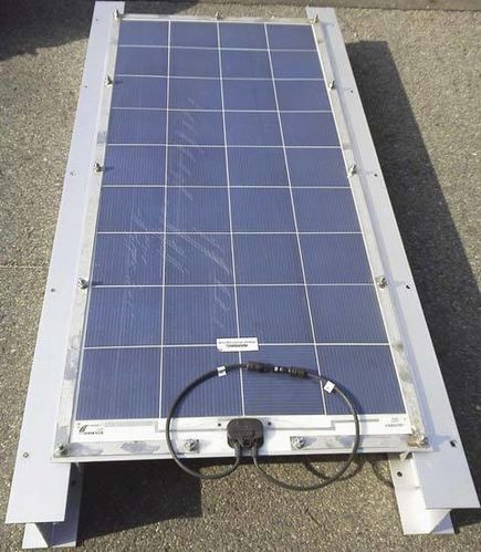

With weight and cooling in mind I've mounted flexible panels onto 10mm coreflute and glued onto the roof. Consulted sikadlex technical and from memory used 252 as the adhesive.
Dick0 said
10:49 AM Aug 21, 2023
Any chance of some pics?
