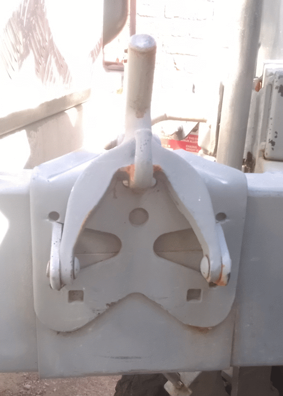

At the tow tug end a non sticky grease is best, or use polyproylene (Gladwrap) as a lubricant. At the bar tip end rather than grease I changed the metal-to-metal contact type.
The hardened steel bar end rubbing on the softer galvanised (zinc coated) steel A-frame digs in and soon starts groaning at the slightest turn. Not good.
A thin piece of stainless steel sheet bent into an 'L' shape can be clamped under the chain lever plates and most of the noise goes away (and changes to a nicer 'tone'). Why does this work? It has to do with a charactoristic of the stainless steel; its 'R' value (work hardening rate). As the hardened end of the distribution bar rubs against the stainless steel the stainless gets harder and harder to scratch and then it begins to be polished. This is totally different to the bar gouging into soft zinc and soft steel and continually cutting into fresh metal.
You can see the polished arc at the bottom of the picture. This is after 3,000km.
bye.
-- Edited by bruceg on Saturday 18th of March 2023 04:02:54 PM
bye.
