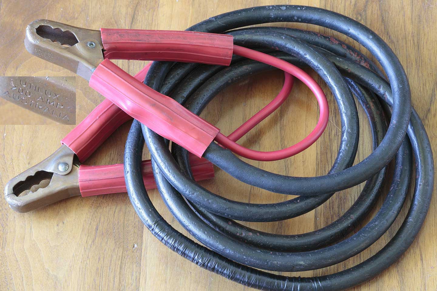

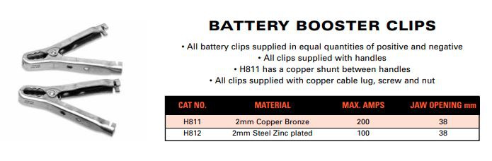

I have Utilux 200 amp continuous load rating clamps on my jumper leads, they are seriously solid.
Hi Whenarewethere,
Apologies if I've misunderstood your post, but I've not been able to find any reference to the 200A rating of the Utilux booster clips being "continuous" and would conclude that they are only rated up to 200A for their stated application of "battery booster clips" which is by nature both temporary and of short duration. Although they are undoubtedly at the top end of battery booster clips, I still wouldn't be using them in a continuous application like connecting an inverter, for the very reasons you stated yourself of cross-sectional area of contact, as well as safety because of exposed metal surfaces and the chance of dislodging one while operating.
It was stated when I bought them 3 decades ago. I also did use them for welding, with actual welding cable.
06:44 PM Feb 18, 2023
The narrowest cross sectional area of the clamp, at the clamp end, is 58mm² per half of the clamp. I have an additional cable for better electrical connection of both halves, 116mm². Clamp pressure is 15 to 20kg.
The handle minimum cross sectional area is 78mm² per half.
The cross sectional area of a 175amp Anderson lug is 58mm²
To get the full rating you do need to use the maximum size cable which is used to dissipate heat from the actual contract area which is quite small.

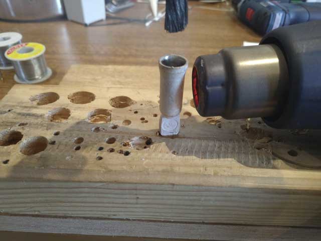

I can crimp or solder Anderson plugs, personally my preference is soldering. Use lead/tin solder, not tin only as it can be a pain & causes hair/whisker growth. For these seriously heavy cables you will need a gas torch or a heat gun. My Bosch heat gun goes up to 630°C, plenty enough to solder welding cable. My two 120 watt soldering irons just don't have enough heat.

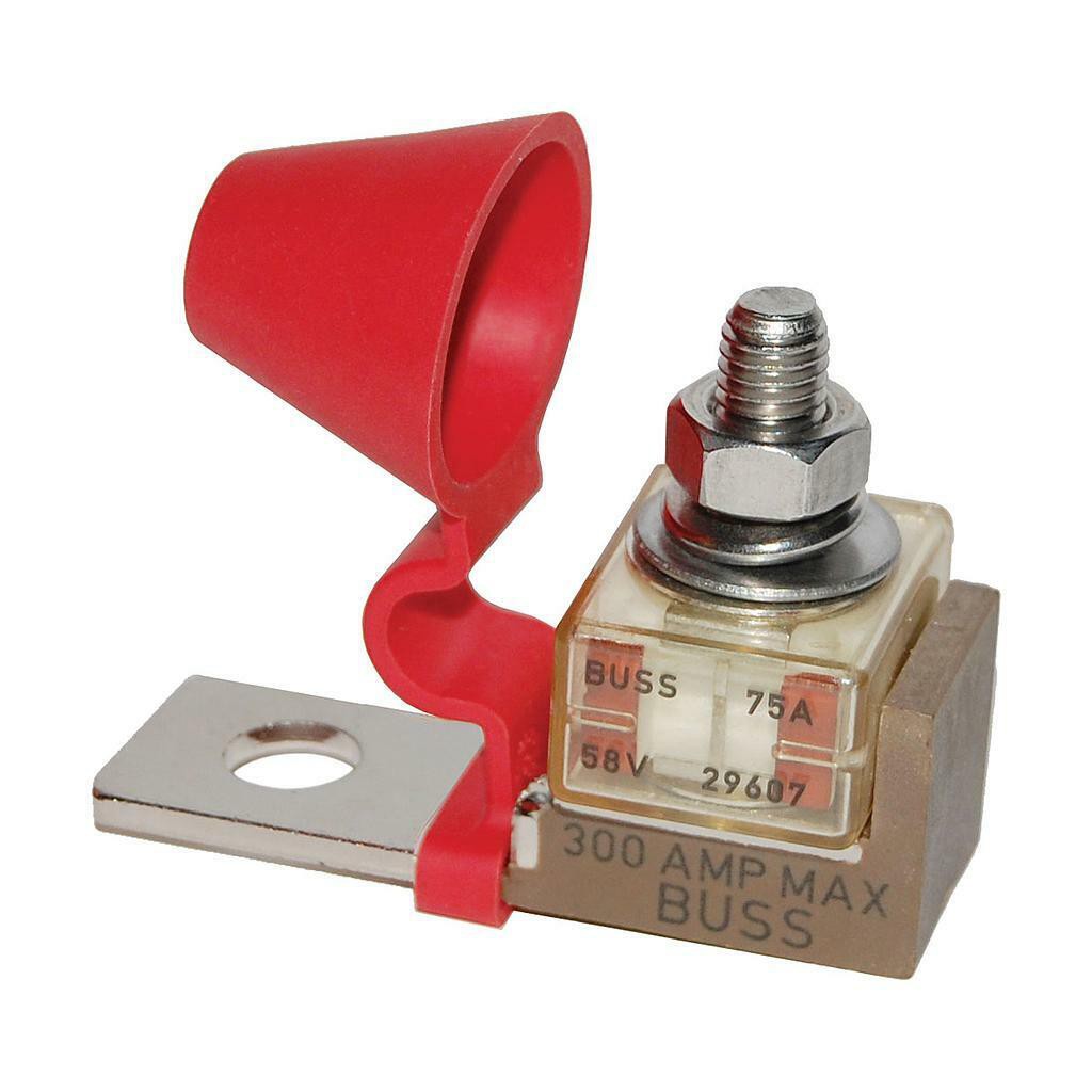

Your fuse, yes you need fuses, in both of your positive cables if you use and two need to be a higher rating than the highest current you plan to draw but lower than the rating of your cables. The fuse is there to protect your cables. ANL type fuses are good.
How do you find the heat gun for soldering? I've never used one for that purpose. Is it possible to heat the cable to tin it without burning the insulation and the like?
02:28 PM Mar 21, 2023
If you use welding cable.
Insulation won't melt quickly. Also the wire is so fine it heats up & cools very quickly at the exposed end.

Like WAWT i prefer to solder mine.

& whether you crimp or solder add a couple of layers of heatshrink tube to stiffen up the cable out of the lug. A bit more defence against flexing the copper wire.
The glue type heat shrink
When I joined the PMG in 1957 I was taught that for a correct joint it needs to be mechanically secured and electrically connected therefore I both crimp and solder 50A Anderson plugs, soldering with my soldering iron.
Then wrap with gaffer tape. Plastic electricians and duct tapes come loose when the adhesive goes almost liquid.
Potentially half of the current will be flowing through the hinge pin or the overlap around the pin.
Of course you could loop the cable and attach it to both arms and as there is provision to do so it may be required for maximum current.
That is the wrong way to make a connection; either crimp or solder, not both.
If you solder the cable the crimp tool will not be able to splay the strands in order to maximise surface area contact for both electrical and mechanical integrity, also a weak point is created at the junction where the soldered and unsoldered portion of the cable meet and will make the cable likely to break at this junction.
Crimp first - mechanical integrity - and then solder - electrical integrity.
No.
A crimped joint does not need further electrical assistance.
If you crimp and then flow solder into the crimp you have no idea how well that solder has mated, it may have done next to nothing.
You now need, because of the lug mass, to apply much more heat to the joint which may well have a detrimental effect upon the cable insulation.
You have created a weak point in the cable because it can no longer flex against the crimp but rather has a very abrupt point of structural difference where the free cable meets the solder.
Crimping is the more reliable option but if that is not possible soldering is acceptable with lugs which are not subject to regular cable movement.
Crimping and soldering is simply wrong.
When I was at Telecom, we used to twist and solder........that was single strand copper, not sure about multi strand, but would think it would work.
That method progressed to the scotch lok connector, which was used with a crimping tool and they were grease filled to keep moisture out.
Cheers Bob
