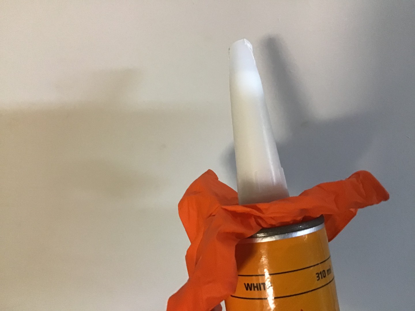

I just opened a new tube of Silicone and used a very small amount. So, Im asking for suggestions for storing the unused portion so that it remains usable for the longest time. I have heard conflicting advice on storing the remains of the tube in either the fridge or the Freezer. Anyone with experience want to make a comment?
TimTim said
08:12 PM Jan 30, 2023
Never heard of the fridge or freezer trick but what I do is I unscrew the nozzle and right away I take a disposable glove using it double layered I place it over the tube and then screw the nozzle back on. I do use a kebab stick to remove a good portion of the silicone from the nozzle so that when it dries it is easy to remove the remainder.
I suppose I could have cut a portion of the glove off and and used it on others but have a heap of gloves .
-- Edited by TimTim on Monday 30th of January 2023 08:40:49 PM

With silicone just remove nozzle & then screw it back on with some plastic over the thread. eg a piece of plastic shopping bag.
Even just leaving the nozzle in place & letting the nozzle contents go off will protect the tube's content for quite a long time
With Sikaflex (eg. 11FC) keeping the tube similarly sealed & kept in the fridge helps to keep it longer. - a few weeks.
I do basically the same but with a piece of cling wrap. works fine no need to put it in the fridge. Landy
