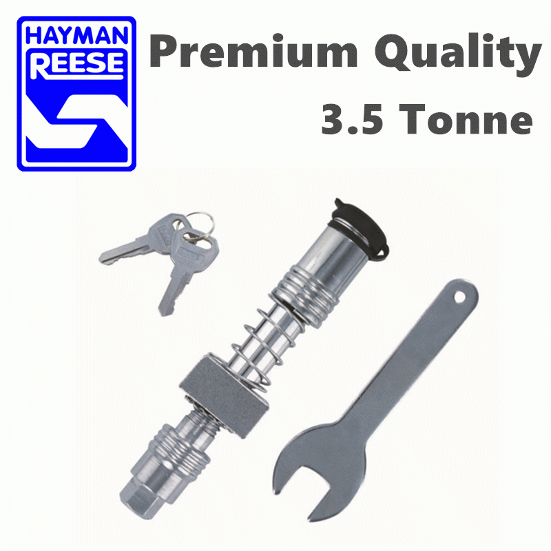

Can't comment on that system, but I have been using the Hayman Reese anti-rattle hitch pin successfully for about ten years now, first with my caravan and now with my camper trailer, and it has the added advantage of locking the tow hitch to the receiver.

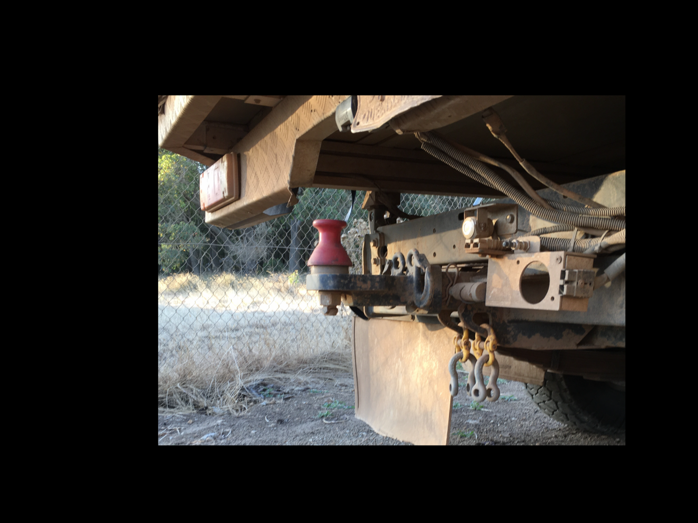

Doesn't bother me as my DO35 is under the tray of the 79. Cheers
