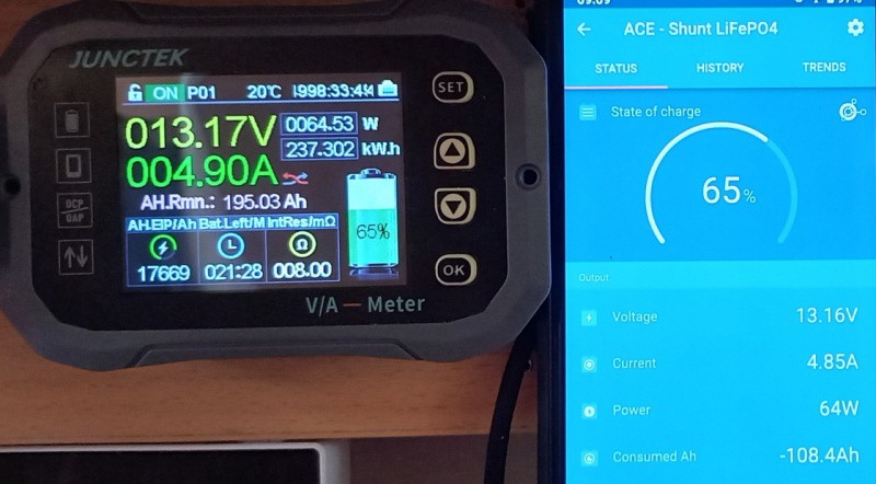

I have used a few shunt based monitors over the years and now have a 500A Victron Smartshunt with a dedicated old phone permanently monitoring the Smartshunt, solar controller, inverter, battery charger, Battery Protect etc. data.
The other battery monitor is an $80 400A Junctek KG140F purchased via Aliexpress.
Both perform perfectly but for casual viewing and monitoring the much cheaper $80 Junctek is my favourite. It can also display the same data wirelessly on a phone or tablet.
A far from perfect photo of my setup with both monitors matching at 65% SOC.
It seems weird these are setup differently from suppliers where they are really the same unit. I'll do as instructions on HardKorr, set it as current voltage on battery.
It seems some people are setting these up wrong from day one who just go with a YouTube video or setup like iTechWorld's video where they say set it to minimum you can voltage wise ie. 1v.
