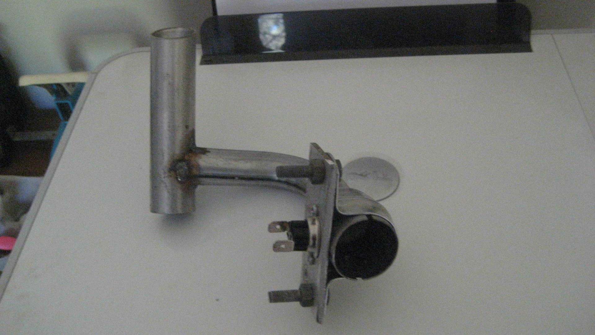

Installed alarm for when gas goes out on three way fridge a. Buzzer -AB3462 $5.25 (Jaycar) b Thermal switch ST3821 (Jaycar) 60 oc Normally closed $6.50 c. Fuse holder 5 amp fuse SZ2015 $1.95 d. Switch to isolate
Mounted thermal switch on exhaust pipe of gas burner need to make bracket for good contact to the exhaust pipe
Takes 30 minutes for pipe to reach temp (buzzer off) Takes 20 min for buzzer alarm after gas off
Read this on a forum somewhere and I installed in 2015 so I cant take all the credit Laurie

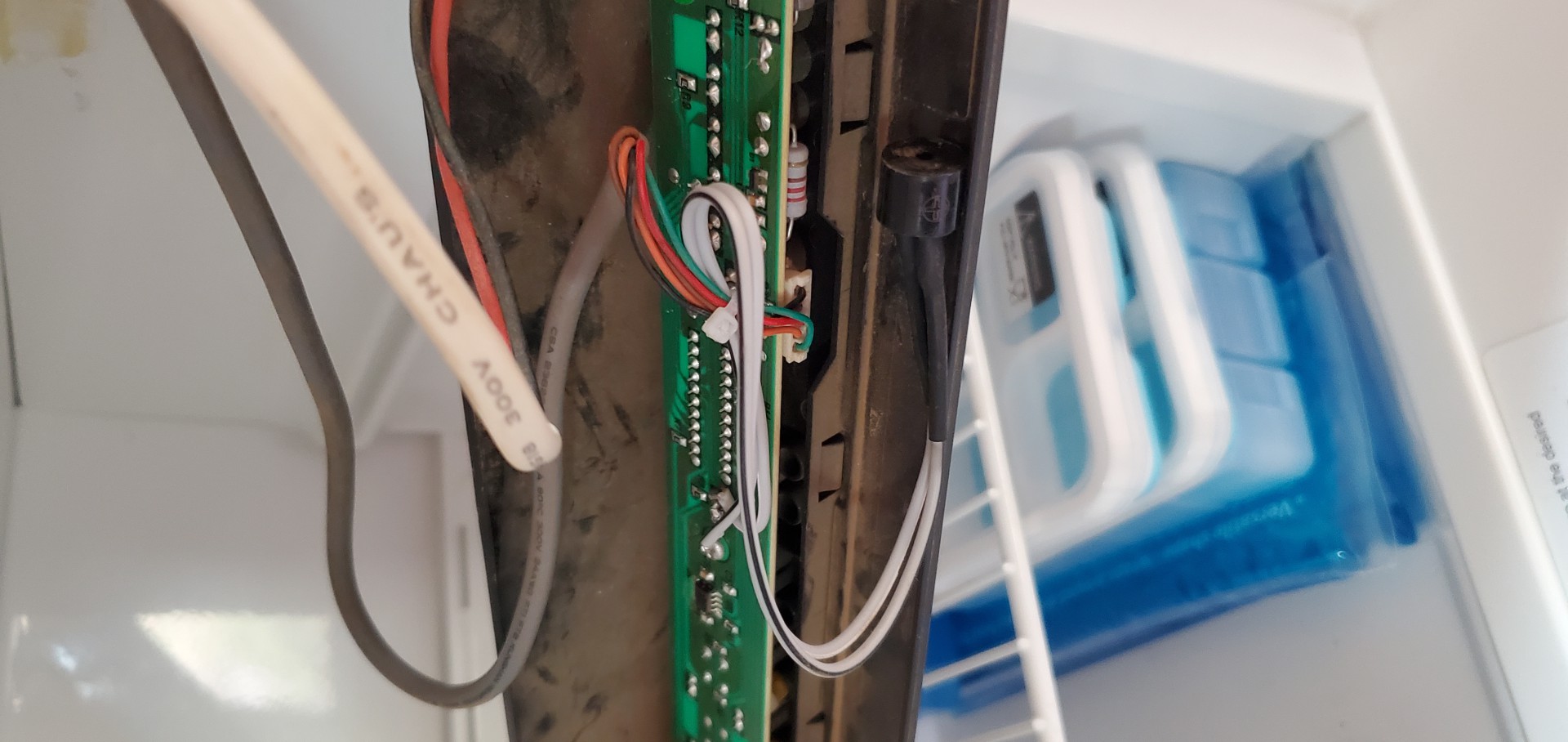

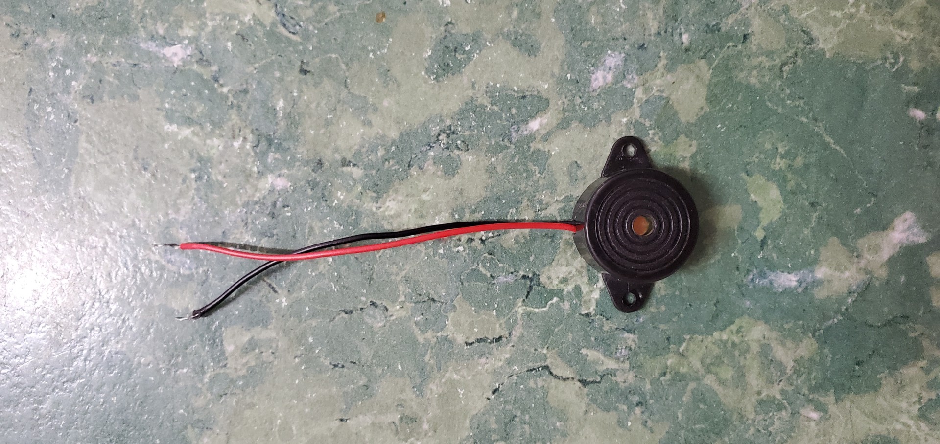

Initially I thought, as you did Mike, that a simple fix should be a piezo buzzer in parallel with LED. Logical yes...LED comes on and buzzer is activated.
Well, the problem is there is a low voltage (millivolts) at the LED pc-board terminals. Which is why the larger buzzer, pictured, constantly buzzed when fridge was turned on and running on gas. It was just too sensitive to very low voltages.
As plan B, I had a spare buzzer for pc-board mounting, like those on computer motherboards, and a pic is attached of the fitted buzzer in parallel to the LED. It seems it is less sensitive than the original buzzer.
Turned fridge on, LED and buzzer activated (must be routine start up test) and when gas was selected as energy source the buzzer went quiet. I say quiet but it has a low volume and soft ticking pulsing sound similar to a quartz clock.
In any case, once the fridge control cover was replaced the ticking could not be heard...at least with my hearing.
With no gas flow the fridge goes into alarm mode, both LED and audible after 10 minutes. This time delay is built into the Dometic electronics.
The audible alarm is more than loud enough to wake me when asleep.
So a $4.00 buzzer connected in parallel and in correct polarity to the LED solved this problem.
