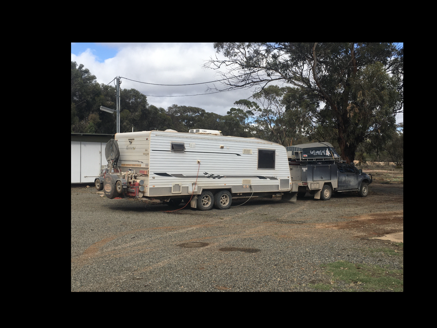

Recently I visited a business that supplies a wide range of caravan parts, and also offers a complete caravan repair service. As I neared the entrance to the business I noticed an older couple messing around with one of those so-called "towball weight scales", so I stopped to chat. The van was a single axle so-called "off road" model, with good ground clearance and wide 15" wheels with flash AT tyres, but the axle was waaay too far back, with very little rear overhang. They had just purchased a flash new jockey wheel which had two wheels, and was allegedly the "bees' knees" of jockey wheels, and they now were in the process of pre-purchase testing a "towball weight scale". Seems their previous factory fitted jockey wheel had simply collapsed under the towball weight when they dropped the van at a van park to go exploring. Because I had previously bought and tested several different models of towball scales I knew how hopelessly inaccurate they are, with my tests not only giving a wide range of readings, but none was anywhere near correct, so I offered to test their weight for them. Towball weight was close to 350kg so we then looked for ways to reduce this, but it soon became apparent that the problem was simply poor design. All 3 water tanks were in front of the axle, with nothing except a couple of bicycles on the rear bumper. The solitary spare wheel sat on the drawbar, in front of a HUGE factory-fitted "toolbox" that had all manner of "stuff" in it. Because their tow vehicle was a single-cab 79 series Landcruiser ute with an enclosed steel canopy we discussed putting the van's spare wheel in there for a start, but they already had 2 spare 16" wheels in there, along with all sorts of other "essentials". The previous day they had weighed the 'van and told that, loaded and ready for travel, it weighed 2600kg. Because towball weight was 350kg it followed that GTM ( weight on van wheels) was 2250kg, but ATM was only 2600kg, so I was snookered. Because the 79 has a rear axle capacity of 2300kg ex-factory, and this car had had a GVM upgrade, we decided to run the whole thing over a weighbridge to check axle weights. Bad news! Front axle was only 1200kg, rear axle 2600kg and van's axle was 2250kg, for all-up weight (GCM?) of 6050kg. Clearly their car was poorly loaded. The van's AGR (Axle group rating) was 2600kg so I suggested that it might be worth getting an ATM upgrade to maybe 2900kg and shifting a couple of water tanks to behind the axle. Problem was that they were around 4000km from their home. Since I could do little more to assist I suggested that they simply had to get rid of weight out of the car and run with empty water tanks, perhaps carrying a couple of 20 litre jerry cans of water inside the van, behind the axle. Like so many people, this couple had little understanding of weights, thinking that they were safe with their GVM upgraded LC79, but they had been caught out by poor caravan design that had the forward length at least 3 times the rear overhang. Caveat Emptor. Cheers.
-- Edited by yobarr on Friday 16th of December 2022 10:19:03 PM
simply poor design. All 3 water tanks were in front of the axle, with nothing...
A bit of free advice, these caravan companies should use an engineer to figure out the load distribution, or for that matter at least get the services of a primary school student to do the calcs, not difficult stuff.
The quality issue with caravans is another issue that seriously needs to be addressed by legislators.
There is a tale of woe also in the Techies column where a member bought a 2nd hand D-Max - complete with some after market "modifications" such as a bashed sump & fuel tank as well as under body cracks
A caravan built this way should never have been allowed on the road especially when there are three water tanks fitted in front of the axle & the temptation to fill them up every time the van is used. Were they there originally or was one added by a previous owner if it was a 2nd hand unit? No-one would know unless the installation was done unprofessionally.
With a number of shonky suppliers of vehicles, vans these days it is important to check everything.
