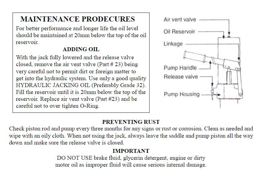

what oil do i put in my trailer mate jack
snap
I did read only use hydraulic jacking oil.
I did fill our trail mate jack with motor oil as it leaks and still leaking 2 years on.
Probably should buy a new one.
Service Instruction attached.
You can get a rebuild kit, be cheaper than a new jack.
Leak is probably due to a faulty "O" ring or Seal......should be an easy fix.
Hydraulic oil is often thinner and manufactured to resist foaming when in use ....important in jacks to prevent a "spongy" effect with the ram and also keeps a positive feel to the levers "pumping action" (not pumping air). Good idea also to not store a hydraulic jack on its side .
Hydraulic jack oil...Bunnings and auto accessory outlets.
