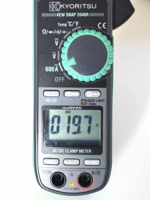

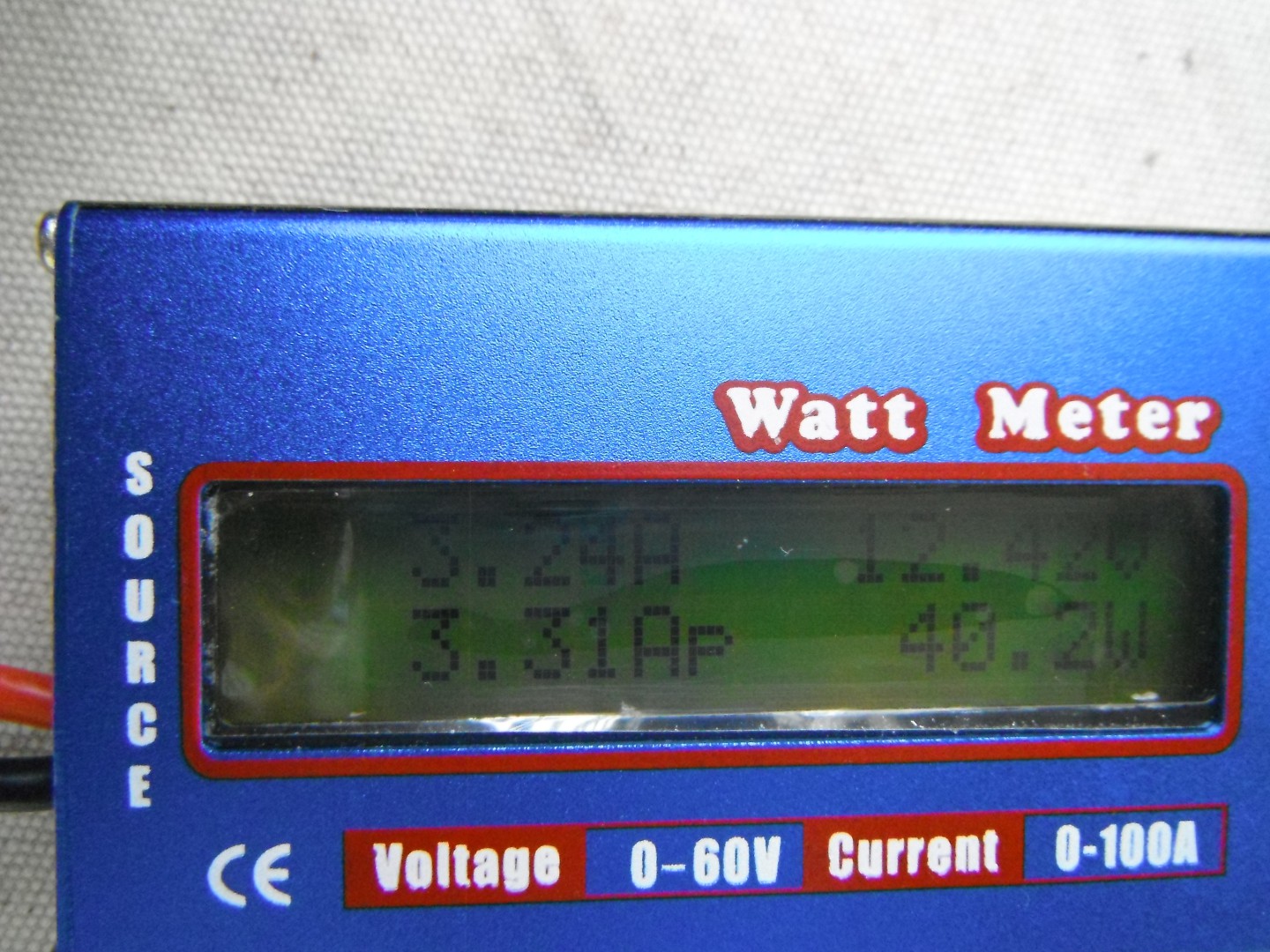

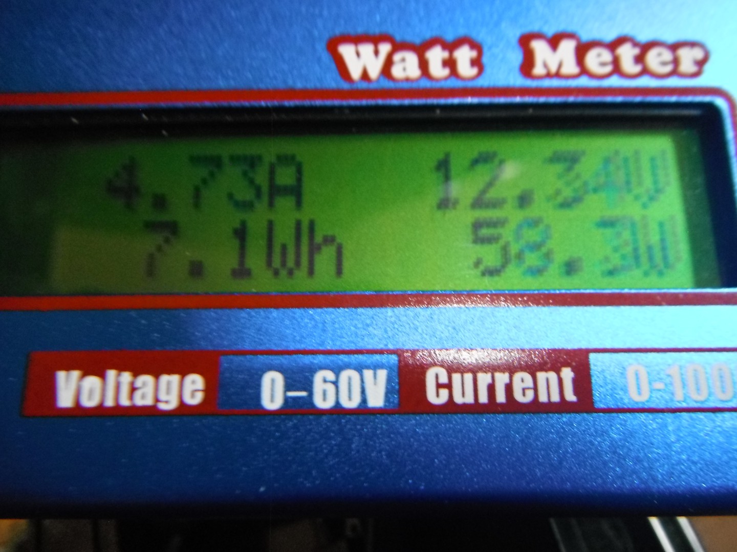

04:24 PM Nov 15, 2022
I know fridge motors do have a high start load, but there must be some electronics for a soft start on my fridge.
I have tried starting my fridge about 30 times then checking the min/max reading. My meter doesn't show any spike from the fridge motor starting.
I have tested a brief touch shorting a AA Eneloop battery. It's hard to guess how long, but let's say 0.1 second & the meter shows about 19 amps.
I have no idea how brief a spike Is on an electric motor, but I feel it's going to be at least 0.1 second to get going.
Perhaps your fridge does have some sort of soft start?
DC motors are close to a short circuit until they begin to turn and produce an opposing EMF so they will take a wadge of current for a short time at startup unless it it limited. Switch mode power supplies, which have a highly capacitive reactance, often use a thermistor to limit inrush current.
In any event you *should not* reply upon digital sampling meters to measure transient events for the reason I mentioned earlier. Someone use to sell a cheap-ish hand-held 'scope meter which only had a bandwidth of a meg two but was adequate for most hobby electronics. A few years back I bought a Chinese 250MHz DSO/meter via Ebay for about A$800 which has performed very well, I still have it in the caravan. A bit like a carpenter with his tools... I cannot bear to get rid of all mine :)
Jaahn said
06:51 PM Nov 17, 2022
Hi Just for the discussion only I did look at the peak hold on that meter and it says AC A only so that might explain the lack of readings.
"Peak hold function that can measure peak values such as starting current (AC A only)"
I was involved in measuring lots of currents and voltage in a testing lab for many years. Digital meters can hide lots of things if they are not fast. Indeed meters for general use can have averaging and zero supression to make them easier for general users. Hmm
Jaahn
This is how they manually controlled the current inrush on larger DC motors on ships and other dc setups. Starting them with resistances and then manually reducing the resistance over some steps in a short time to prevent the system being overloaded by the inrush current. The time depends on the load and the rotating inertia of the load.
Looks like they still make them in India
Hmm the ones I used in the past had no boxes covering the workings but they were 'only' 180V DC systems. I guess OHaS would not like them now.
-- Edited by Jaahn on Thursday 17th of November 2022 06:55:40 PM
-- Edited by Jaahn on Thursday 17th of November 2022 07:05:22 PM

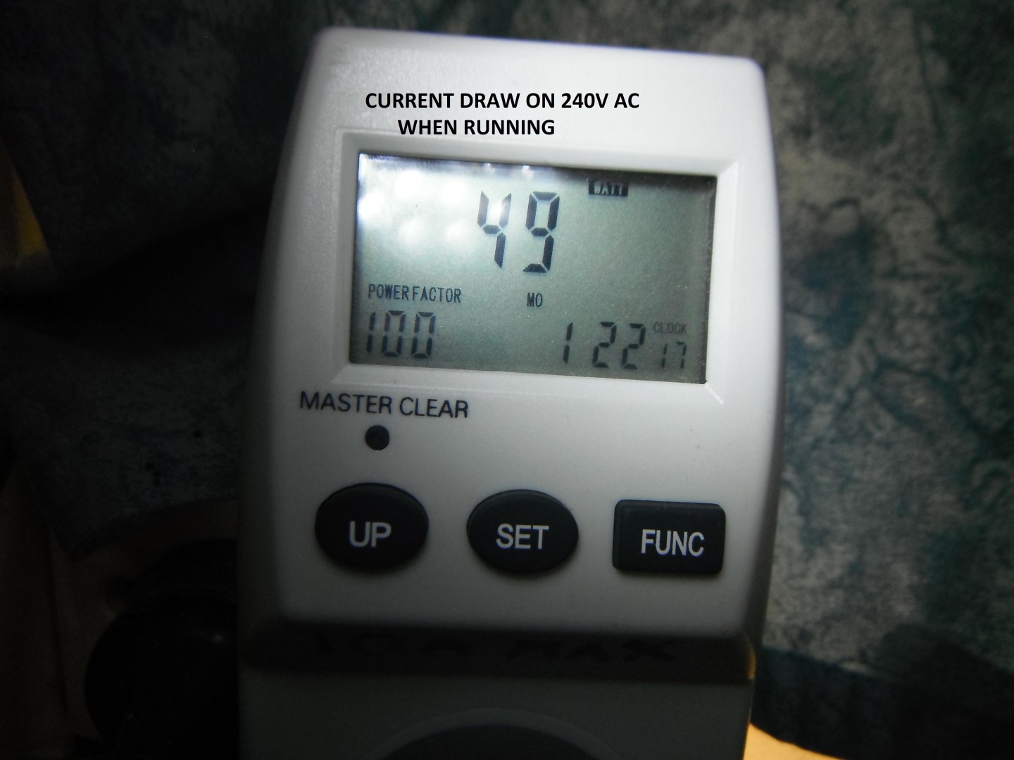

08:04 PM Nov 17, 2022
Peak is AC for the top of the cycle, I was measuring DC. I bought this meter because it could do DC amps. I have a few other multimeters.
I hadn't really noticed it before but I can hear the compressor increase in speed substantially for the first number of seconds. So it does start quite slow.
But I had noticed previously that the fridge once basically started, it is at about 2.7 amps & after about a minute settles at about 3.8 amps & the compressor going faster, using 4 x 26AH batteries, sometimes together with a trickle charger for some of my testing.
So there seems to be a lot more going on than I previously realised in this fridge when it starts.

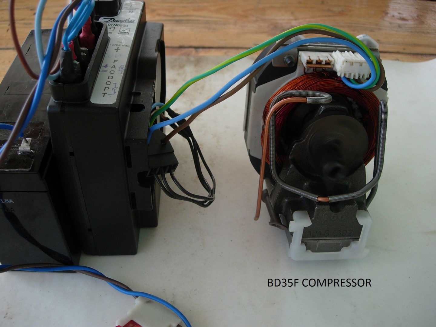

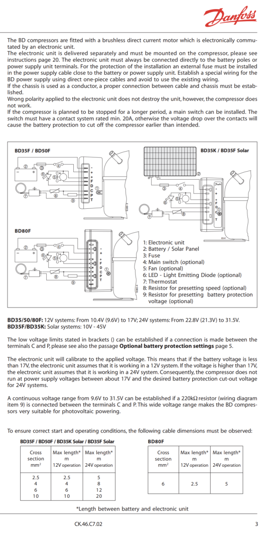

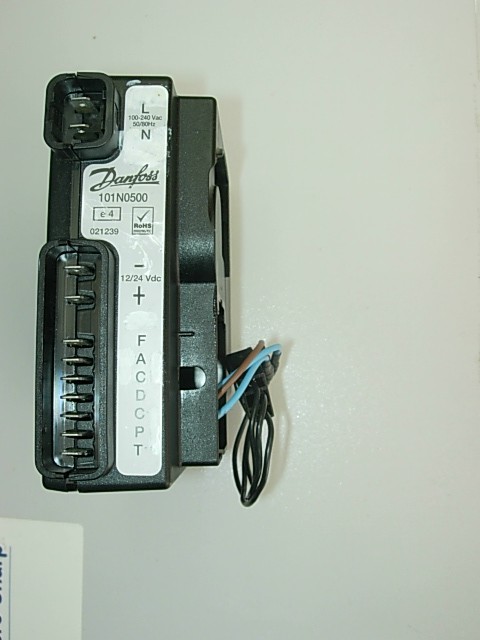

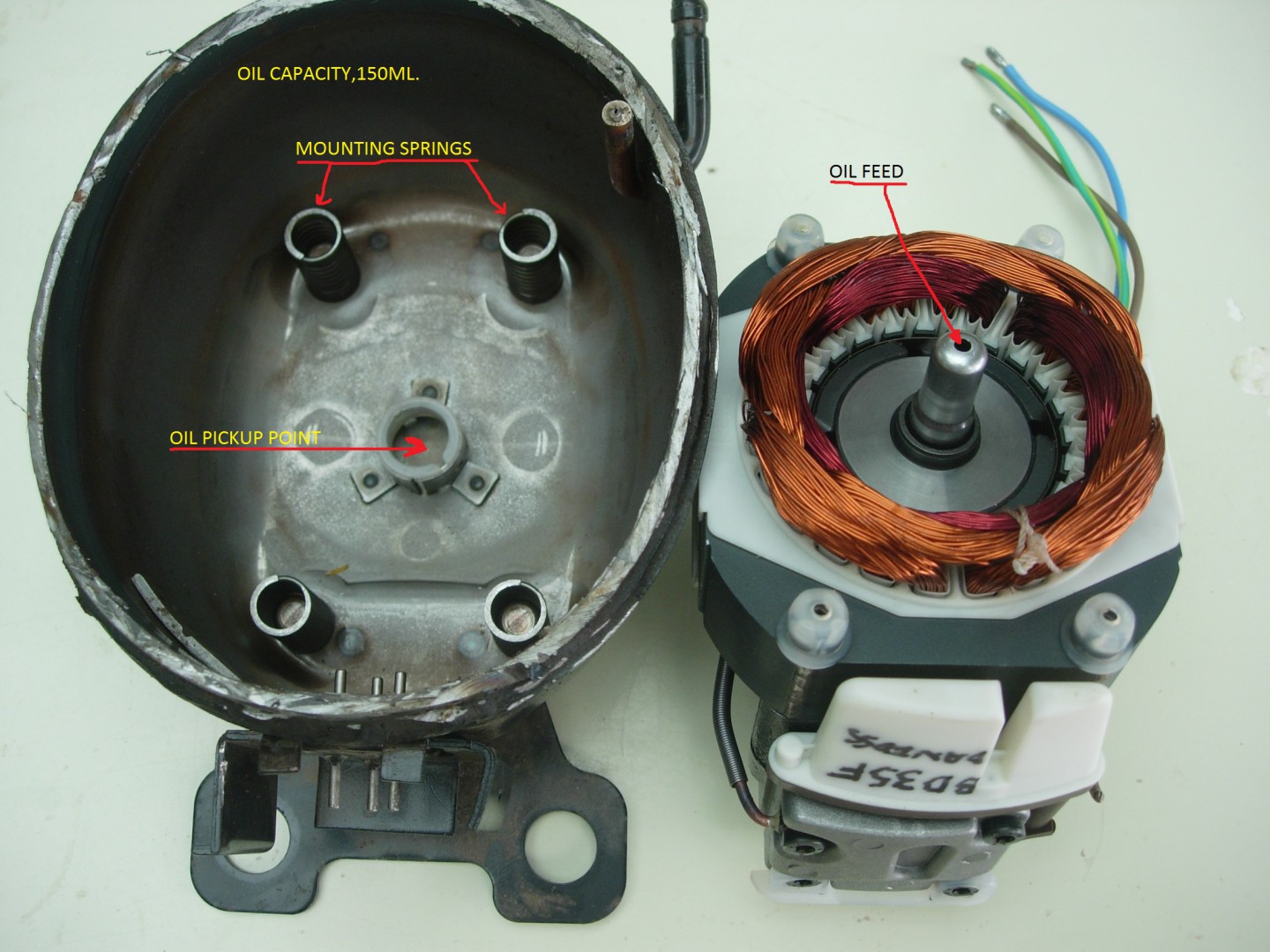

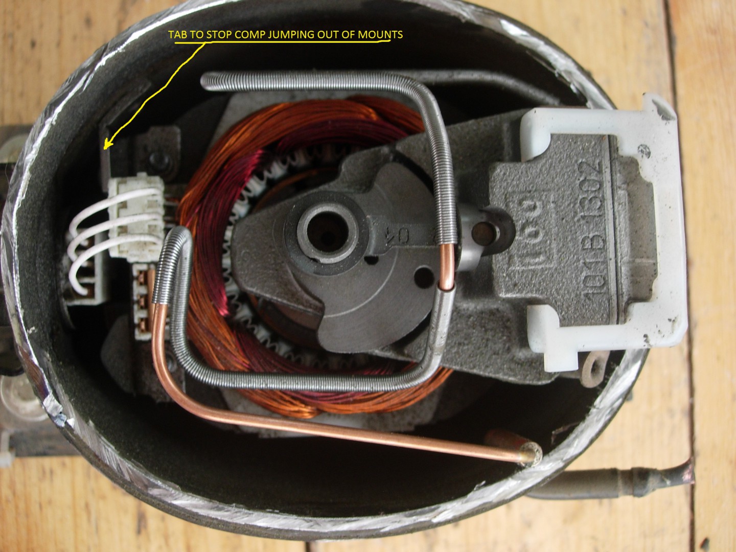

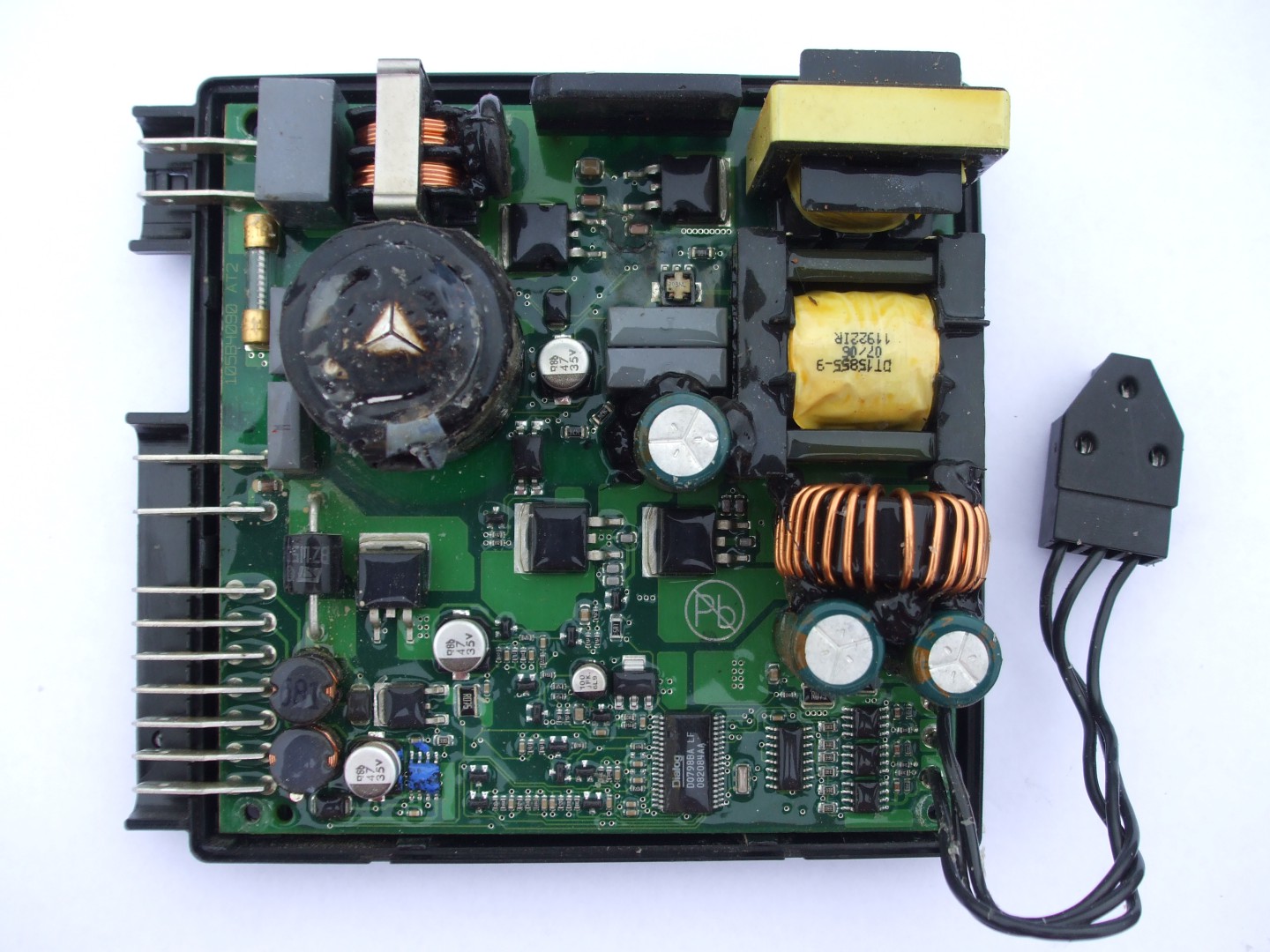

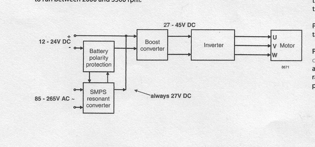

DeBe said
04:02 PM Nov 29, 2022
Waeco fridges with 12/24v DC compressors are actualy 3phase motors with a soft start. The Electronic box on the side of the compressor does the work. This is the start current for BD35F Waeco compressor 3.31A peak & run 3.24A.
-- Edited by DeBe on Tuesday 29th of November 2022 04:18:19 PM
-- Edited by DeBe on Tuesday 29th of November 2022 04:19:34 PM
If you seriously want to run a domestic fridge on 12V DC, then use an inverter fridge. This is what i run an LG fridge of 12V DC in emergencies & they are a soft start. & i use a 600W Giandel pure sine wave inverter.
-- Edited by DeBe on Tuesday 29th of November 2022 04:48:59 PM
I found this on the Danfoss compressor (text from attached image).
' The BD compressors are fitted with a brushless direct current motor which is electronically commu- tated by an electronic unit.
The electronic unit is delivered separately and must be mounted on the compressor, please see instructions page 20. The electronic unit must always be connected directly to the battery poles or power supply unit terminals. For the protection of the installation an external fuse must be installed in the power supply cable close to the battery or power supply unit. Establish a special wiring for the BD power supply using direct one-piece cables and avoid to use the existing wiring.
If the chassis is used as a conductor, a proper connection between cable and chassis must be estab- lished.
Wrong polarity applied to the electronic unit does not destroy the unit, however, the compressor does not work.
If the compressor is planned to be stopped for a longer period, a main switch can be installed. The switch must have a contact system rated min. 20A, otherwise the voltage drop over the contacts will cause the battery protection to cut off the compressor earlier than intended. '
The compressor is actualy 3 phase star winding. This is one i cut open because it would not run. The center termination of the star winding was open circuit. Once fixed the compressor would run, i now use it to test the controler modules.

DeBe said
06:57 PM Dec 1, 2022
It will posibly run in reverse, but probably not wise as the oil is picked up by to bottom of the hollow crank shaft. Which probably has a spiral inside to draw oil up & out the top to lubricate the conrod & piston.
So it will run in reverse if you swap 2 phases.
Probably true. But what is the point as most reciprocating piston compressors just pump the same running either way. It will not suck the gas out of the wrong port
Possibly the lubrication may be affected though.
