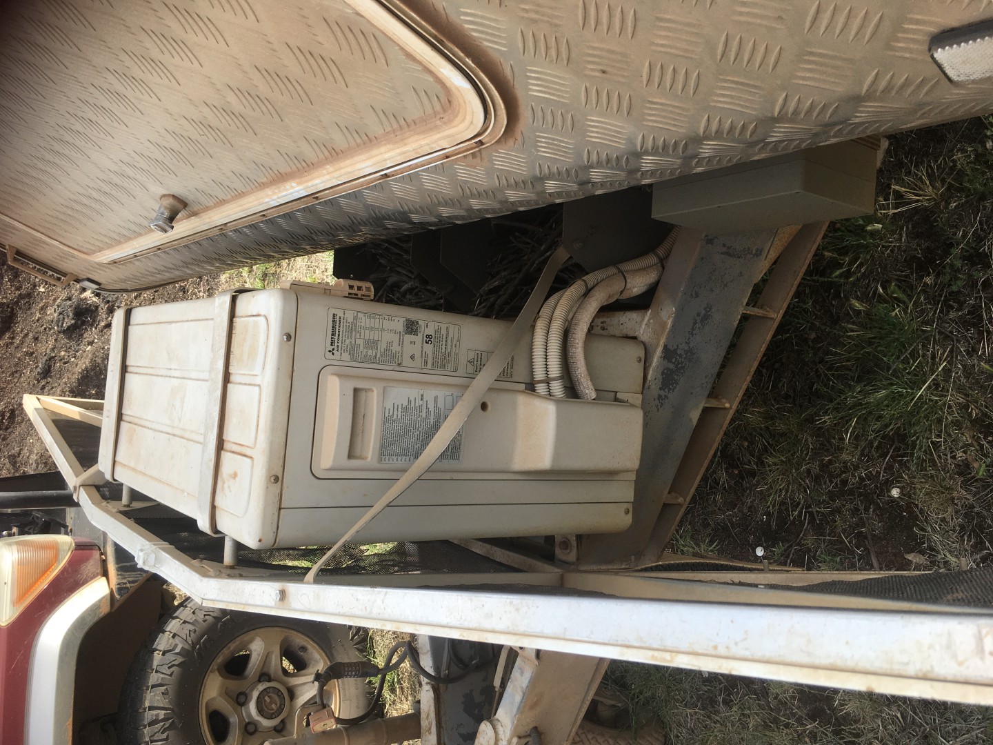

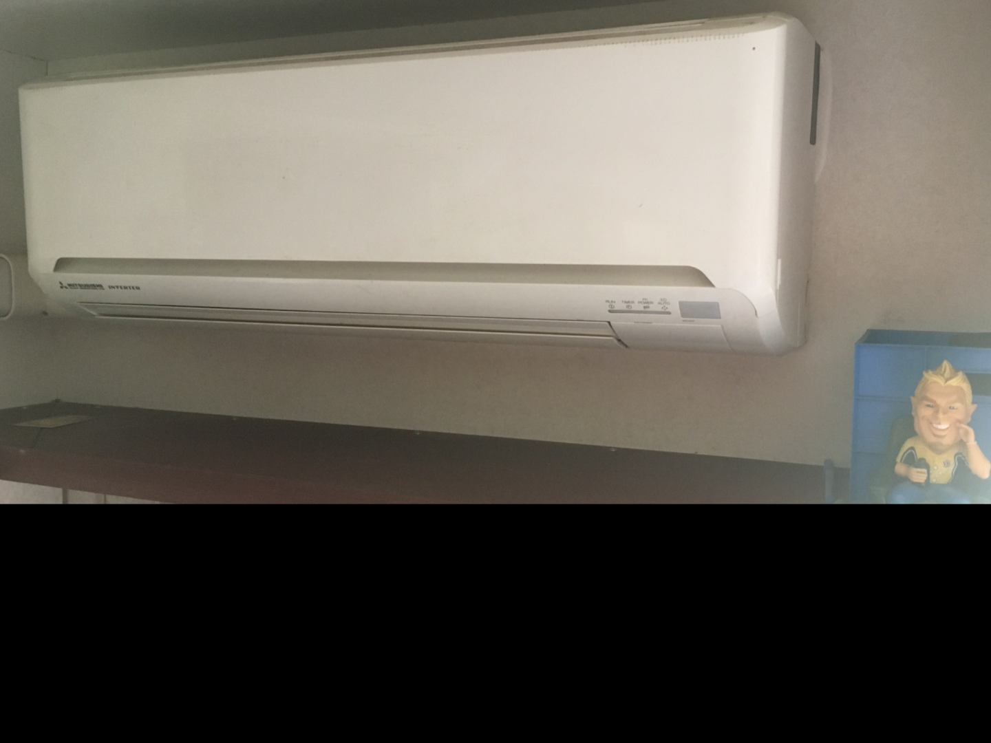

My 2.5kw Mitsubishi Heavy Industries system has the outside unit mounted on the drawbar of the van, with the cassette unit mounted on an interior wall. Works brilliantly, and has not given any trouble despite many thousands of kilometres on bush roads, including Dawson Development Road and Suttor Development Road. Also did the road from Dundas to Lake King, with holes in the road literally 600mm deep and no other traffic for over 200kms. Mitsubishi are very energy efficient, mine running 24/7 off batteries. Cheers
I think you are correct regarding roof mounted units on older vans. Depending on the size of the van and unit, which can weigh up to 30 kgs, roofs can become concave even with extra bracing fitted and with water not draining off the roof leakage can occur. My son has his unit mounted in a cabinet on a bench top in his van. It runs reasonably quiet but does take up space. Yobaar's setup is good but requires space on the drawbar and a professional insallation in running wiring and pipework. It would also be prone to dust ingress on the external unit so regular maintenance would be required. A unit under the bed could vibrate causing discomfort to the occupant and be noisy. Whatever you do will be a compromise.

The 2.5kW split system are about the most efficient air conditioner. The are also very quiet. The Daikin (& probably the same for Mitsubishi) kW of cooling range from 0.9 to 3.7kW. If you have plenty of battery resources. Stick it on maximum for 10 minutes then wind in back.
The other thing they are really good at is dehumidifying run on of a low speed setting. You may find this is enough for most situations saving even more energy if you are a touch light on batteries.
While on the road you could put a cover over it to protect it from dust & stones. It is a good idea to hose the condenser out occasionally. They are built for out doors!
Disclaimer, I have a 2.5 & 5.0kW Daikin

Great advice Jonathan. After making enquiries with "experts" I was told not to worry about dust, but to hose the condensor occasionally. The stone guard that is in front of the AC unit was actually an afterthought, and is mounted on top of the bar that I fitted to hang mudflaps from, in an effort to stop stones going under the van and smashing all the plumbing for the 6 water tanks I have. Works well, after a few teething problems with my design. Cheers
