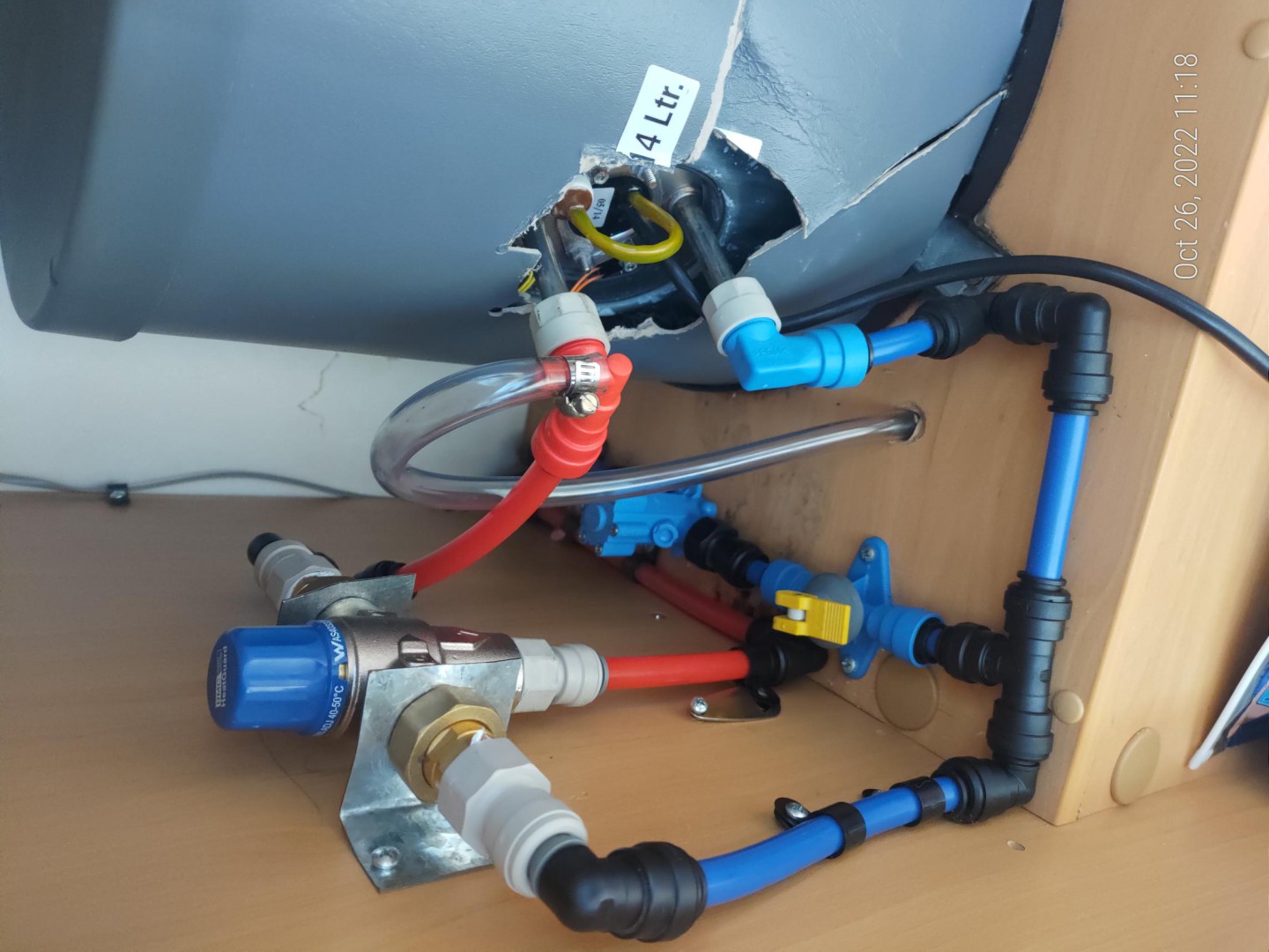

Unfamiliar with your set up - can you put some food dye in system to see if it is going into tank or bypassing it - use pressure relief to see if coloured water gets into heater tank.

What is the clear pipe feeding, having hot (untempered) water through that would panic me
What ever its feeding does hot water come out of it . If not plumbing problem upline, if hot water flows boiler and plumbing ok
I would remove the tempering valve (temporarily ( or permanent if no small kids)) failing that just follow the pipes and keep disconnecting and reconnect as best you can
Regards Gerry
NB once all sort consider changing that clear pipe for reinforced pipe

On looking at the picture it would appear that the clear tube is the inlet from the mains . please check where this clear pipe is coming from. if so it is plumbed incorrectly.
If it is the inlet from the mains. The clear tube should go to the blue pipe which is the outlet from the pump into the heater and tempering valve The red pipe is the hot water out from the heater. If cold water is introduced via the clear tube eg mains .You will only get cold water as this bypasses the heater when switched to mains. When switched to pump you will get hot water as this clear tube is off line . Hope you can understand .
Gary
Bobdown said
04:17 PM Oct 26, 2022
Triggy wrote:
On looking at the picture it would appear that the clear tube is the inlet from the mains . please check where this clear pipe is coming from. if so it is plumbed incorrectly. If it is the inlet from the mains. The clear tube should go to the blue pipe which is the outlet from the pump into the heater and tempering valve The red pipe is the hot water out from the heater. If cold water is introduced via the clear tube eg mains .You will only get cold water as this bypasses the heater when switched to mains. When switched to pump you will get hot water as this clear tube is off line . Hope you can understand .
Gary
The clear pipe looks to me as some sort of overflow from the hot water coming from the boiler, is that red device some sort of relief valve and the clear tube probably goes outside the vehicle.
Should be a junction of two blue pipes feeding one for the cold inlet, I can see the blue pipe feeding the boiler and the tempering valve. Need to look further back along the line Fraser.
Cheers Bob

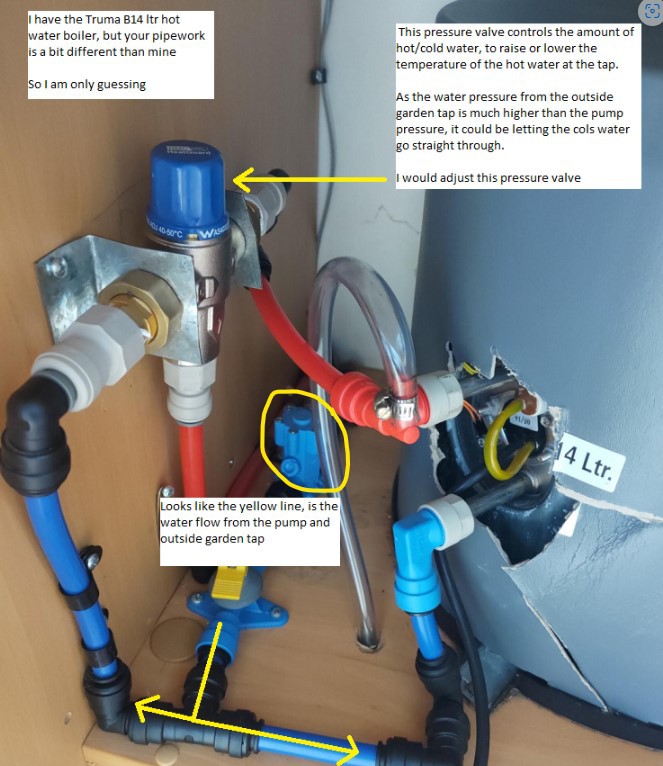

Tony Bev said
04:49 PM Oct 26, 2022
Welcome to the forum, fraserp
I have the same boiler, but slightly different pipework
Unfortunately I can not take a pic of mine, without dismantling the bed
It appears to me that as the outside water line, produces much more pressure than the pump The cold water may be going straight through your pressure/temperature valve
Don't worry about the clear hose, mine is the same and my boiler was made in 2006, or thereabouts
I would be trying to adjust the pressure/temperature valve If that does not work, then I would be using the pump only, until a plumber could check the system out
Hope that this pic of your pic, can explain it a bit better
Let us all know the final outcome, as it may help others in the future

In the manual, the clear pipe appears to be "Breather valve with clear tube".
fraserp said
05:55 PM Oct 26, 2022
Thanks Tony...... excellent markups on the photo :)
Texted the previous owner again and he advised the tempering value is brand new. Spoke to RMO Heatguard and they thought if it was working on pump then it should be OK and it is likely to be a pressure problem elsewhere (?). I'm also not sure how it adjusts as the top just seems to spin around. I will google instructions for it.
So, it could be the inline "pressure reducer" which I have shown in attached photo as circled in yellow.
For an installation like this, is a regular plumber recommended or do I need to book into a RV service place?
Any agile plumber would be able to sort it I imagine - I say agile as there isn't much room to work in.
Although I believe a little sleuthing on your part will find a valve or tap somewhere that is the cause of lack of flow on mains.
