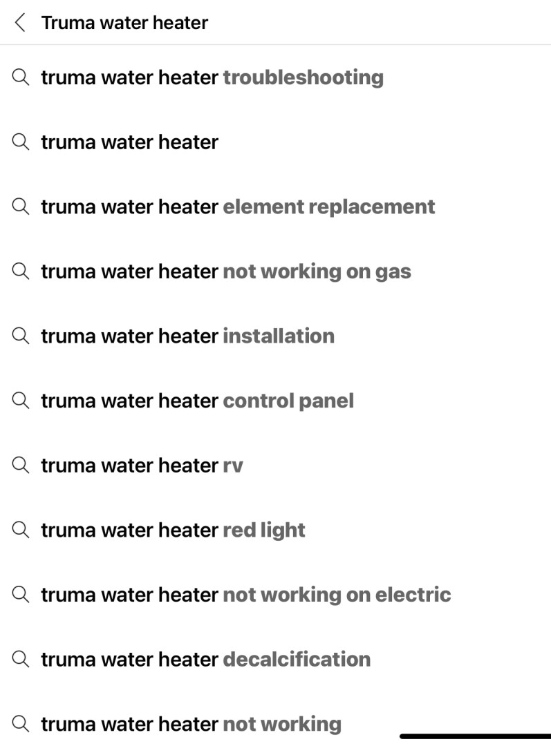

Try doing a search on UTube.
I put Truma into their search magnifying glass and this came up.
