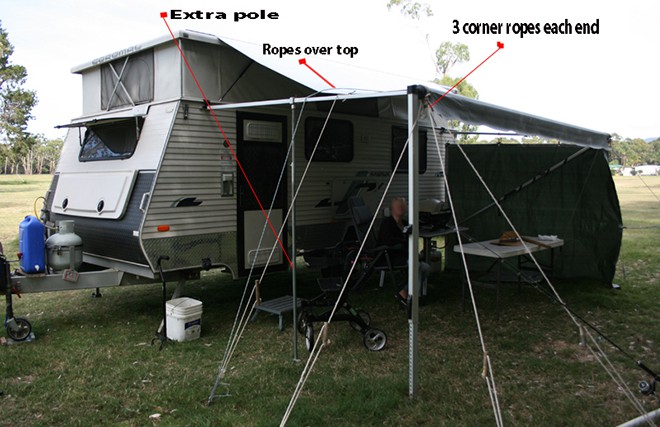

The awning on a pop top is to hard to stop flapping unless you go to extreme measures as provided in the photo by PT.
If I was mad enough to buy a poptop I would have the top arm of the awning attached to the roof of the van and use an AFK, in the pic supplied by PT, I would have a detachable pole located where the top arm is now, and an additional 4 or 6 support legs between the roof and top of van.

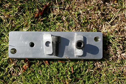

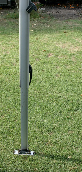

If we are staying a while we peg the awning leg down,I made an aluminum plate to go under the foot.
I set everything up then slip the footplate under the awning leg,hammer the pegs into the footplate,less chance of miss hitting and damaging the plastic foot.
Then I finger tighten two screws in the awning leg to the footplate.If a storm comes I can undo the screws pack up the awning,when the storm is over just place the awning leg on the footplate and finger tighten the leg down.
