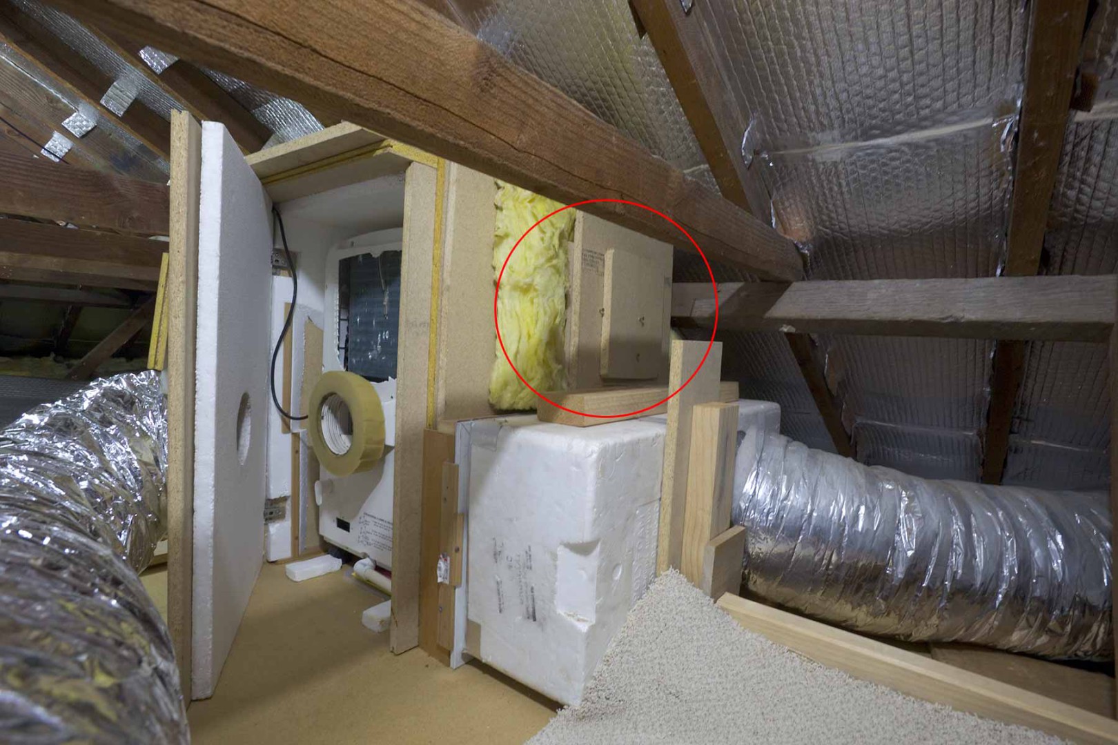

I have adapted a portable Dimplex reverse cycle air conditioner for our Unit as we have no where to install a split system around our block of units, on the external side it is so quiet I can run it after 10pm as it is so quiet no one would know it is running. It's been a two decade project, works really well for its 3.5kW capacity. But it has been a challenge reducing noise internally, but I have got it down to a reasonable level.
I have used acoustic batts, acoustic foam, mass loaded vinyl, vibration isolation. The original Dimplex air conditioner was extremely noisy sitting in a room. But I am reasonably happy with the end result installed in the roof space. Actually bought a second hand AC as our first one died from old age. I know the feeling!
If you put in the effort you can turn a crap caravan or home system into something half reasonable.
(I have done more upgrades since this photo)
These blocks I added each side of the roof space AC enclosure made from particle board flooring solved a low frequency resonance problem in our kitchen as a result of a reflected noise of the external wall of our Unit. An acoustic nodal point. Very low tech, but it did the trick.
Inside the styrene foam box is an air filter for the condenser side of the air conditioner, easier than cleaning the AC condenser as I can wash the filter under the shower. I also have an additional 70 watt inline duct fan to increase air pressure to the air conditioner. I can't really measure if this extra 70 watts helps the AC enough to be worthwhile, but my gut feel is that it is worthwhile.
If one puts in a bit of effort you can improve all crap products.
