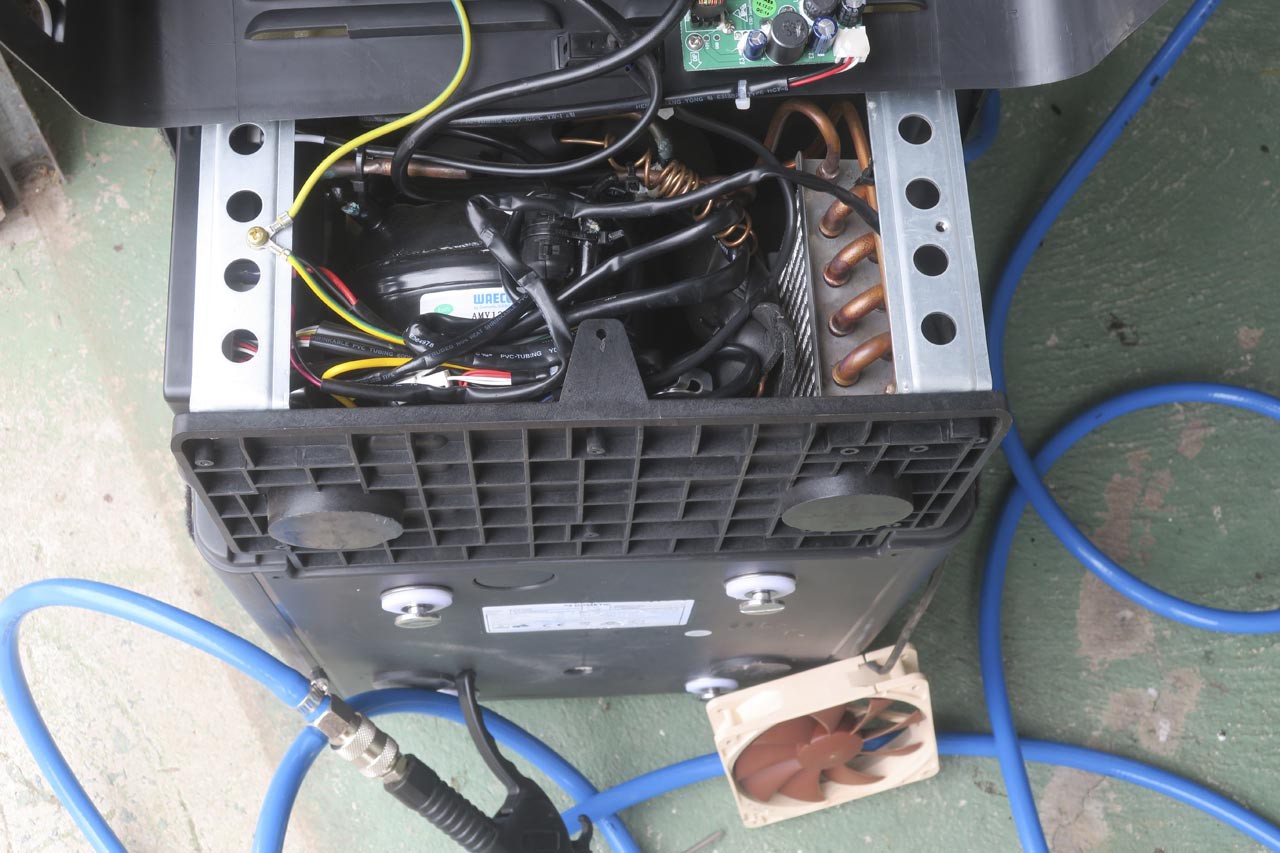

I pull my 28L fridge apart to blow out the dust with air compressor after each trip.

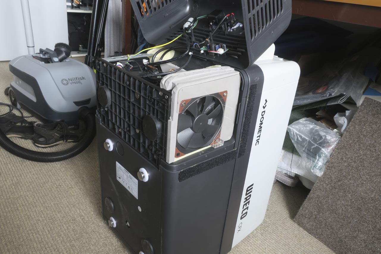

I installed an industrial 120mm fan in our fridge replacing the original 92mm standard fan. Also an air filter which reduces the amount of dust build up on the condenser, but I still clean inside the fridge after each trip.

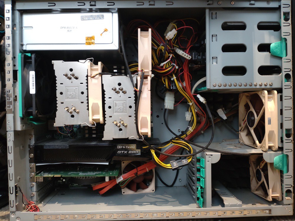

Apart from on condenser fins. Dust always builds up on the back side of fans whether on the condenser/heatsink or as a separate fan. This one is 1 of 8 fans in one of my computers. Embarrassing stuff!

When working in a bedroom with half a dozen computers render 3d images 24/7 for weeks on end in summer & opening windows doesn't really help even with a large fan through the window & air conditioning doesn't make a lot of difference.
The computers didn't over heat in an ambient temperature of about 40°C. My 3.0kVA UPS was showing about 2500 watts being used. Heat added to the room.
The other issue is noise having a lot of fans running a bit slower is a lot quieter than high speed fans.

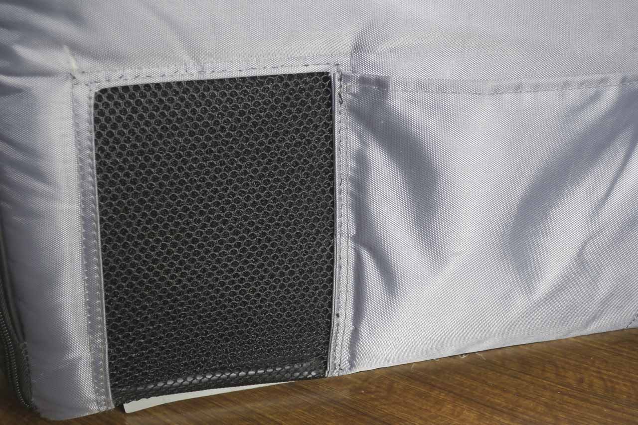

Cleaning the back of the fridge is a regular task which you need to do like a spring clean at the very least.
Compressor air gun & a vacuum work really well as a team.
