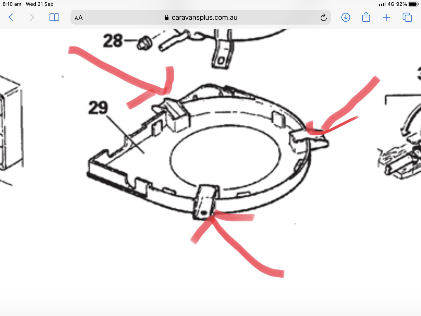

Hi Bas. Quick chat with Mr Google shows that unit is bolted to floor through 3 brackets spaced around perimeter. Good luck. Cheers

I welded extensions ( approx. 150mm ) on to the 3 screws .... lets me see them to undo them . Also added "plug and socket" to the wiring (simplifies disconnection) Got rid of the card board "insulation" . Made bottom of wardrobe removable to aid access . Now all good . Element price is a rip off due to "kink" in its shape - normal household straight one is only quarter to a third of the price.

If you are lucky enough to find someone, who has already changed the element in your type of RV, it may be easier than it looks
I am lucky that I can actually see the top of my Truma B14, as it is situated in the rear passenger corner, under my bed
Although very awkward, I managed to change my electric element in situ
I then had an electrician fit a GPO Power Point, as the new element came with a plug attached
Looking from the top, my element was situated at about the 8 o'clock position from the outside wall

Hi Bas + Eve
Hopefully the sketch below, will show what I mean
