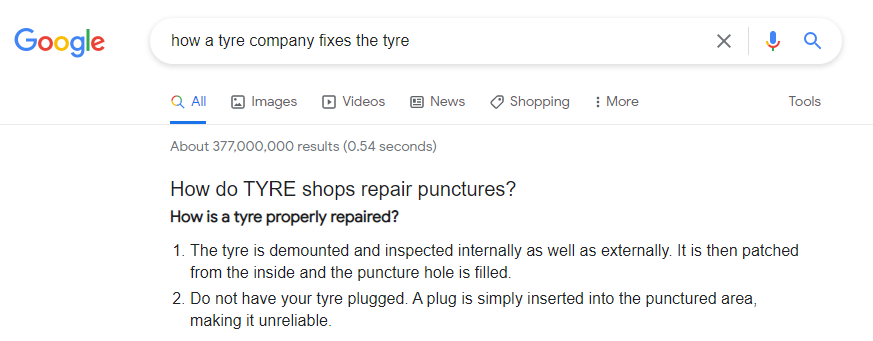

KevinJ said
02:36 PM Sep 16, 2022
The attached is also how I saw them repair one of mine:
-- Edited by KevinJ on Friday 16th of September 2022 02:38:23 PM
Most of my punctures have been due to screws. Even in remote areas.
Once I had a rock snap off inside a tyre.
I plugged someone's tyre in a remote area with 4 plugs. They didn't have much option as their only spare was in worse shape. They just had to drive very slowly back to civilization.
