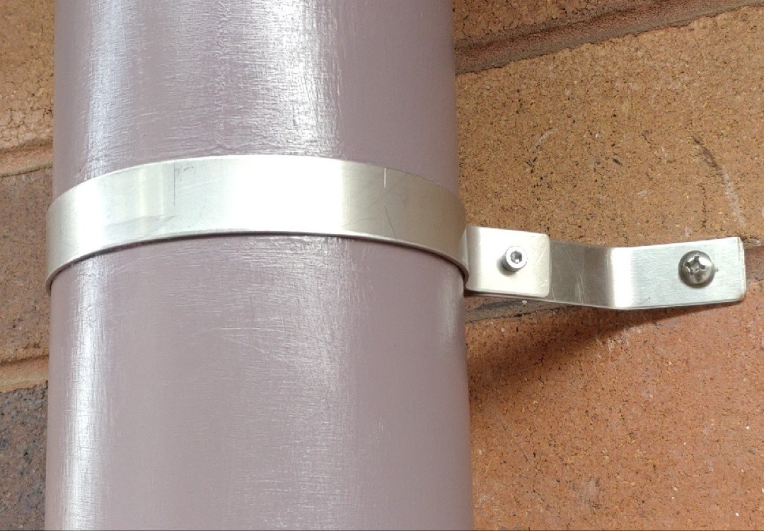

When one live at the ocean & on it at times, avoiding rust in number one priority.
I replaced the drain straps with 316 stainless strips & screws, I got cut up & bent over the table edge, as the rubbish bought from large hardware stores rusts within a month.
